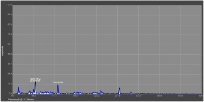

All settings still at default. MKS DS95i on 6v with rudder delay at 5 and both tail endpoints around 115. Servo horn length is 13mm, originally tried 10mm but endpoints were up near 170. Linkage is smooth with no binding. 360mm mains, 68mm tails on 6s, 2800rpm, gov turned off. Vibes look fine. Adjusting gain in Tx changes the speed of the oscillation but does not get rid of it.
Any ideas? Is my tail servo suspect???
Vibe screen cap and settings file attached...

first from all I recommend to increase piro consistency for Gaui to approx 170, then you can decrease your gyro gain until oscillations will disappear.
If your Gyro Gain will be too low (normally it is around 60%) then you can put ball linkage back to 10mm.
Also decreasing Rudder Delay to 0-2 may help you.
