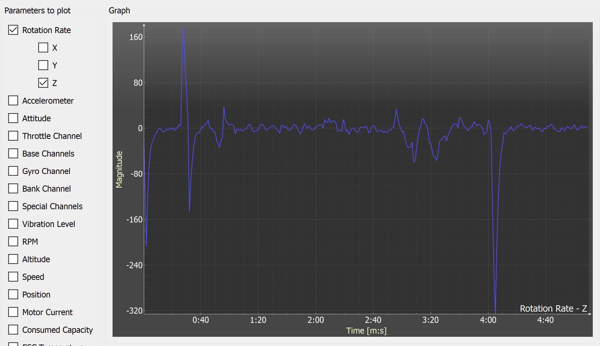

i have a raw420, it's my biggest heli yet. after a lot of sim i want to start doing inverting flying, when i use elevator to invert i find it slow and i want to make sure my settings are ok. I have 12,5 degree of pitch and have about the same on cyclic.
To make sure it's ok to flip on the front to back i try at a high altitude but it seems slow versus simming in Heli-x...
Here is a graph from the flight viewer with only the rotation rate on the screen, is this rate a normal fast enough rate ? the cyclic sensor settings are at 11 and general flight style are at 6 and i added the config file
Thanks !
Rotation rate ?

With the diagramm I can't do anything with it because I don't see any associated units, such as "°/sec", that makes it impossible to say somthing about it - i see rotation in X but no units -
click into the graph, then you will see the associated unit, that helps - you will see it in the windows listed below in the margin - Save the log on you computer (advanced flightlog) and upload the file here too (.4dr) -

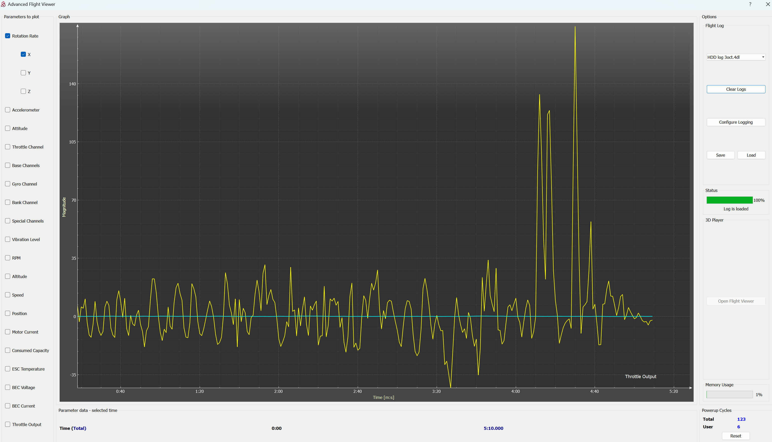

this is the file from which i took the snapshot, you need to reaname the file, *********** @Thomas ************ the site does not accept .4dr files in the upload window, you should at the extension to the upload extenstion configuration.
I have another flight i need to get from the unit that has more then a few 360 elevator spins.... that i will upload later.

PS. In the appendix I have loaded your FlightLog from the Z-Axis, but there are no units shown as "°/sec" ,maybe its really "°/sec" but not shown -
