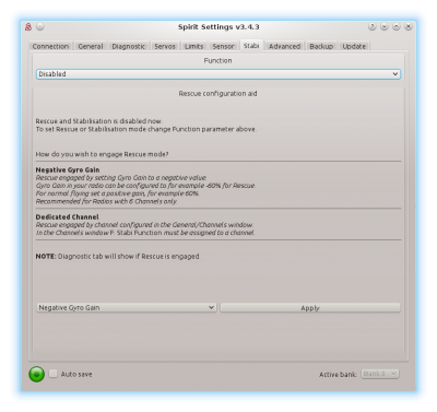

If i move my temporary switch to toggle rescue (assigned to activate bank 2), something happens, which i dont understand.

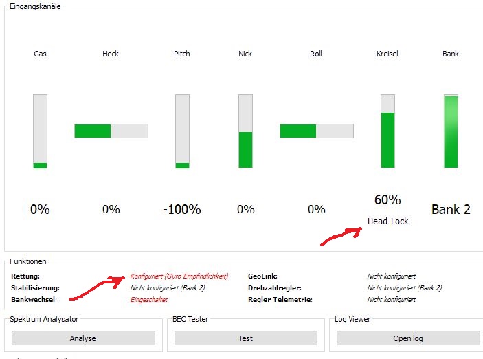

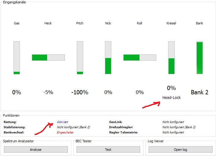

Normally the servos jump, if i toggle rescue in my normal flight mode (bank 1), but if the gyro settings are over 0% (Heading Hold)the rescue function doesnt work anymore. The diagnostic tabs shows then configuration (gyro sensivity) ?!? Please see pictures. If the gyro setting is 0% the diagnosis tab shows "activated" in blue.
Im not using negative gyro, this is assigned to a channel. My stabi mode ist also triggered in the diagnosis tab, also assigned to a channel.

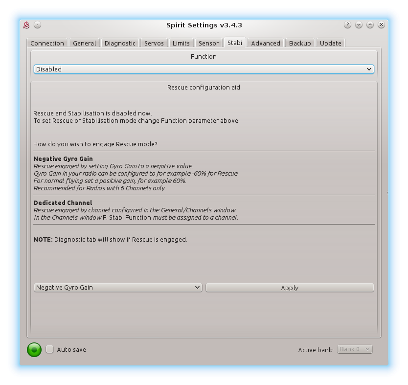

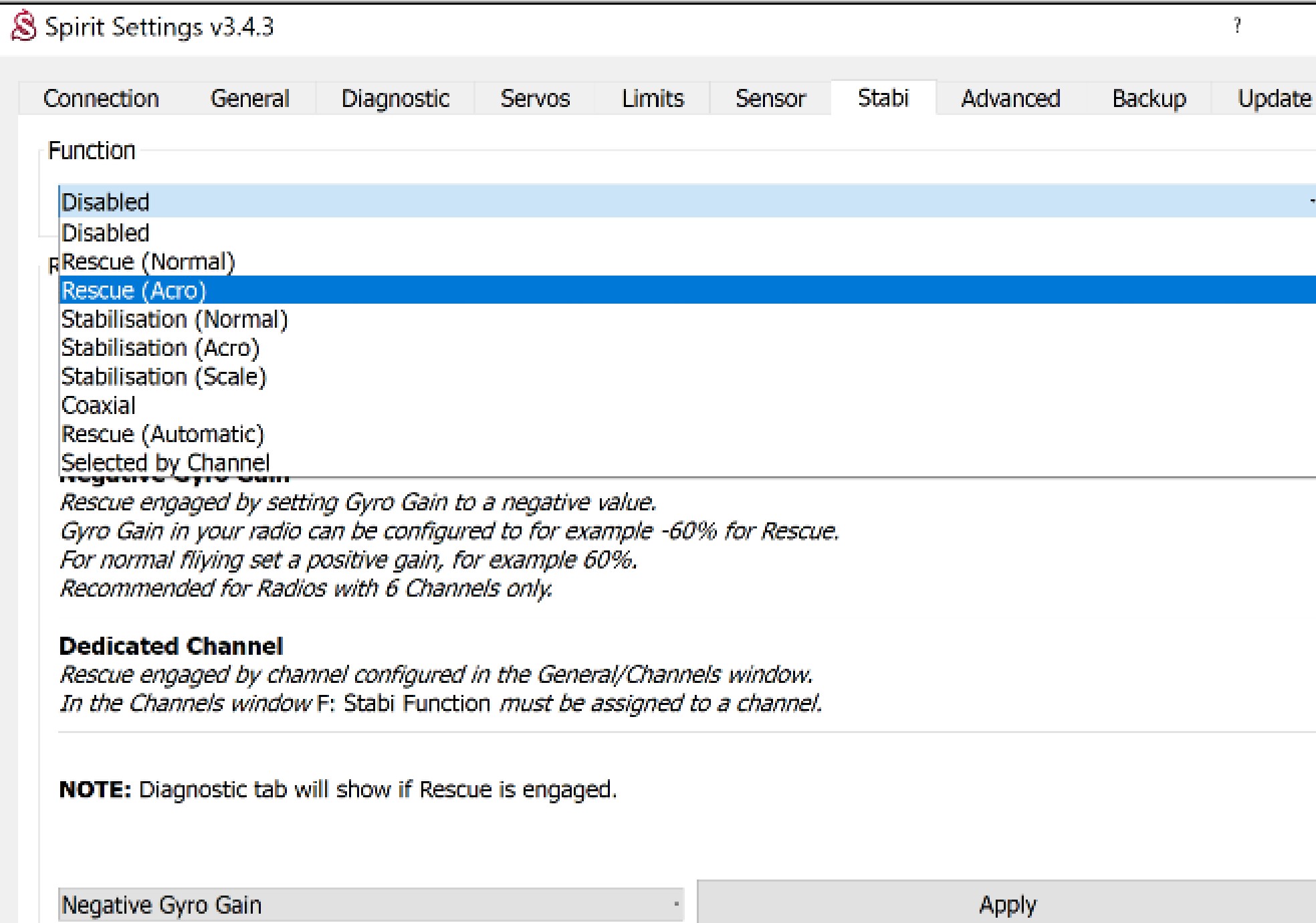

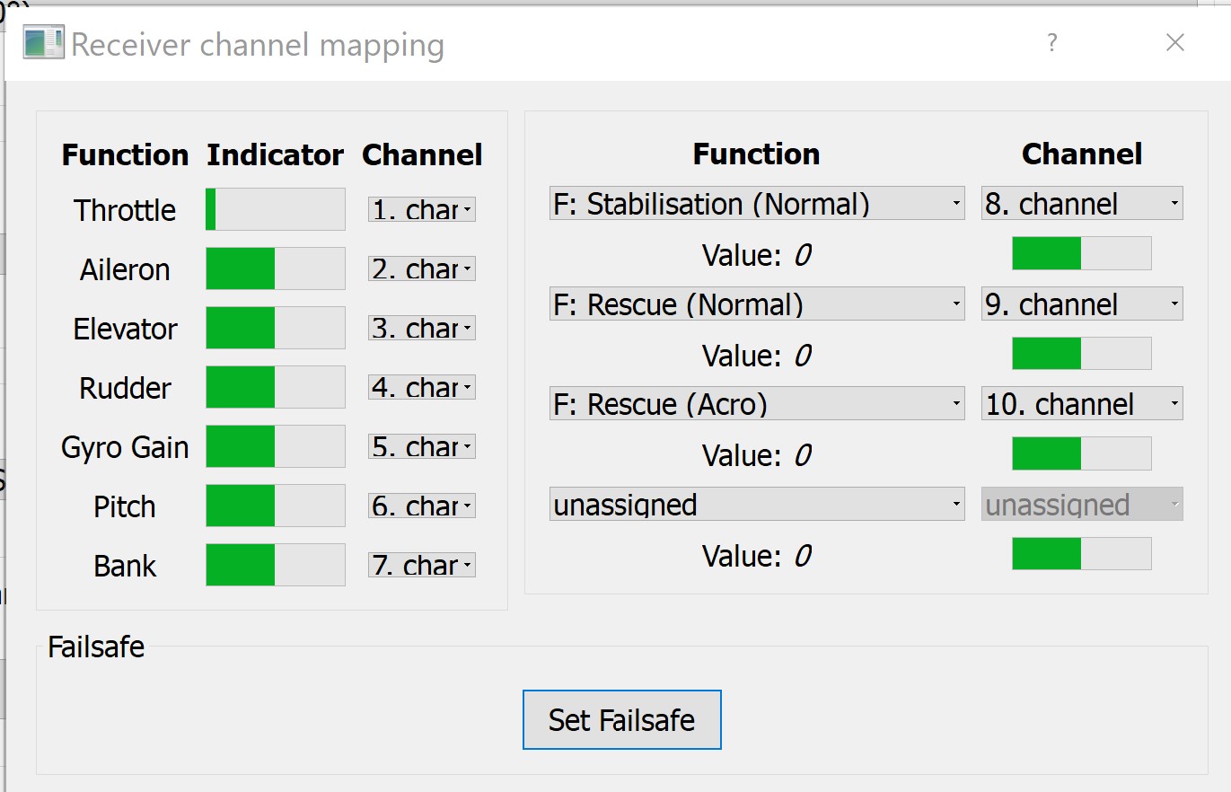

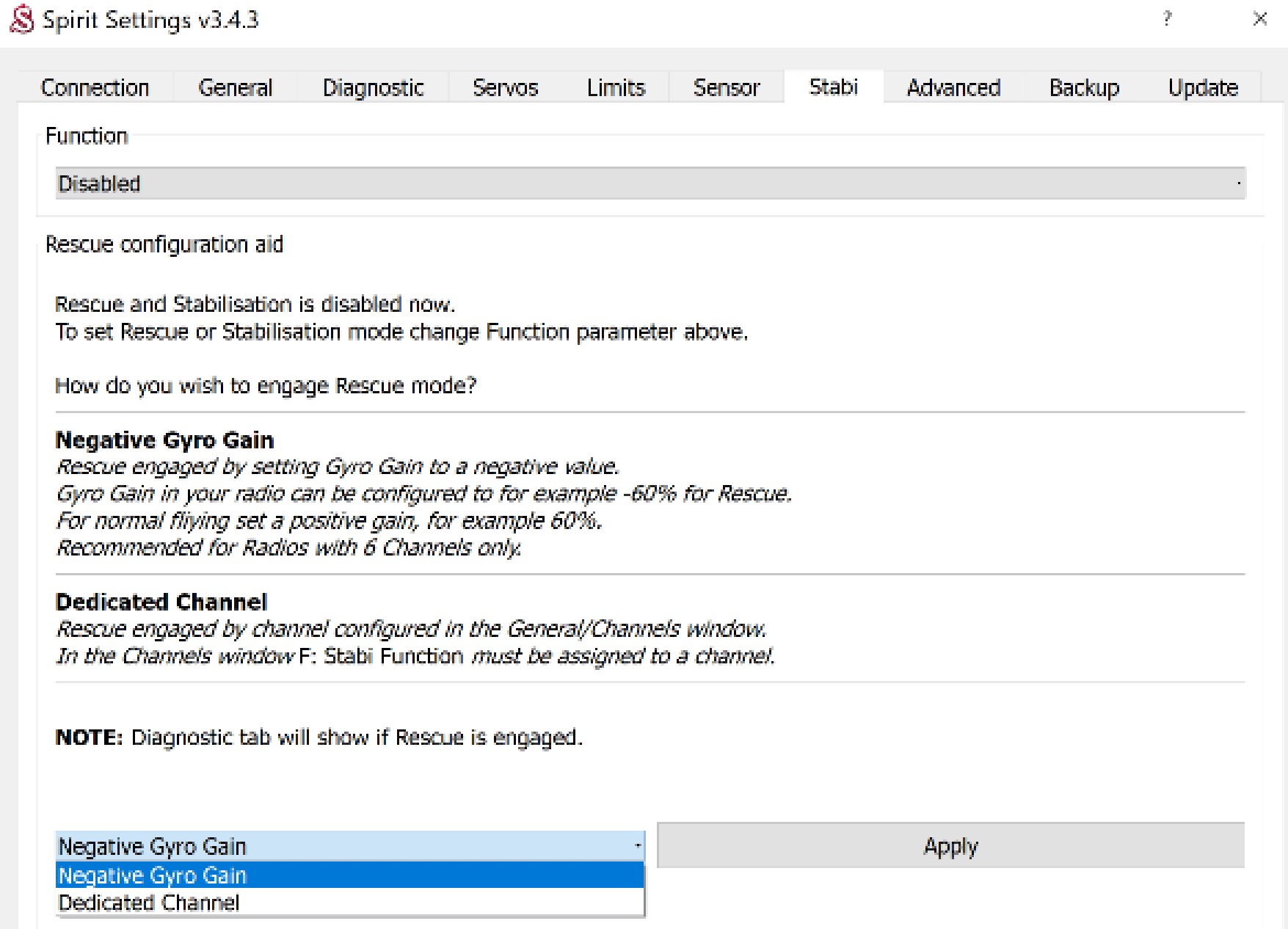

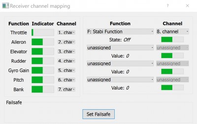

the question is how you will activate rescue, there are three possibilities first negative gyro gain - If you have for example 55 % you are in heading hold mode, if you set then -55% you will get "rescue" if you have choosed negative gyro gain for "rescue" and a bank - rescue stands here for all possibilities (stablisation, rescue, rescue acro and so on) - the other possybility is to activate it by a dedicated channel and additional use of the benches with different settings -
The third possibility is independent on Banks and you can choose all sorts of"rescue" with different
channels for each function - good described in the manual:
https://manual.spirit-system.com/index. ... #STABI_TAB
look at it carefully and in detail, you can also play through it in demo mode in spirit settings to see which settings are possible -
Matthias

Dear Matthias,
thanks a lot for your explanation and your efforts!!
My channel settings are exakt the same as in your picture shown.
I have 3 banks over a 3 position switch accessable, first is stable normal, second is disabled (for normal flying) and the third bank is rescue normal.
I have "dedicated" to channel" selected in bank 2.
My momentary switch on the taranis "SH" is programmed to overwrite my bank select channel to 100%. So if i toggle my momentary switch automatically bank 3 is active and so the rescue function.
And then the problem occurs....
My Gyro Switch (2 position) for the gyro channel is set to 0 = 60 / 1= - 60%.
With this setting, im not able to activate rescue. If im in the bank tab, switching on the pc software performs without problems (bank screen switches all 3 positions) , but the rescue is in real at the heli not there. It is just in normal fly mode if i toggle the momentary switch.
Is it possible that my setting in bank 2 "dedicated to channel" is wrong. I saw something interesting: Sometimes if i toggle the momentary switch the setting "dedicated to channel" switched to negative gyro gain, although i stored the settings for sure.

Posts: 637
Hello Mario,
I think the problem is that you choose hegative gyro gain and selected by channel, this doesn't work ! Choose only one method, for example with a dedicated channel or only with a negative gyro value, then it will work! Don't use both methods at same time -
Matthias
