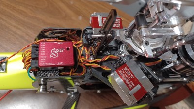

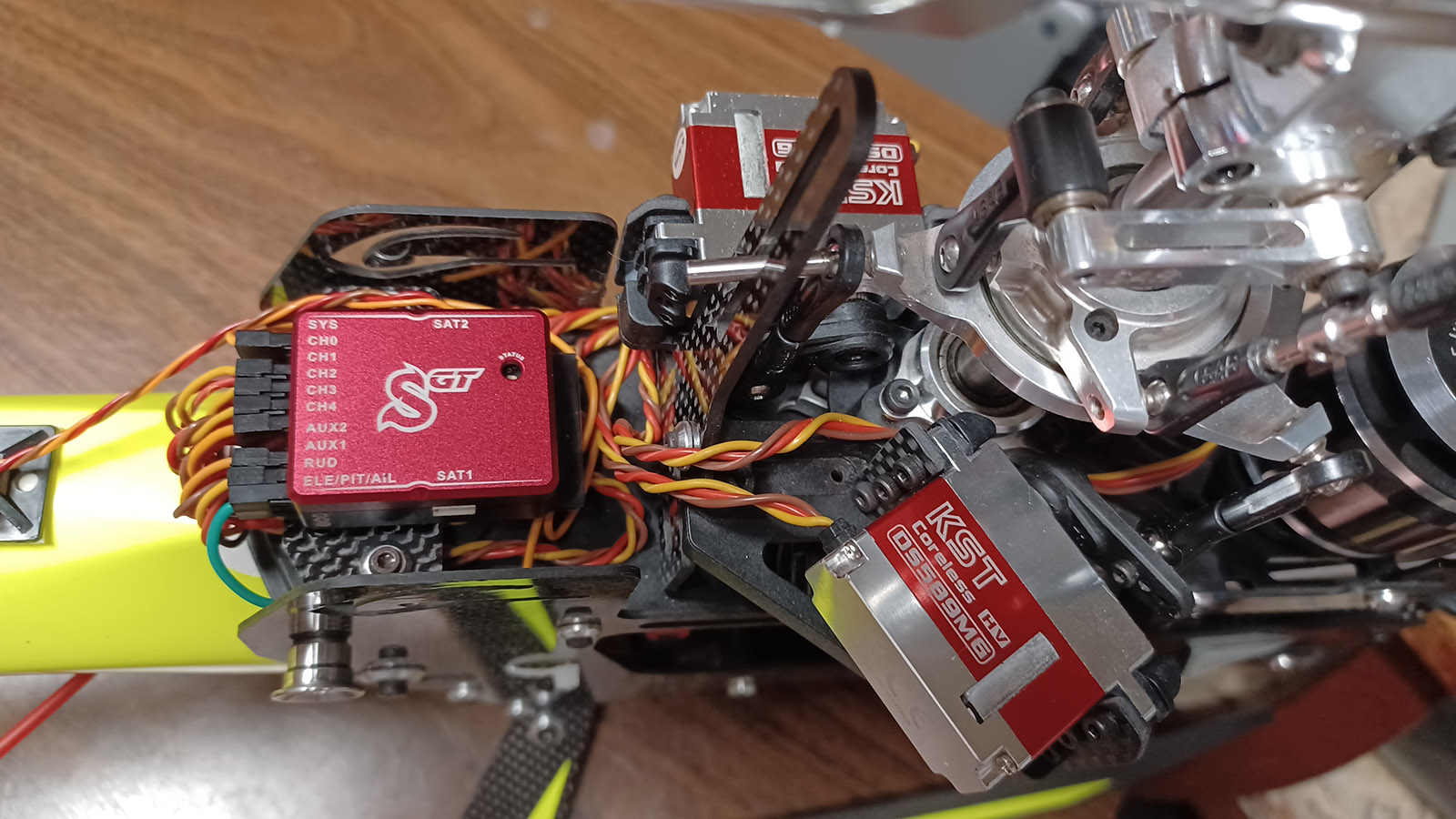

Can you also share photo of the unit installed on the model so I can verify mounting position with configuration?

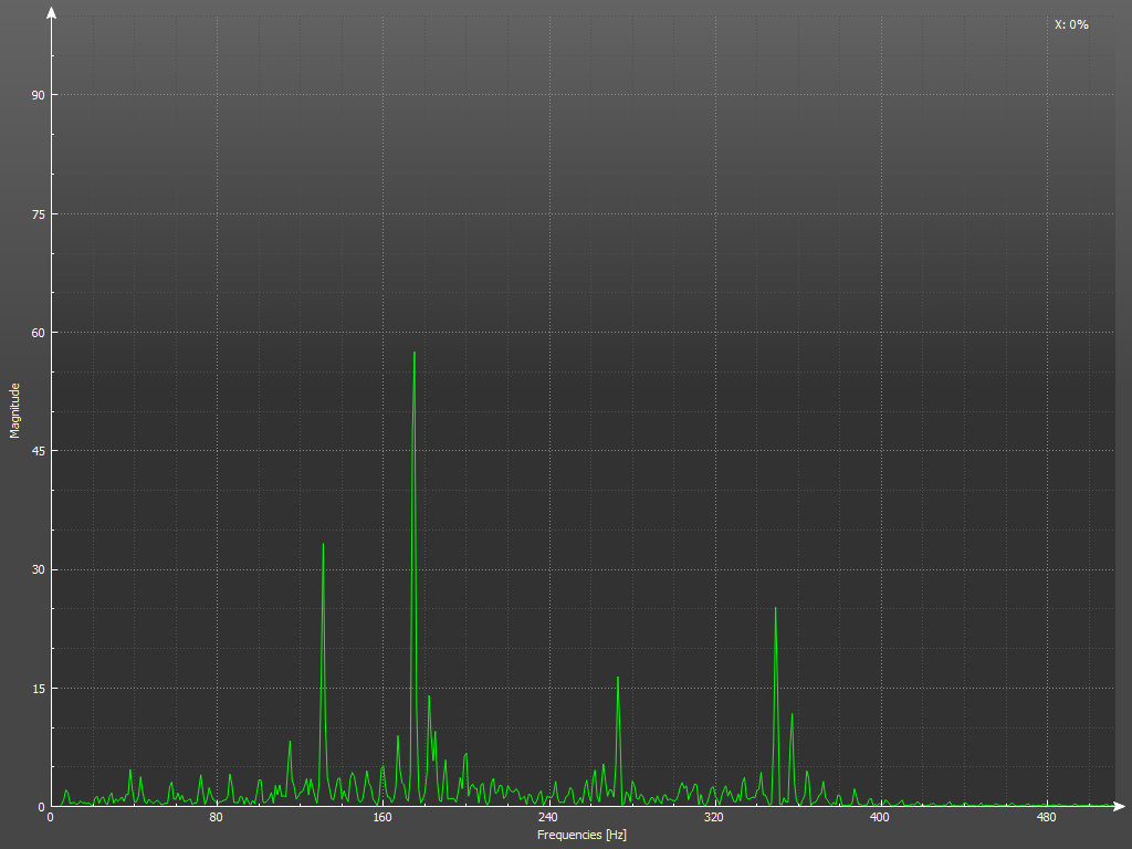

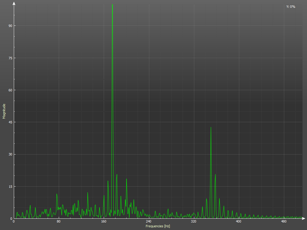

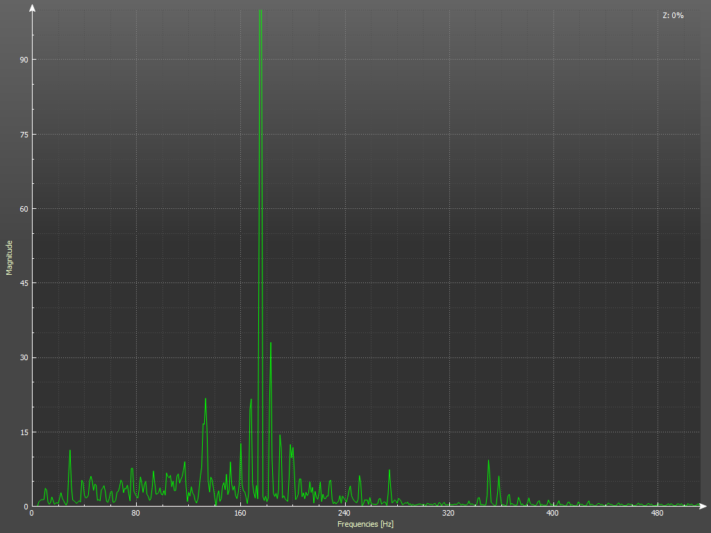

vibration level in the Spectrum Analysis will show you if all is normal or not and what is wrong.
I recommend to run it with tail blades.
Usually in similar cases the value is few times exceeded what is considered normal.

Here is the information you requested. I attached the bank settings (I only set up bank 0), the 3 vibration analyzer outputs (X, Y & Z), as well as a short video showing what happens when I enable Rescue mode or Stabilization mode. I also attached a photo of the installation.
The Vibration images are on the next post

Here are the vibration analyzer output images
