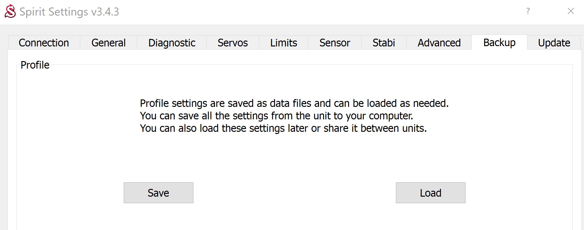

I can only help you how to backup your settings from Spirit Settings to your harddisk -

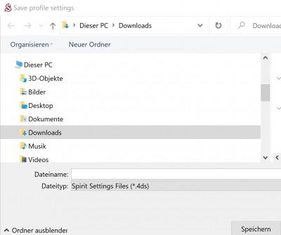

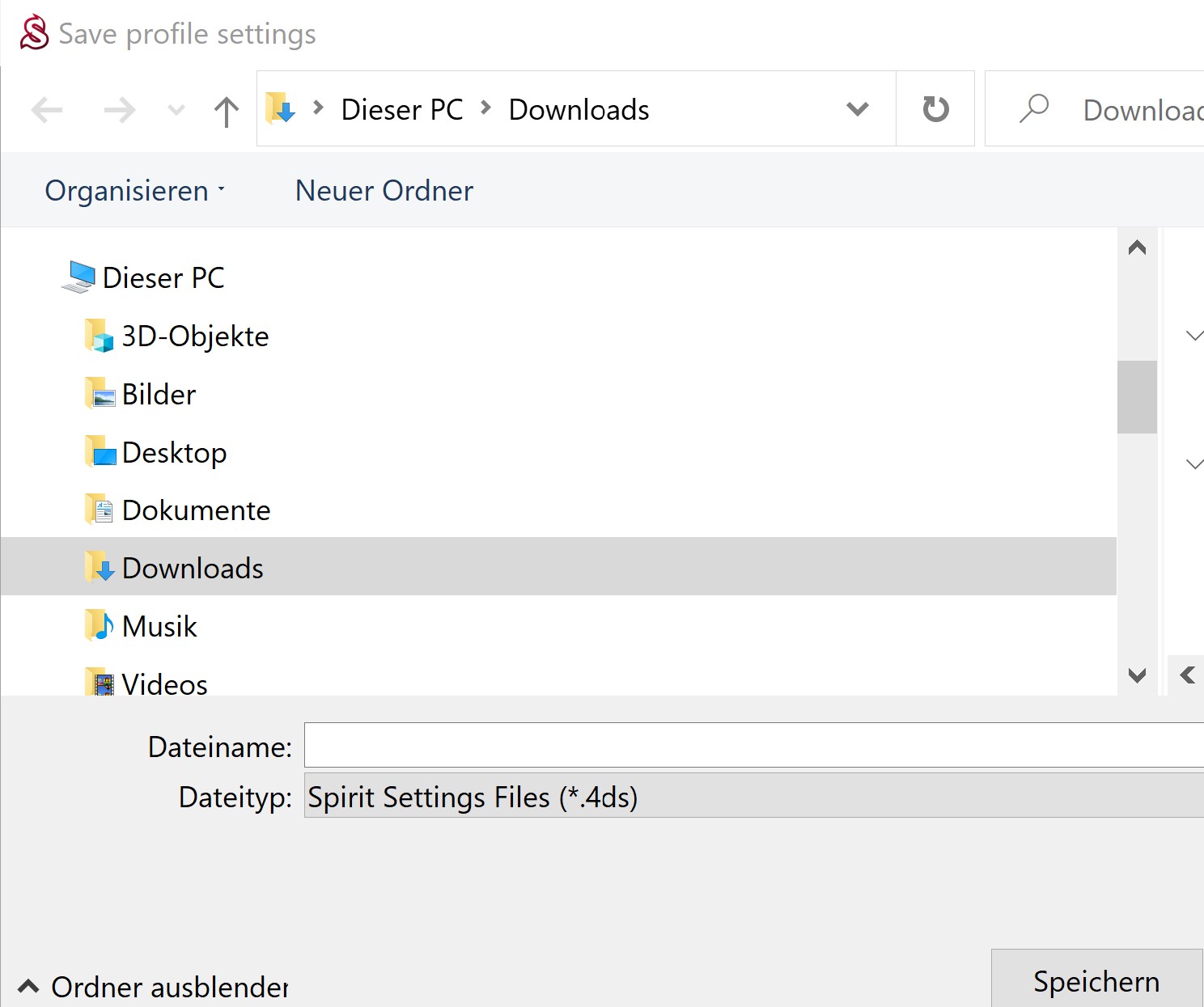

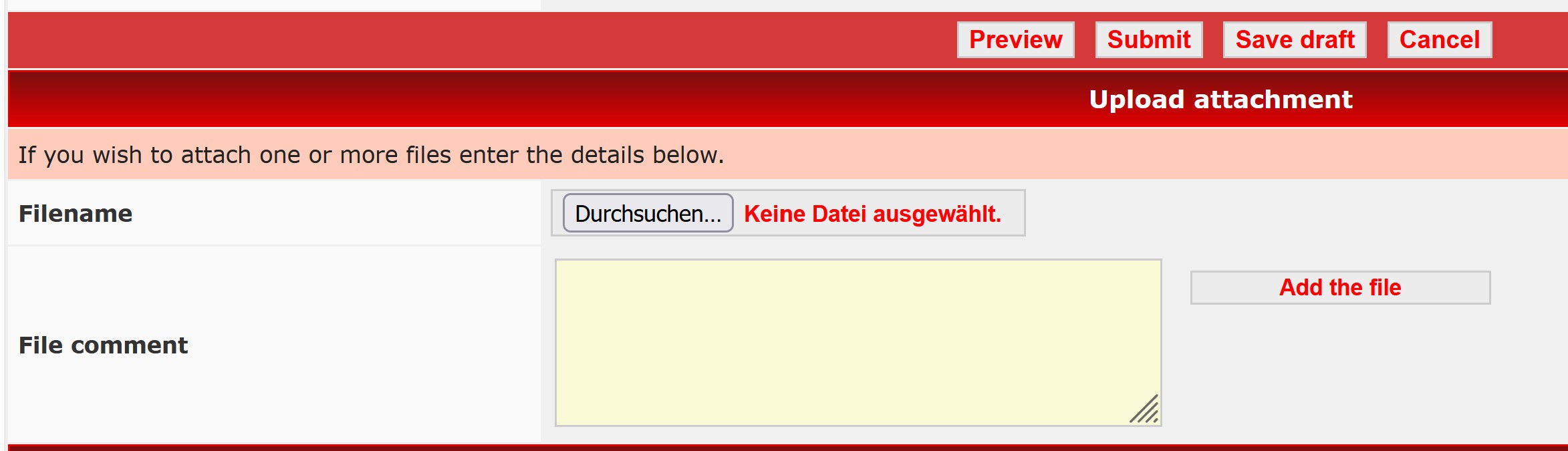

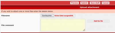

enter a name for your profile and save it - then simply upload the file here in the forum - that's actually it -
