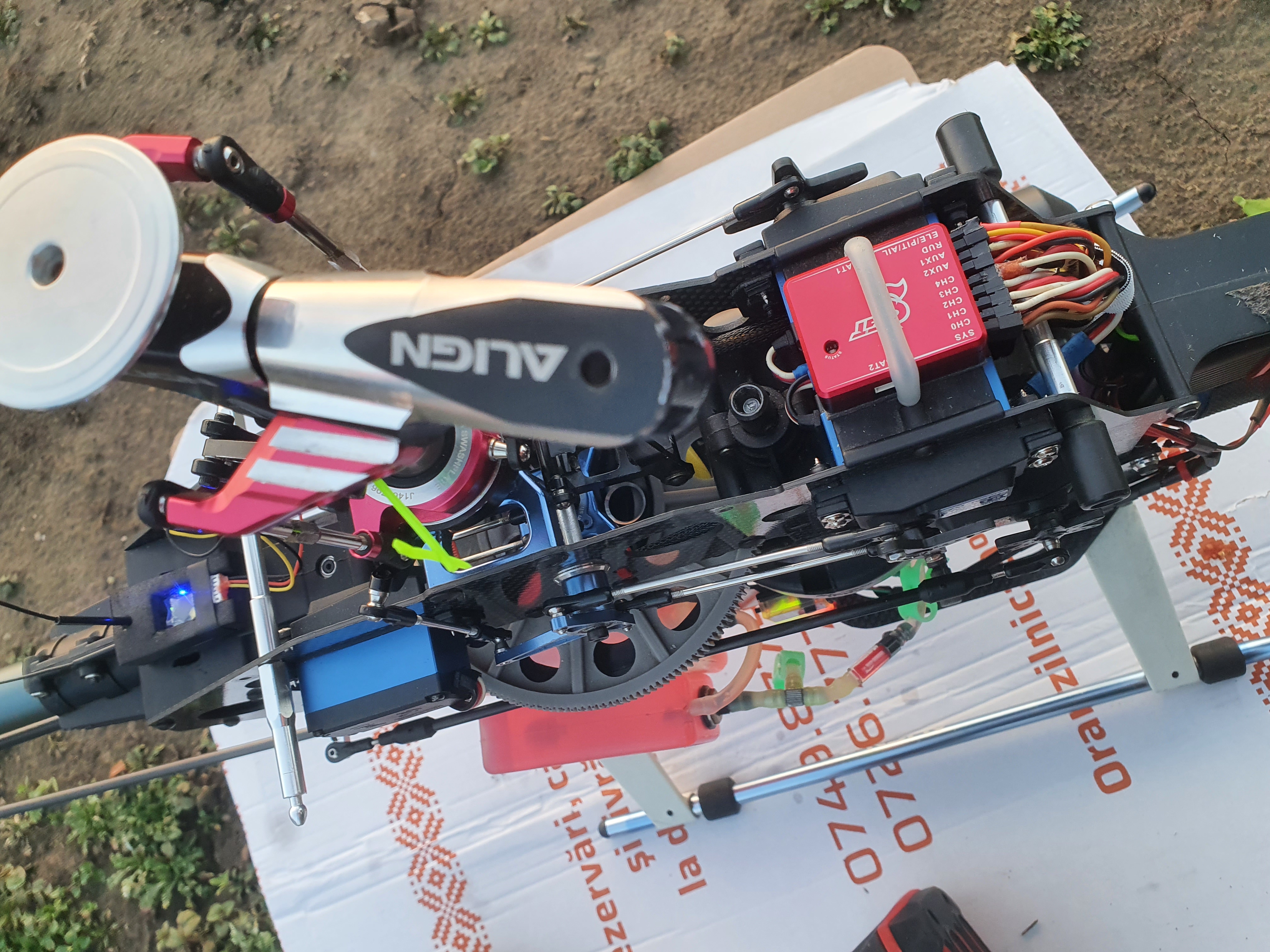

Hey guys, I still can't believe I am actually here writing this, I'm still sad and disappointed for what I experienced earlier today. So I got my brand new Spirit GT last week, I have placed it on a TREX 600N, I carefully set everything up during the last few days with no rush, everything was good to go, except for the governor, which although was set I still had to check it with the engine running to see how it reacts. So today I was planning to maiden the bird, took all blades off, primed the engine, had to crank it quite a few times, and when it started I had a bit of hotstart, and right in the next second everything went silent: engine stopped, servos stopped working, receiver was still one, Align 2 in 1 BEC was on, but the blue light on the Spirit was off. Long story short the unit just kind of DIED all of a sudden. The FrSky RXSR was still receiving power from the unit and it was still communicating with the radio. So no maiden flight for me, and a dead unit. What gives??

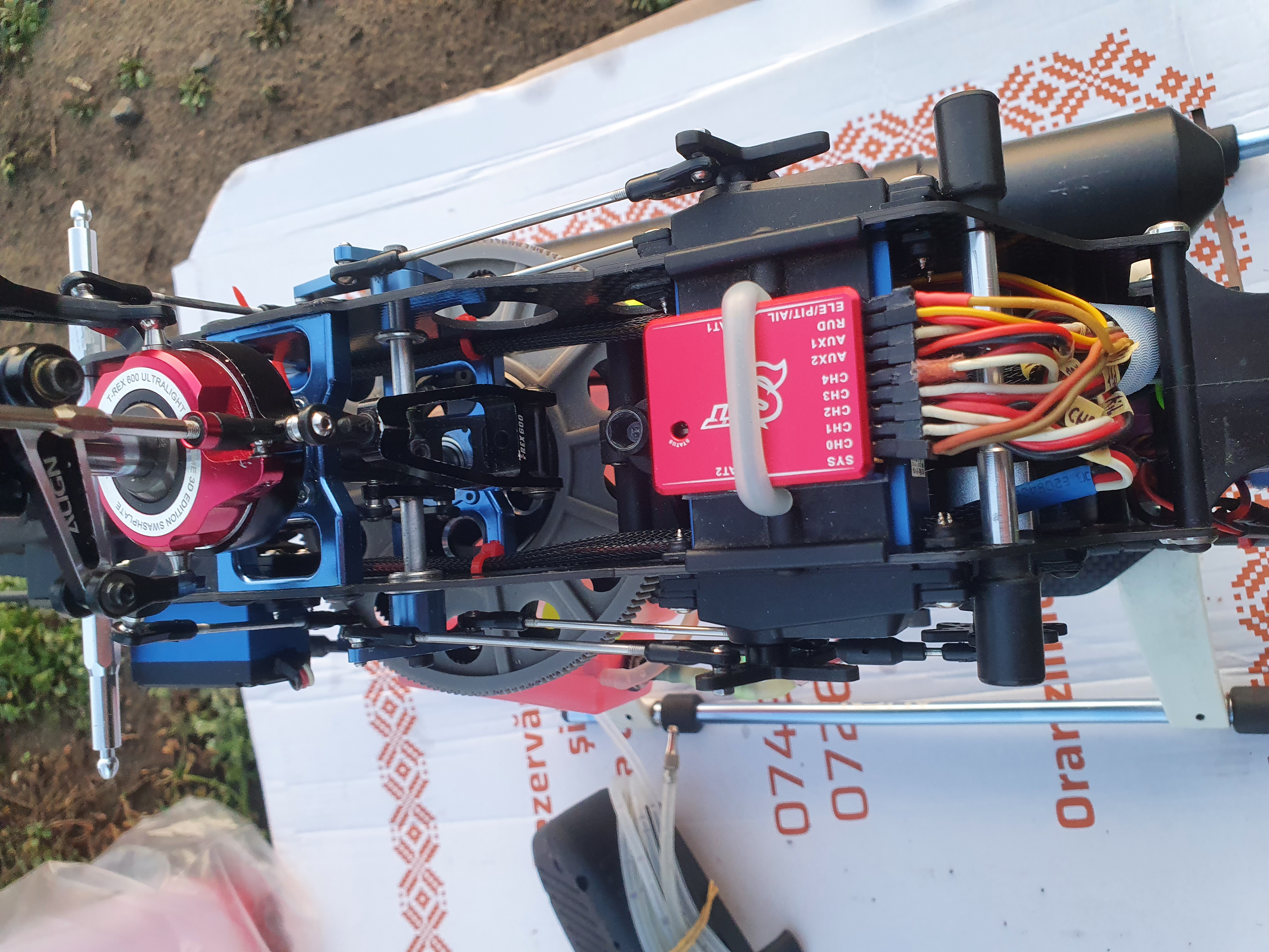

- ELE/PIT/AIL port - RPM yellow wire from magnetic sensor plugged into middle pin of this port
- RUD - FrSky RXSR receiver
- AUX1 - Throttle servo
- AUX2 - BEC (5.79V) from RCE-B6T to
- CH4 - Rudder servo
- CH3 - Pitch servo
- CH2 - Elevator servo
- CH1- Aileron servo
- CH0- has positive and negative leads feeding power to the RPM sensor.
As of now the unit has no reaction, no blue light, no red light, does not react to USB interface at SYS port. I have tried to recover the unit using the instructions provided in the "flashing failed" official page, just in case, but no dice, no lights from the unit, although power still passes through it and feeds the RXSR receiver. Please advise, thank you.

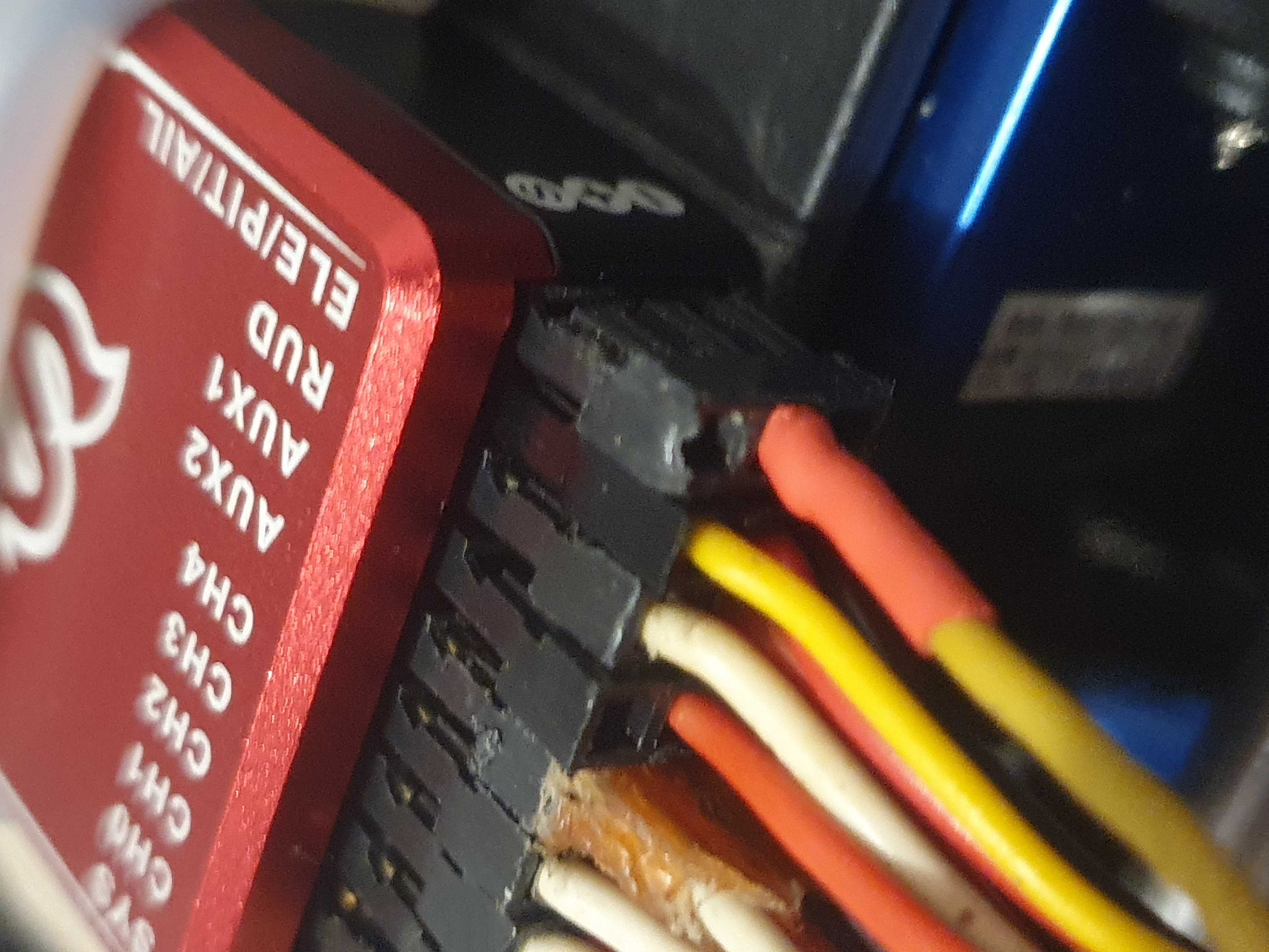

is the orientation of these cables ok? it's so uncertain from the photos...

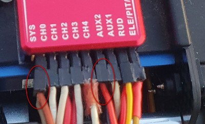

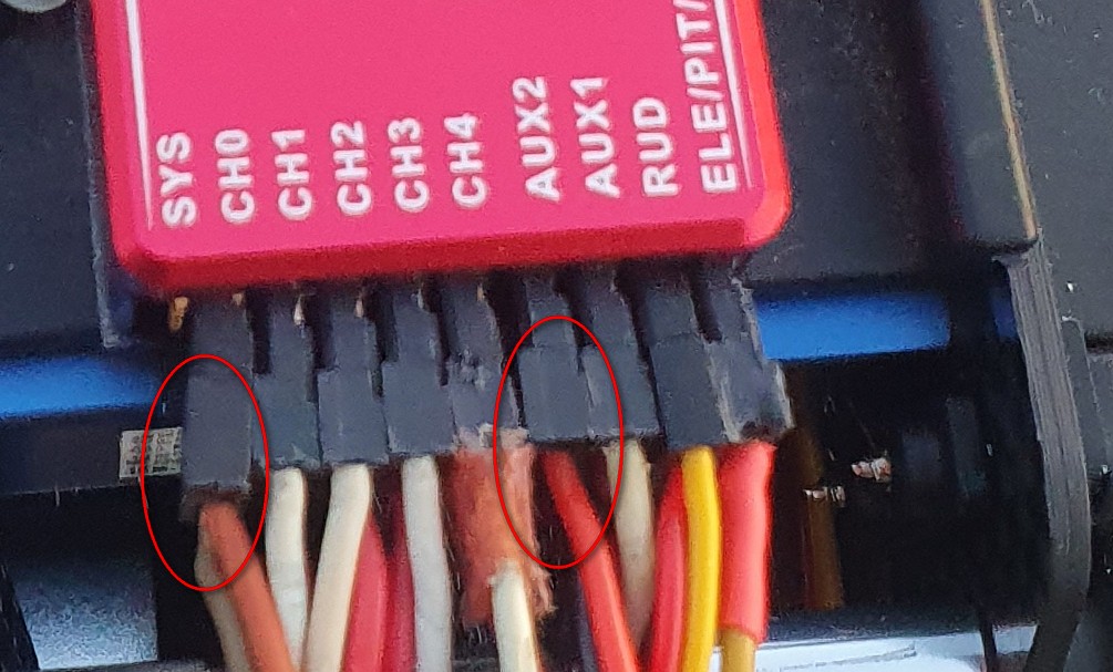

Habásek wrote:is the orientation of these cables ok? it's so uncertain from the photos...
Yes, absolutely. There are only 2 wires in each of those ports. AUX 2 has red and black coming from the BEC, connected correctly with red in the middle pin, CH0 also has 2 wires, that go to the hall rpm sensor, also correctly connected regarding the polarity. See photo below (only got this one on the phone right now):
