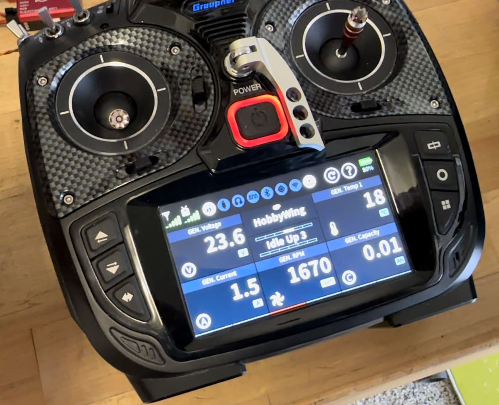

I am using a Hobbywing 150 Platinum V5 esc and Spirit GT FBL on a Goblin 580 Raw build. Full telemetry works perfectly with a Graupner Tx and Rx.Harleyflyer1000 wrote:I am thinking about getting a Hobbywing 150 Platinum V5 esc and Spirit GT FBL for an upcoming helicopter project. Does this esc have full telemetry functionality with Spirit FBL’s?

That is great news! The helicopter project that I’m thinking about is the Goblin 580 Raw. Perfect and thank you!I am using a Hobbywing 150 Platinum V5 esc and Spirit GT FBL on a Goblin 580 Raw build. Full telemetry works perfectly with a Graupner Tx and Rx.
