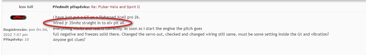

I have just put a GT on a flybarred Xcell pro 2k.
Wired jr 35mhz straight in to elv pit ail.
everything works and reacts correctly, as soon as I start the engine the pitch goes
full negative and freezes solid there. Changed the servo out, checked and changed wiring still same, must be some setting inside the Gt and vibration?
Anyone got clues?
