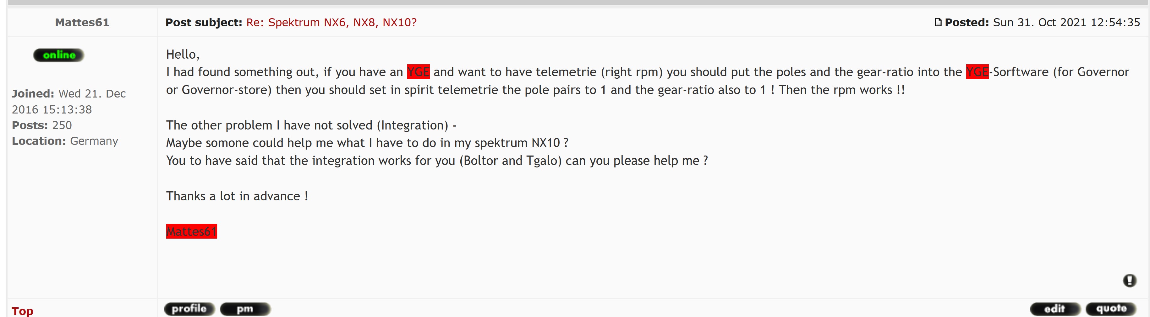

The problem was that I have to set the gear ratio and the sensing divider in telemetry settings (Spirit) to 1 and the problem was solved - I think if you do that in the same way your rpm readout would be correct too - the settings in sensor1 in edgetx the two factors you have to set to 1 Poles/blades and multiplierer -
here the thread where I had a pob with readout of rpm (yge esc): Greetings

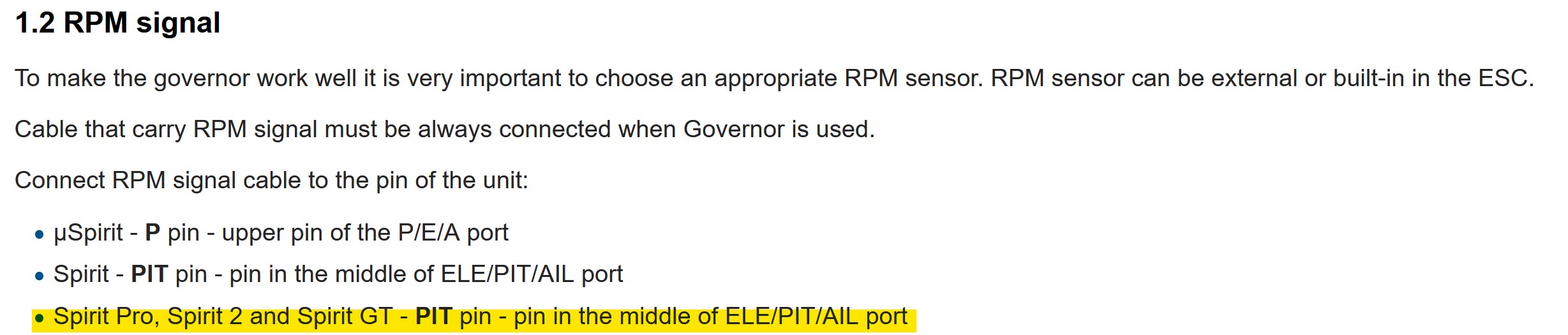

I did everything according to manuals Spirit's and YGE's pages . Only one thing I did different on Spirit side. Manual says connect RPM signal (sensor) to ELE/PIT/AIL port, GT unit. I can't do that sync I'm using Sat1 port for telemetry/sensors and there goes YGE's orange signal wire. That perhaps gets things mixed up. I was going to give full authority to Spirit but it is what it is. ESC will take gov. duty

the sat1 port is only for telemetry from ESC to FBL not for the govenor in the Spirit FBL !!
If you use the Spirit Governor you have to put the rpm-Signalwire (from ESC) additional to the telemetry connection in the Pit-Pin into the Spirit FBL -If you have not this connection your Spirit Governor will not work - Then all should work !

All good now. Red wire from ESC telemetry lead ( rpm sensor) in ELE/PIT/AIL port.
Corrected poles/gear from (1,1 to 5,5.7) and rpm numbers are right too.
