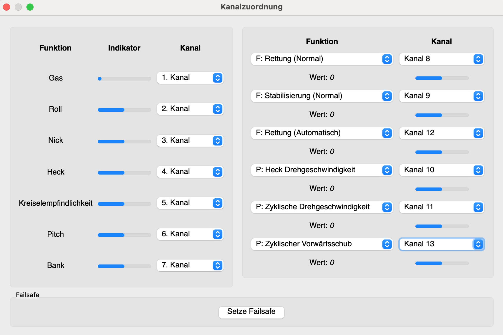

is there a chance to get some more channels available for Spirit / Jeti? i.e. all 16 of my Tx?
now with the really great Stabi/Rescue activation via channels plus some live tuning i am running out of channels on a Heli I am using for buddyboxing too (so even more channels for stabilization and more live tuning to tame down a bit the Heli etc needed) and now another channel needed (to ch0) for switching off the 1st Buffer. what I never had thought off on a trainer becomes real: 13 channels is not enough :o

... to be more clear, if it was not (Sorry): of course i can use all 16 channels, but not at the same time. i am having the need of more than 13 channels mapped at the same time. :)

DS-12s too :) i am using the knobs and digital trimmers a lot for all the live tuning things (esp. during initial setup) - absolutely great with the trimmers for "per Flightmode" (like Gyro) and knobs for "Global". channels 1-7 standard. Sc for Auto Rescue #12, Sb for Rescue (spring loaded) #8, Sa for banks #7, Sd for Autorotation, Sf Motor On/Off plus a channel (should be #14) to CH0 for 1St Buffer on/off, Se for trainer/student plus Stabi #9 (only for some students to normal/acro). live tuning for rotation rates and cff for taming down for students on trimmer left hor and knobs 7+8 (#10#11#13). Gyro trim per bank always on trimmer right hor.

as support for 24 channels has been added with version 3.5.0: when will we be able to use those additional channels for special functions too? i tried with 3.5.0 but the total number of channels that can be assigned at the same time is still 13.... :(
