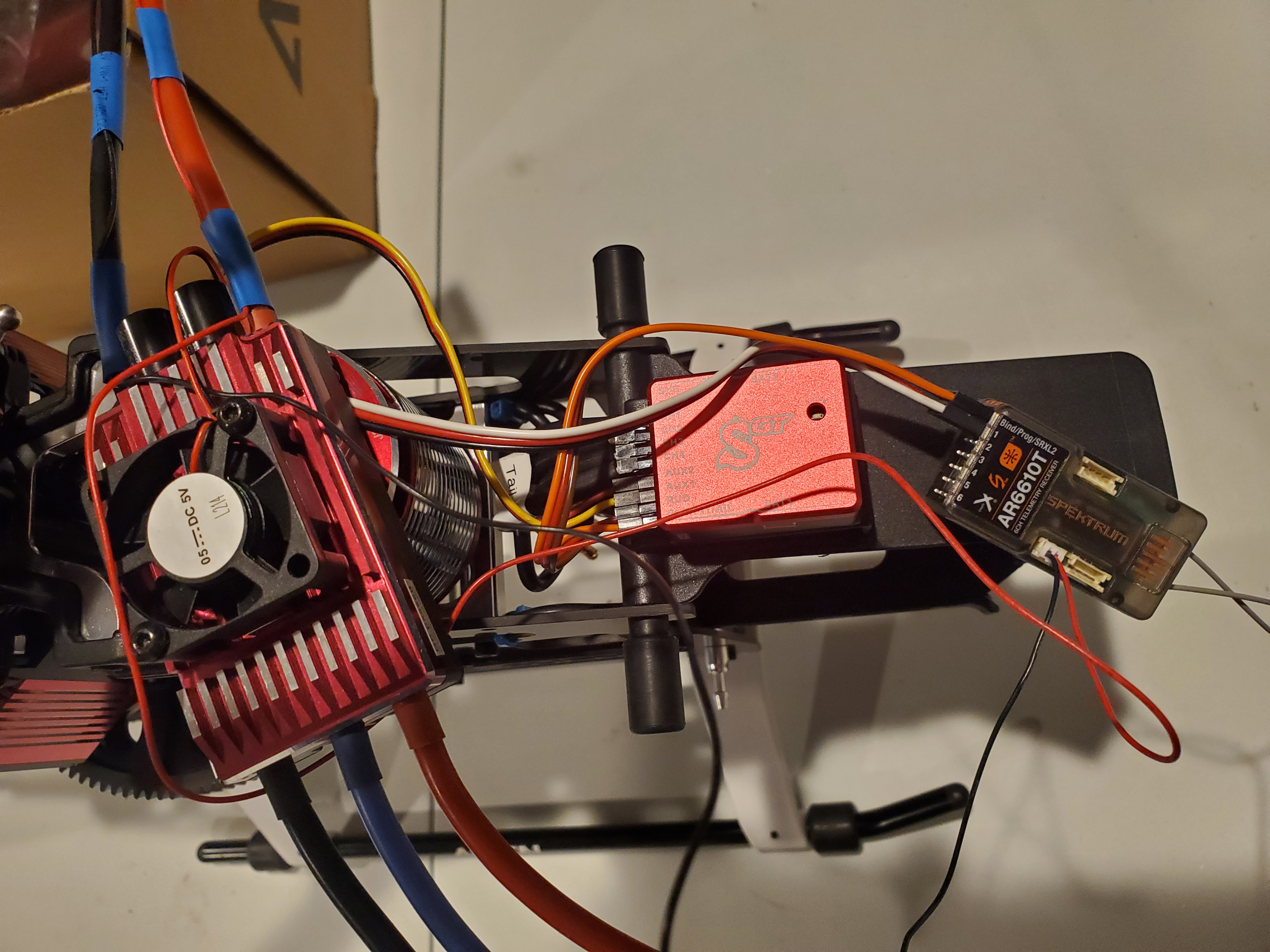

New build Align Trex 550X. All stock except the FBL.
FBL Spirit GT
ESC Align RCE-BL100A
Rx Spektrum AR6610T
Servos DS820M & DS825M
On the Spirit GT:
SYS Empty
CH 0 Empty
CH 1 Left servo
CH 2 Aft servo
CH 3 Right servo
CH 4 Tail servo
AUX 2 red and black from ESC (black on bottom red on middle pins)
AUX 1 yellow from ESC (on top pin)
RUD red and black going to Bind/Prog/SRXL2 on the 66610T (both have black bottom red middle pins)
ELE/PIT/AIL orange wire to Bind/Prog/SRXL2 on the 66610T (top pin on both)
White red and black from the ESC to Port 1 on the 6610T
Did I get that right???
Don't wanna plug in a battery and risk smokin something if I got it wrong

After checking both ESC and FBL manuals I might have it wrong.
If using the Spirit Governor, the Throttle wire (white red black) needs to be plugged into AUX 1. The yellow wire is the RPM Signal and needs to be in the PIT pin.
Does that sound right?

From what I can tell, since I'm using a full size Rx, AR6610T, the Throttle wire from the ESC goes to Port 1 of the Rx. The Yellow RPM wire goes to the PIT pin
Posts: 13045
when using Spirit Governor, the ESC (Throttle) must be always connected to the Spirit unit - AUX1 port.
Yellow - single wire connector must be modified so that the wire is in the center of the servo connector.
This should be plugged at the PIT pin.
Receiver can be powered just by one wire.
But if you want to be extra safe you can connect it with second cable from CH0 to any free port of the receiver.

That is exactly the advice I needed.
Thank you very much
