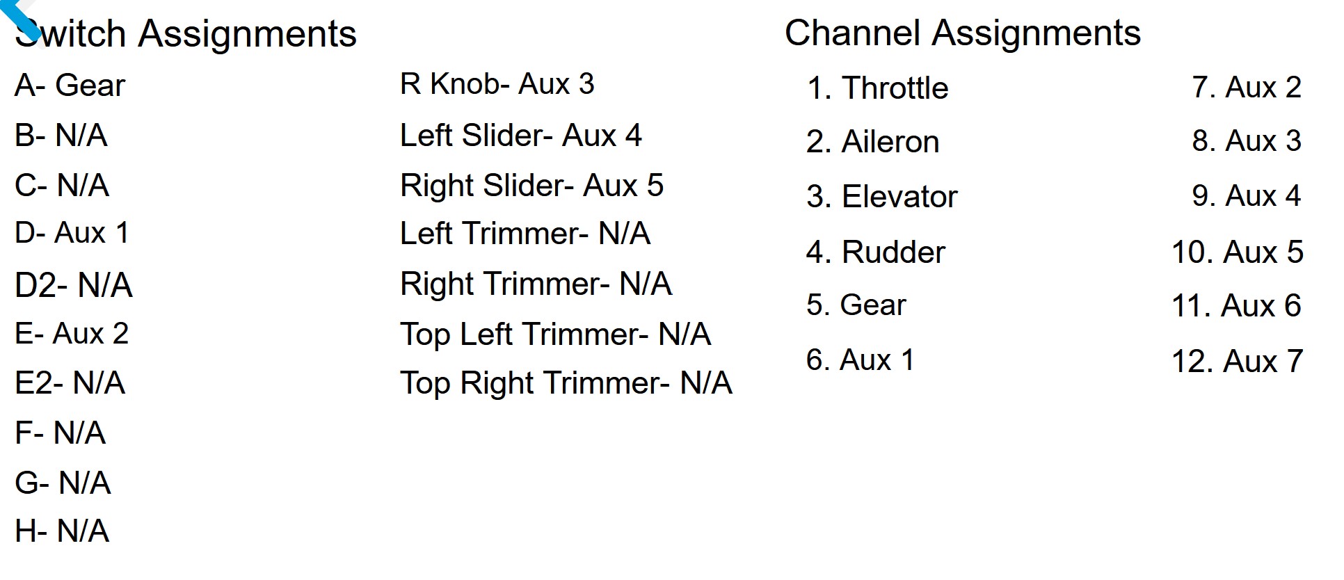

Someone posted a really good document referencing the interfacing of Spektrum satellites with 3rd party hardware, and on page 5, it shows the channel identifiers. There are 12 channels in total.
This evening I was able to configure and validate the following channels, on a Oxy 3 heli I just set up:

Last night, just for fun, I added 4 more channel assignments in the X20S, and then in the Channels section of the Spirit software (14 total channels). This way I could see if there's a reaction to the buttons. Only 12 channels work, the other assignments don't do anything when I press the back buttons or move the side sliders
So the manual I linked earlier is correct. I don't know if the SRLx sats are any different, but the standard DSMx ones, like the SPM9645, are 12.

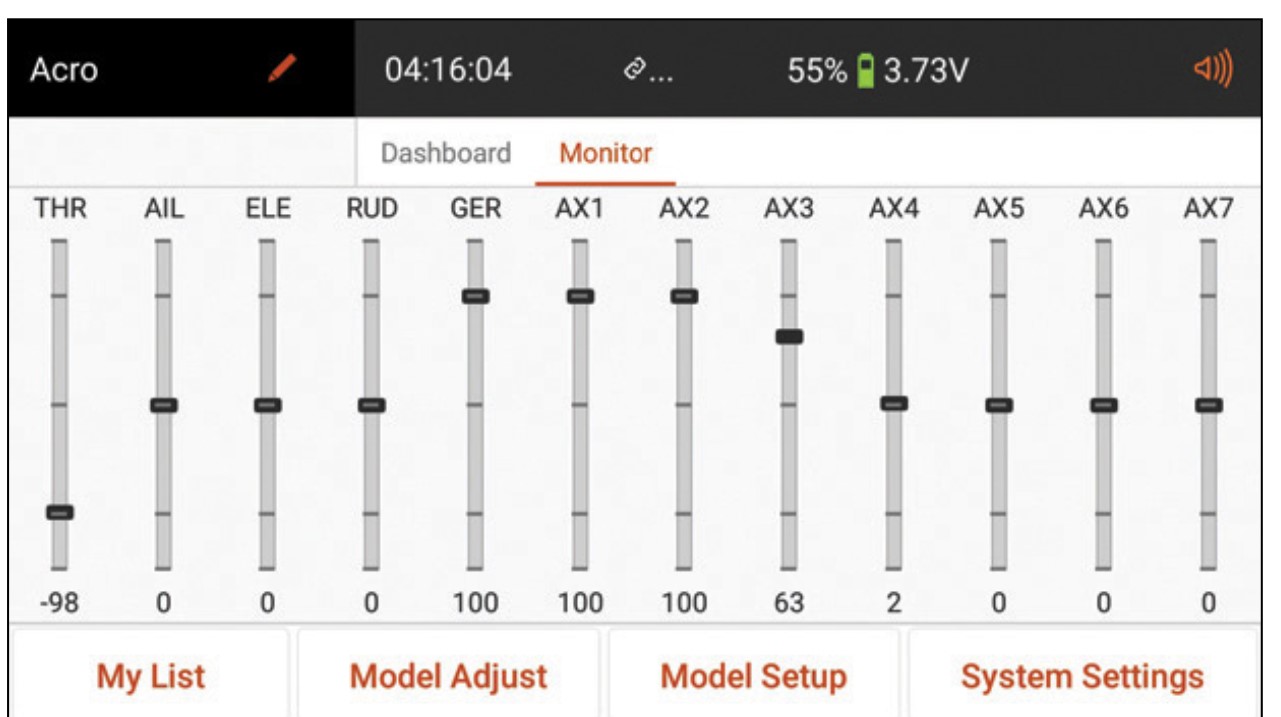

I have found some info at https://www.manualslib.com/manual/16683 ... =58#manual
The max is shown in acro, heli etc. (IX20) like:
Manual spektrum IX20:
There are shown only 12 channels and I don't know if there are more than this...
Maybe someone other can help here...

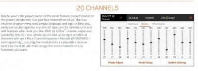

So this is the Spektrum IX20. It only shows 12 channels available. Is this for the same type satellite, or in general?
On the FrSky x20s, I can create a new mix, assign a source (buttons, sticks, sliders), then assign a channel to it. Then, in the Spirit Settings, General, Receiver Channels, I start adding functions. The GeoLink, Rescue and Stabi functions are the simplest ones, because I can assign them to a channel, and when I toggle the switch or press the button, I can instantly see if the value changes (Green indicator).
I originally assigned 14 mixes/channels, because I ran out of buttons, some of my other buttons and switches are already assigned to other functions, but I had 4 free ones (SC, left back button, and 2 side sliders). But in the Spirit Settings I can only assign a maximum of 13 functions. Anyway of all the ones that I mapped, all worked except the one assigned to channel 13.
So there are limitations to both the receiver and the FBL.
If your receiver can only handle 12 channels (or less), then you can only assign as many functions as you have channels, but if your receiver has more than 13, like my FreSky receivers that have 16 channels, then the most I can get out of it through the FBL is 13, the rest are not usable. If I had physical servo outputs (PWM) on the receiver or if I was using S-BUS servos, I could use the other channels, but with a normal setup, 13 is the most you can have.
Posts: 643

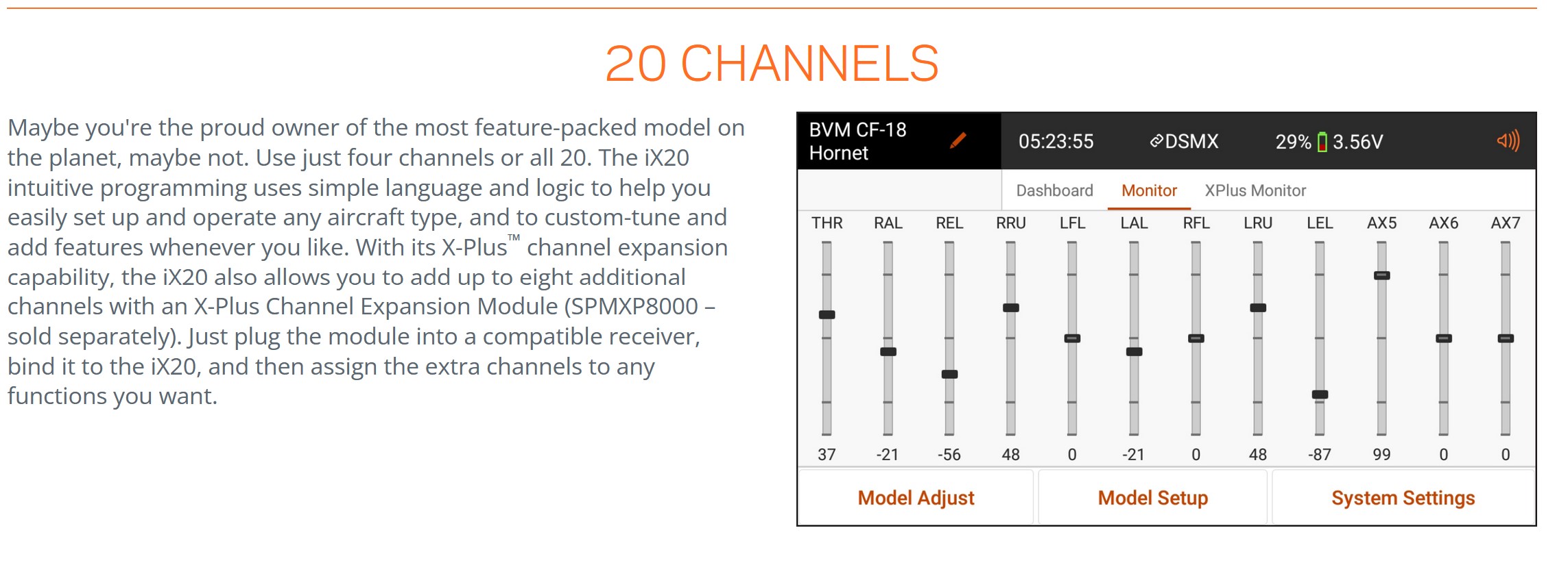

I found something new about the IX20 - if you want more than 12 channels you need an X-Plus Channel Expansion Module (SPMXP8000) -->" Just plug the module into a compatible receiver"...for normal purpose 12 channels are the max for the IX20 no matter what type of receiver is present (except for the expansion module) -

Wow. Are you saying the iX20 only has 12 channels by default, and you need to buy and extra device in order to use the other channels? That sounds like false advertising.
