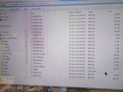

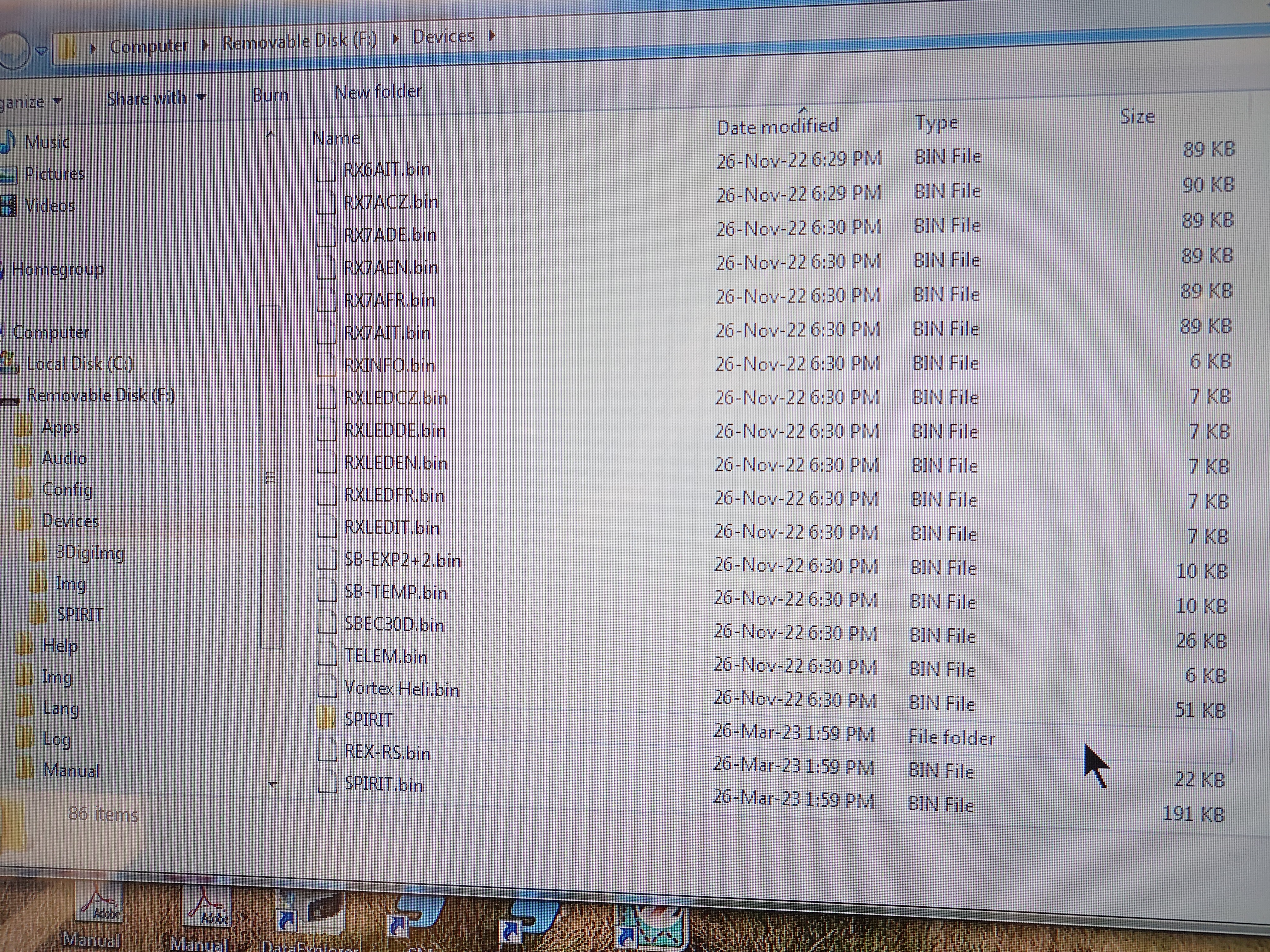

Thomas...my ds24 has always said ERROR bin file update required. altho updated in studio.
today i deleted the files from the sd card and put the up dated files back, it still says the same?
i can see the updated files there, have i put them in the wrong place? when i delete them there is nothing working.
can you save the day?
Posts: 1068
https://spirit-system.com/dl/jeti/SPIRIT-3-5.zip
Updating procedure:
Download JETI Integration ZIP archive from our web page - click at the JETI icon.
Extract the archive to your hard disc.
Connect JETI radio with USB cable to your computer.
Confirm USB connection at the radio.
Copy content of the directory SPIRIT-3.X to Devices folder in SD Card of your radio. This process must rewrite old files.
After this procedure, you should see SPIRIT.bin, REX-RS.bin files and SPIRIT directory located in the Devices.
In unit Spirit must be 3.5.0 fw ... update via SW:
http://www.spirit-system.com/download.php
