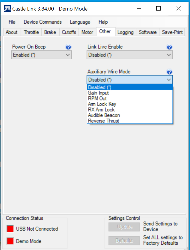

I have the castle.
the castle is programmed and you decide how to set it.
me for example i had to set that the wire functions as a speed sensor.
In your case you have to make sure that your esc send data as requires them spirit.
you have to use the software of the castle

franz88 wrote:I have the castle.
So i have to tell my esc to send data to/thru spirit, is that correct ?
I had live link enabled, but still no Telemetry. Do i use white wire from esc for that?
Can you clarify how to do this, or send/post a screen shot of how to do this ?

you have two plug.
the plug at one wire from here
decide what to do.
but probably the spirit takes the data from the plug three wire from the signal wire (the white)
Therefore if you have activated link live It means that you didn't enter Telem CC cable as spirit says in this link
