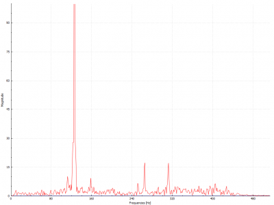

Also, analizing vibration, I have high ones in all axis. this is common in this kind of 450L heli that is so powerfull?
Its NEW, right out of the box and it is almost the 10 heli I assemble.
What about the rescue that comes up and backwards?
in the bench seems ok !!!
Posts: 12988

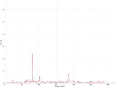

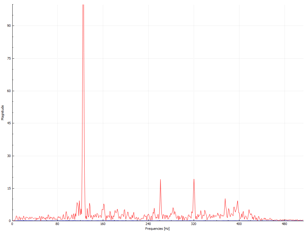

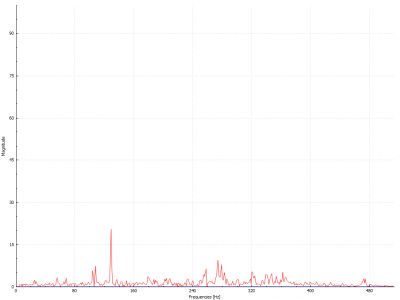

Can you please post Graphs from vibration analysis? Especially Y - aileron axis.
If there are really big vibrations it may cause bad perfomance of the helicopter generally including rescue.
pabloK
Posts: 56
Joined: Tue 17. Feb 2015 14:42:04
all axes at 90 % throttle and NO BLADES at all
in some points, graphs down to 45% aprox, but i cant reproduce again this. I tried several times and almost always vibrations at 70%
i am using a foam pad from the TAROT ZYX-S2, maybe this is some problem too?
thanks

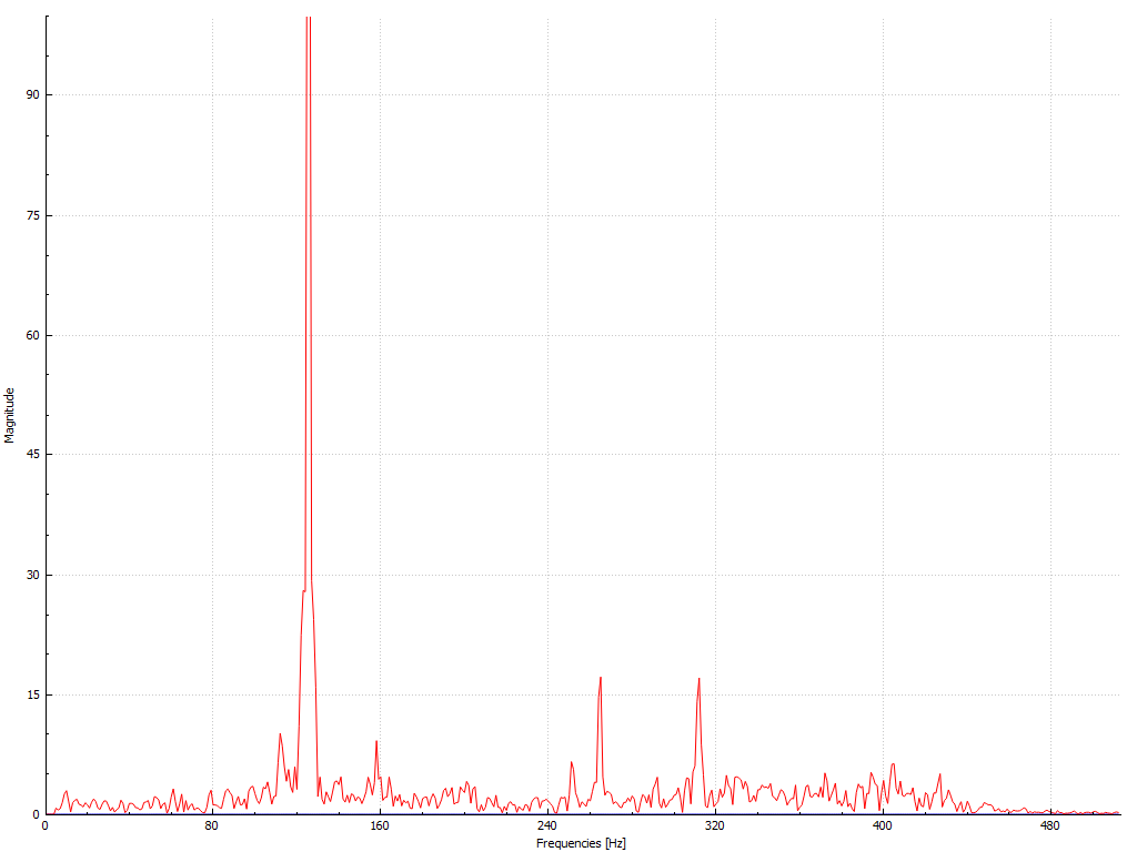

pabloK
Posts: 56

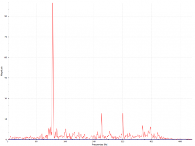

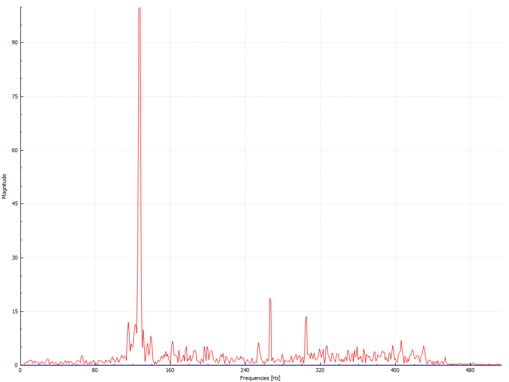

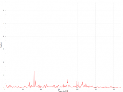

Hi
I change the anti vibration foam pad for the spirit (the one that cames with the second unit I bought recently, the first unit doesnt come with it)
Please, see the new graphs for 3 axes at 90% throttle. change absolutely !!! now is in the range !!!
Posts: 12988
Oh nice, it is much better now.
You can try this again with tail blades to measure it more precisely. Sometimes tail blades can make big difference.
