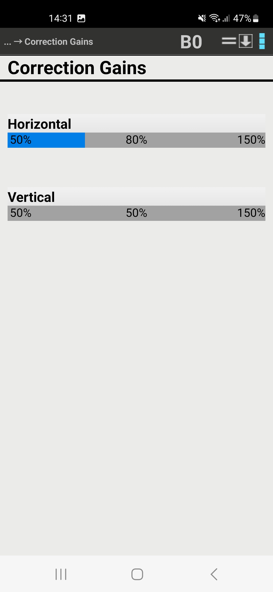

I have a problem to set the right Correction Gains for Geolink.
I can set the Vertical Gain with the PC Software down to 35%
I want to set this with the WIFI Software 3.5.1 and the lowest value is 50%
Is this a bug?
Thanks for Help

Updated Spirit Settings for Android will be available in 1-2 days where this difference will be fixed.

Thank you so much for your work
