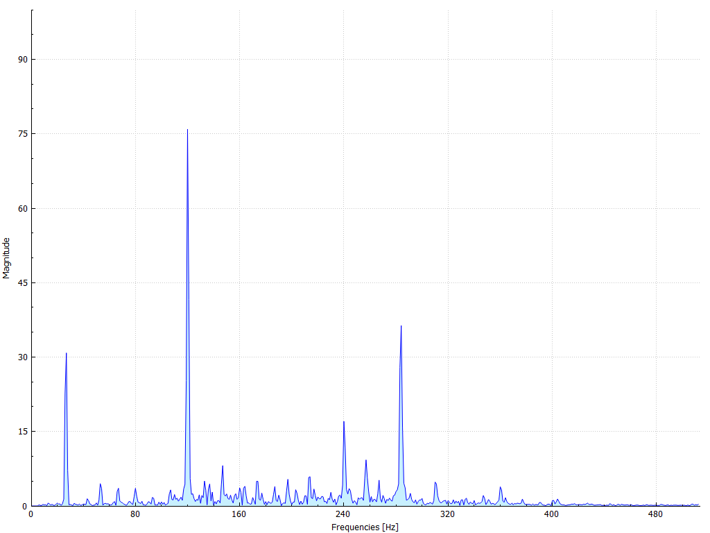

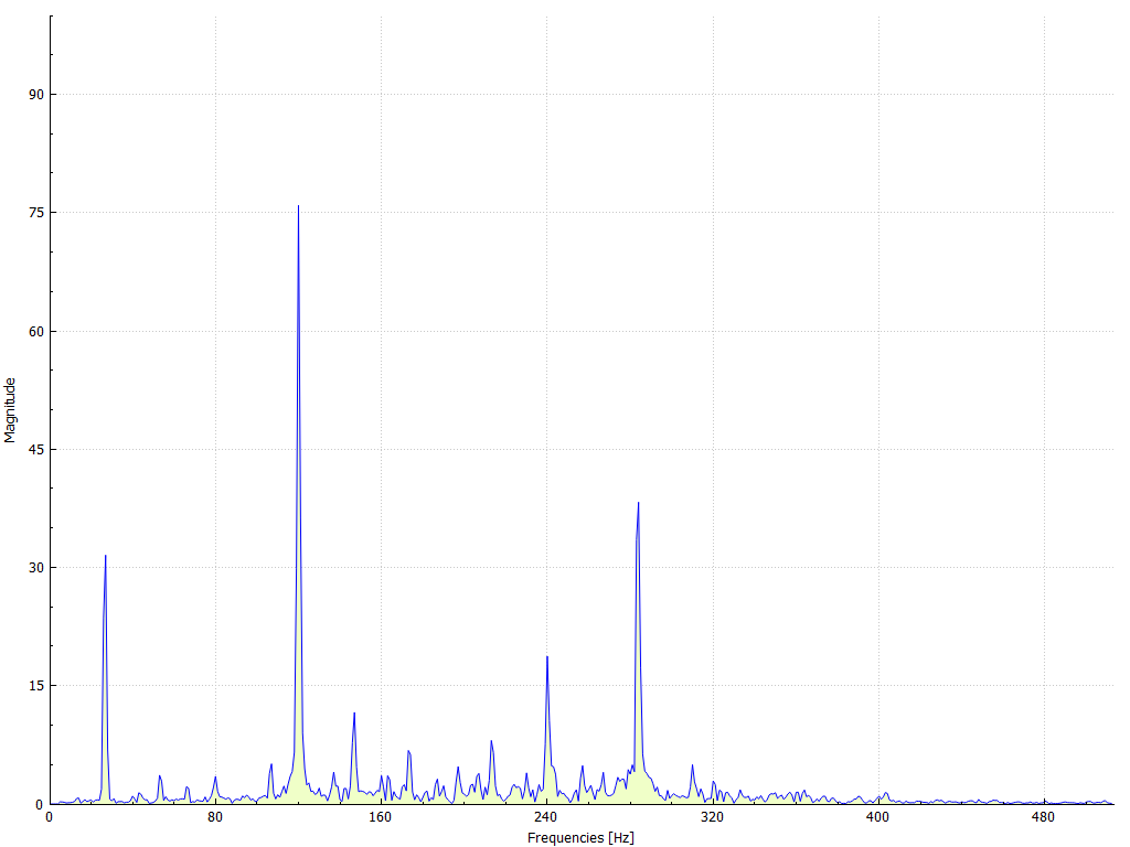

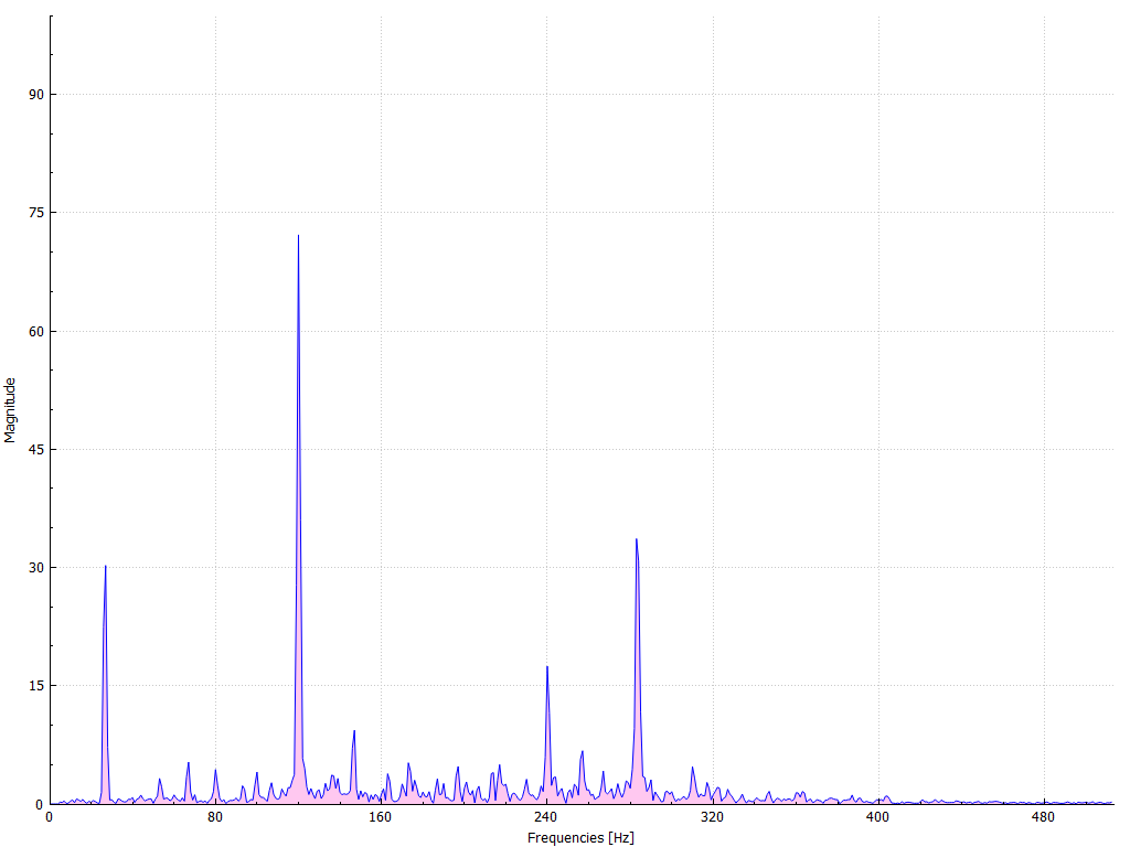

I decided to run through the analyzer and see what it would tell me. This is a Chaos 600 ESP, 880 KV motor, 16/170 gearing, 1550 head speed, 6s power. Sitting on a short short pile carpet, inside, no winds, etc.
All three graphs are very close to the same. What I don't understand is the relationship of the graph data to RPM so that I can close in on where I should look. The little bar graph on the screen never went over 50 on any axis but it was generally always in the 40s somewhere.
My guess is that the big spike is not a good thing but I am not sure where to look first. I can tear the whole thing apart (and will do it if that is the answer but I think teh graphs are telling me something and I simply don't know what I am looking at.

The graph is showing Hz so multiply by 60 to get the RPM figure then use the gearing ratio of the heli to identify the likely sources.bdfox1 wrote:I have looked through this entire section of the forum and can't see anything that gives any better idea of what I should be looking for. Ditto on HF.
Some clue as to the direction to head will be appreciated.
You'll probably find that the first spike around 30Hz is your rotor head (actually anything from the main gear upwards), the much larger spike around 120Hz is probably the tail, higher still you may have a little motor imbalance as well.

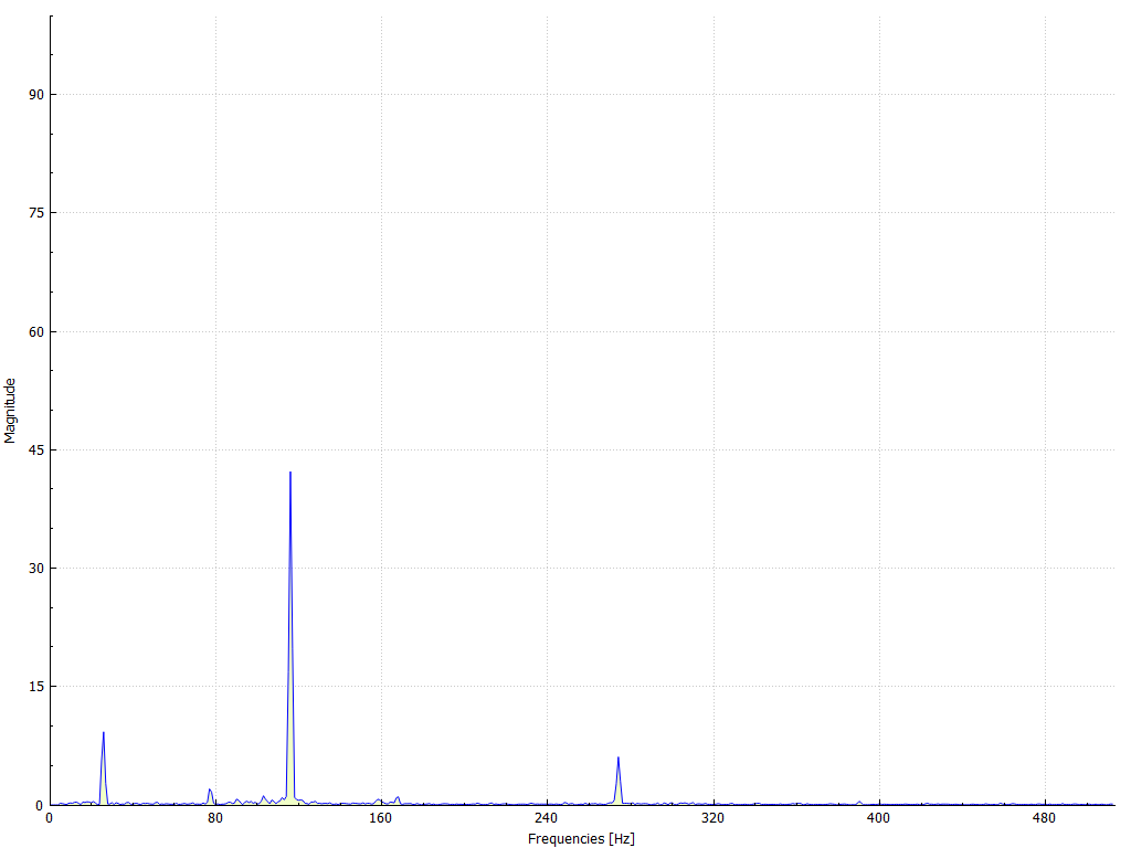

Exactly where the problem was once I went looking. For whatever reason, the front end of the tail boom was not fully seating (by about a cm) so the TT end wasn't fully engaged in the umbrella gear (maybe even at both ends at one time) so it could move around a bit and undoubtedly the cause. Got that all fixed up and the spike went down to a very small bump. It has been that way for a long time and the thing flew very nicely in its flybarred form. Now that it is FBL with a Spirit it should just be magic.
Now that I know the factor to use this will be a a tool that I use more frequently just to keep an eye on everything.
