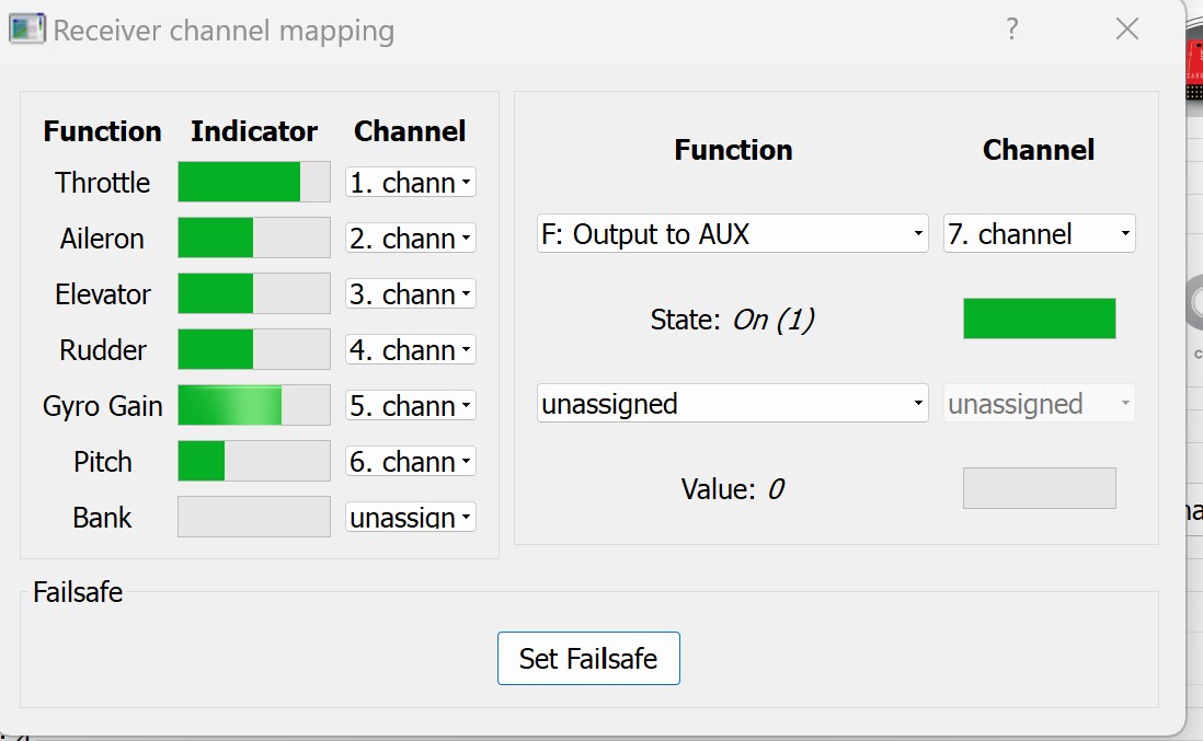

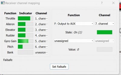

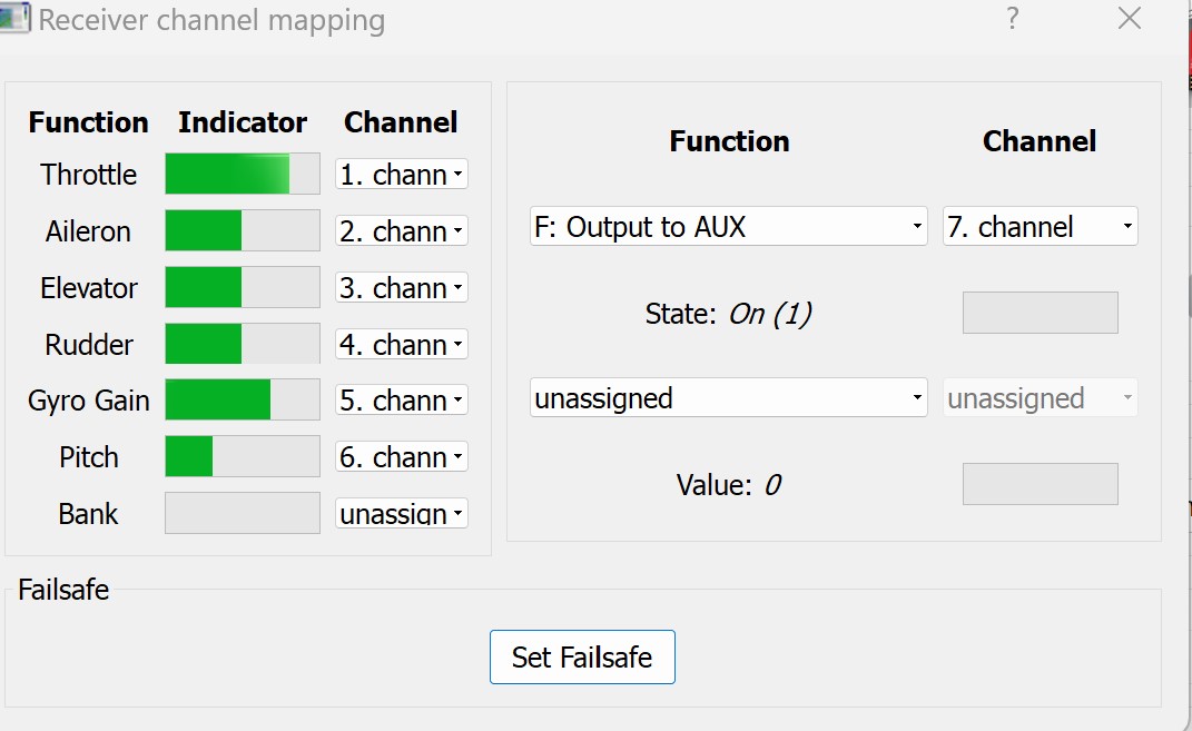

I have connected it to a Spirit RS Aux Channel and have activated the channel through the Spirit PC firmware channel settings.
However no matter what I do through my Jeti channel settings (ie negative value set to max -150) I can't get the Gryphon to "turn off" and go back into its sleep mode.
The Spirit PC Firmware "Channel" screen shows that the aux channel is going back to a apparent "0" value when switched off and a full open value when switched on.
If I deactivate the Aux channel through the Spirit Firmware or plug the Gryphon directly into a power supply it then happily sits powered up in sleep mode.
I hope this all makes sense and maybe someone can assist me in getting a no signal value through the Spirit Aux Channel.

Plugged in a servo and it moves fine with the switch activation.
Also tried reversing the channel but no change in the Gryphon.
I should add that the Gryphon does buzz when its in "glow mode" and the buzzer does start reducing in volume / tone when the switch is in the OFF position and trimmed to negative.
Again when I just plug in a pure power supply it turns on fine in sleep mode (no buzzer) but I can't get it to do this through the Aux channel on the RS?
