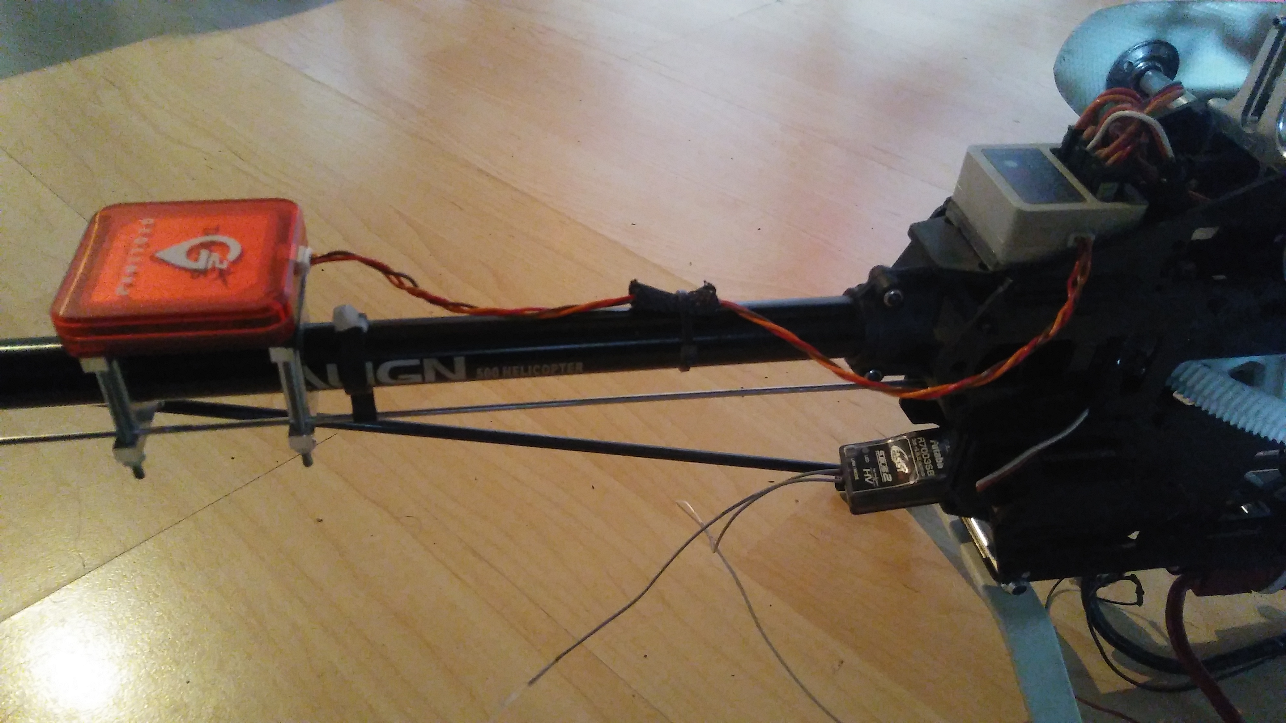

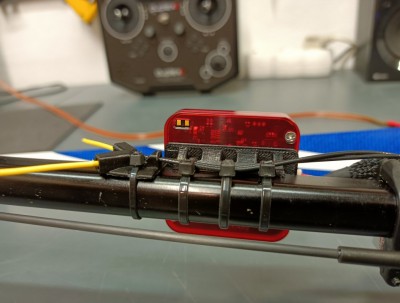

how do you avoid slipping around the tube? (geolink support)
tightening the two screws is not enough
Posts: 1068

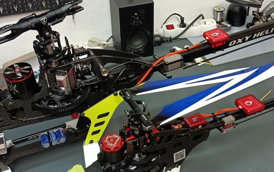

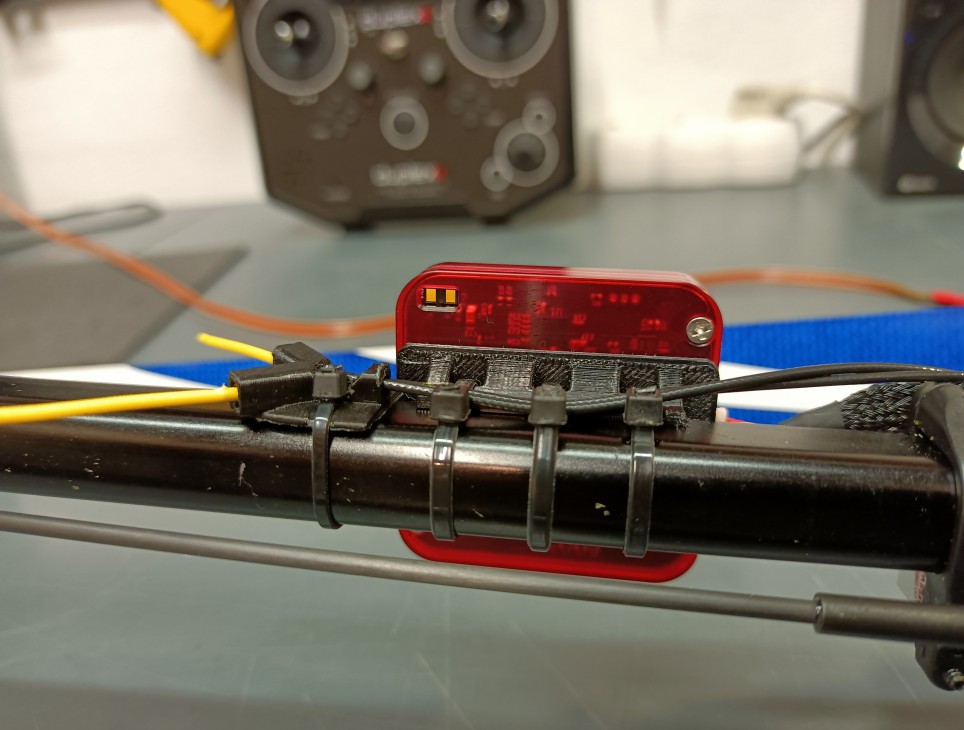

https://store.spirit-system.com/cs/pris ... drzak.html
I have this holder, without screws, you use double-sided adhesive tape like the one for the units (or similar) and zip ties.
franz88
Posts: 343
is good.
did you put the bioadhesive both between geolink and support
and between support and tail tube?
is important between tube and support why the clamps with vibrations they can rotate the geolink support.

the specially milled bracket is very tight because it has a clamp. The supplied pad sits between the module and holder.
