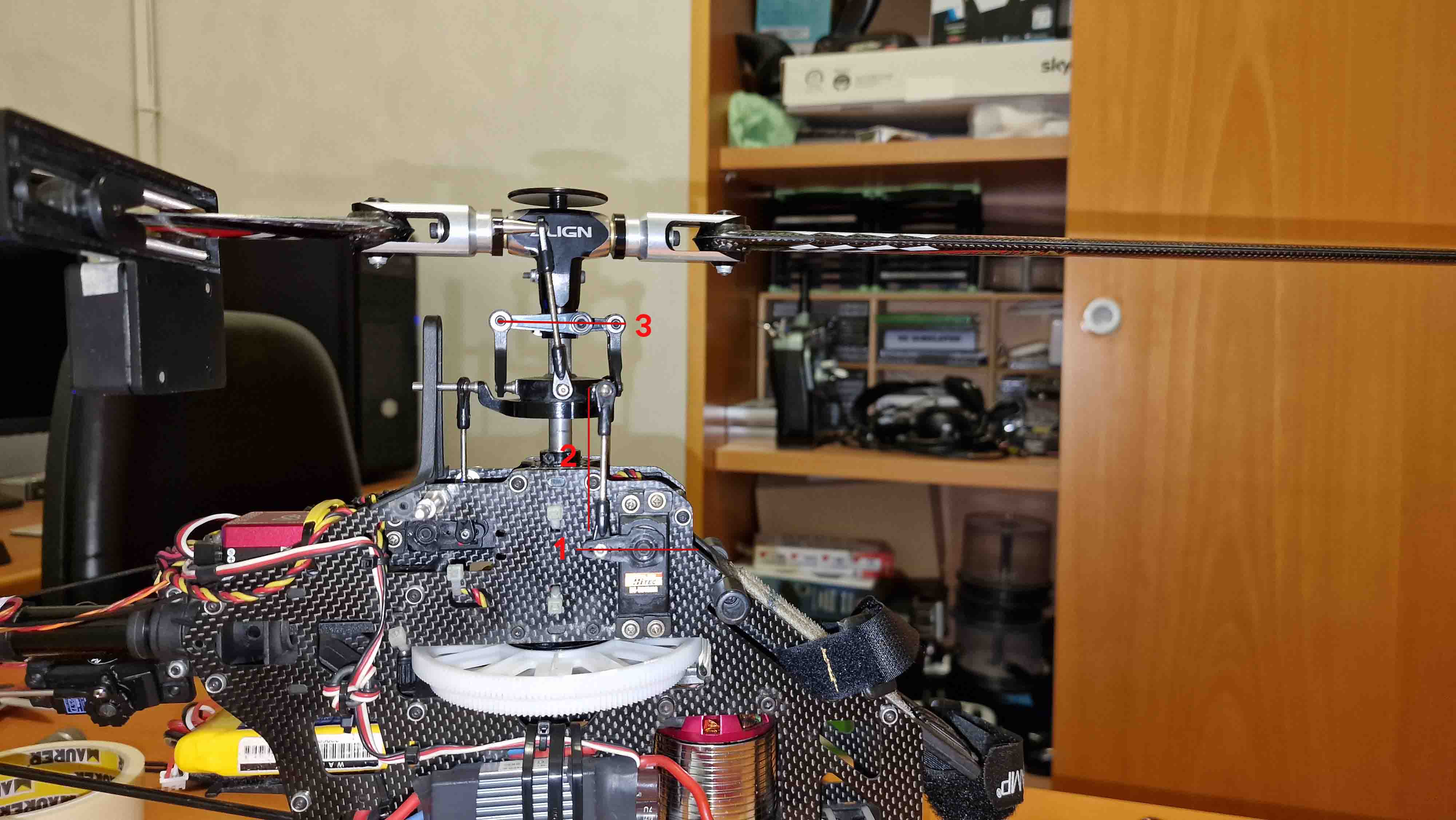

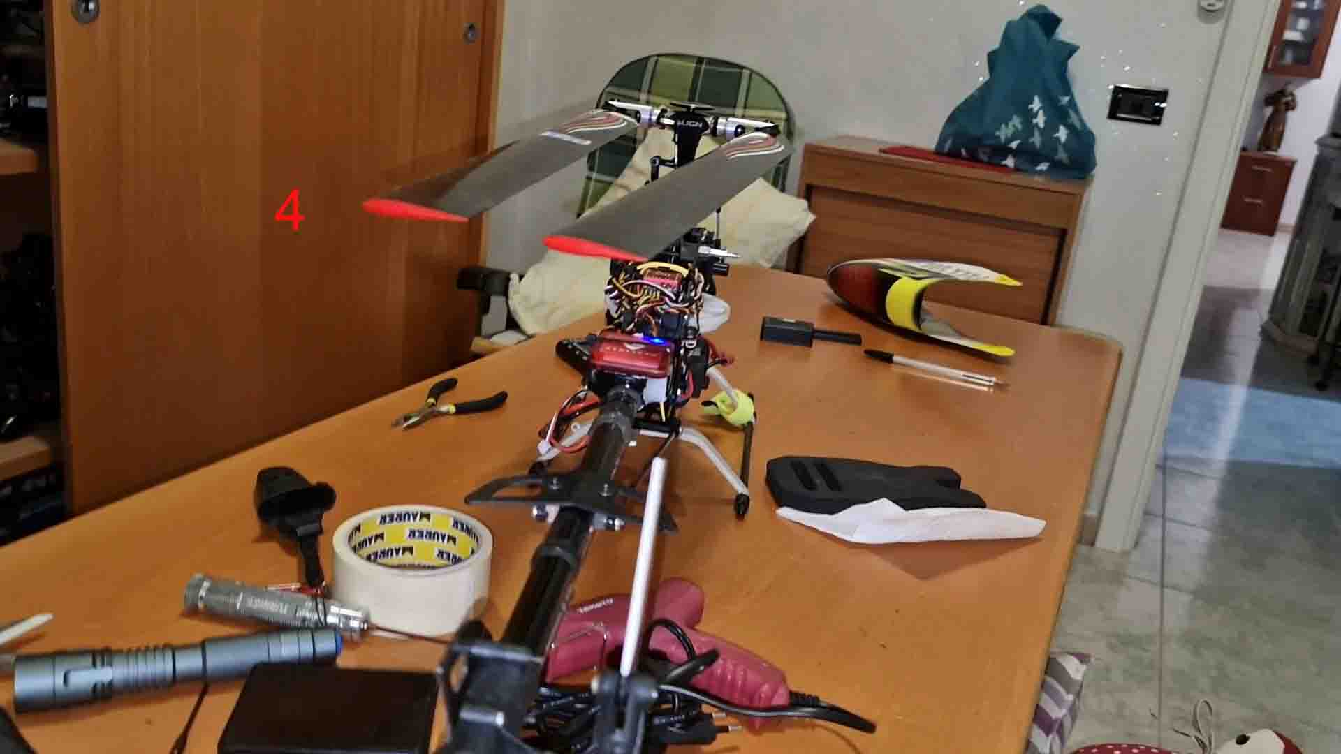

Posts: 12932
in your rotor head I can still see problem.
The 2 push rods that are controlling main blades are still in a very big angle. They should be stright from side you made the photo.
I think the problem is in too short ball that are coming from blade holders.
Your setup looks much better now - 3 push rods are looking nicely, but this one thing still remain to be resolved.

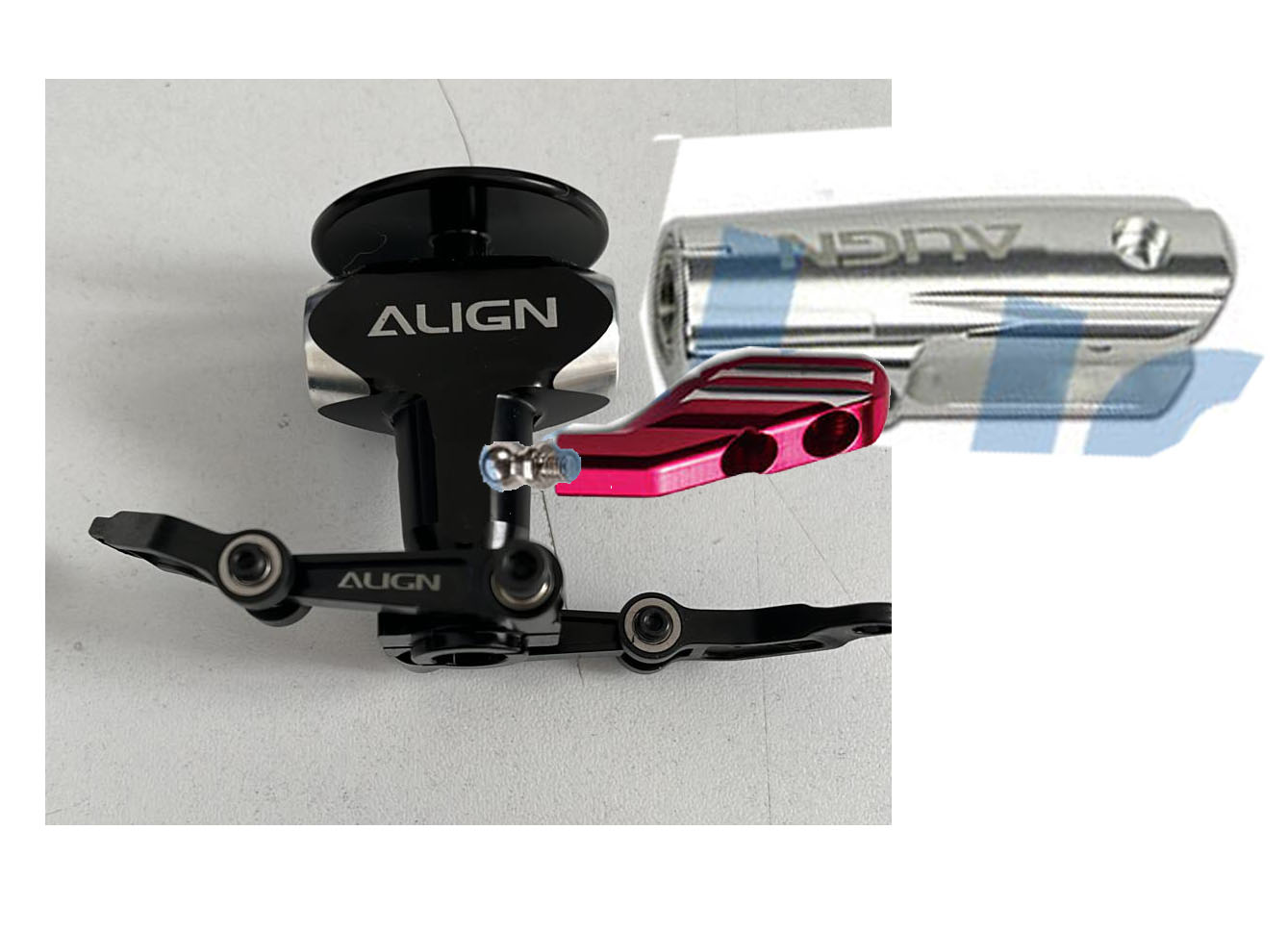

ExCCHP
Posts: 93
Joined: Wed 12. Jan 2022 17:00:01
Location: British Columbia, Canada
Your blade grips should have "Align" printed on them as shown in the picture above. This should be at the top. As others have mentioned you have them installed upside down (reversed). This will orientate the blade links to be on the leading edge. Not the trailing edge as you have now. This is the source of your problem.
