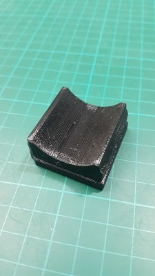

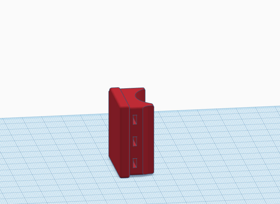

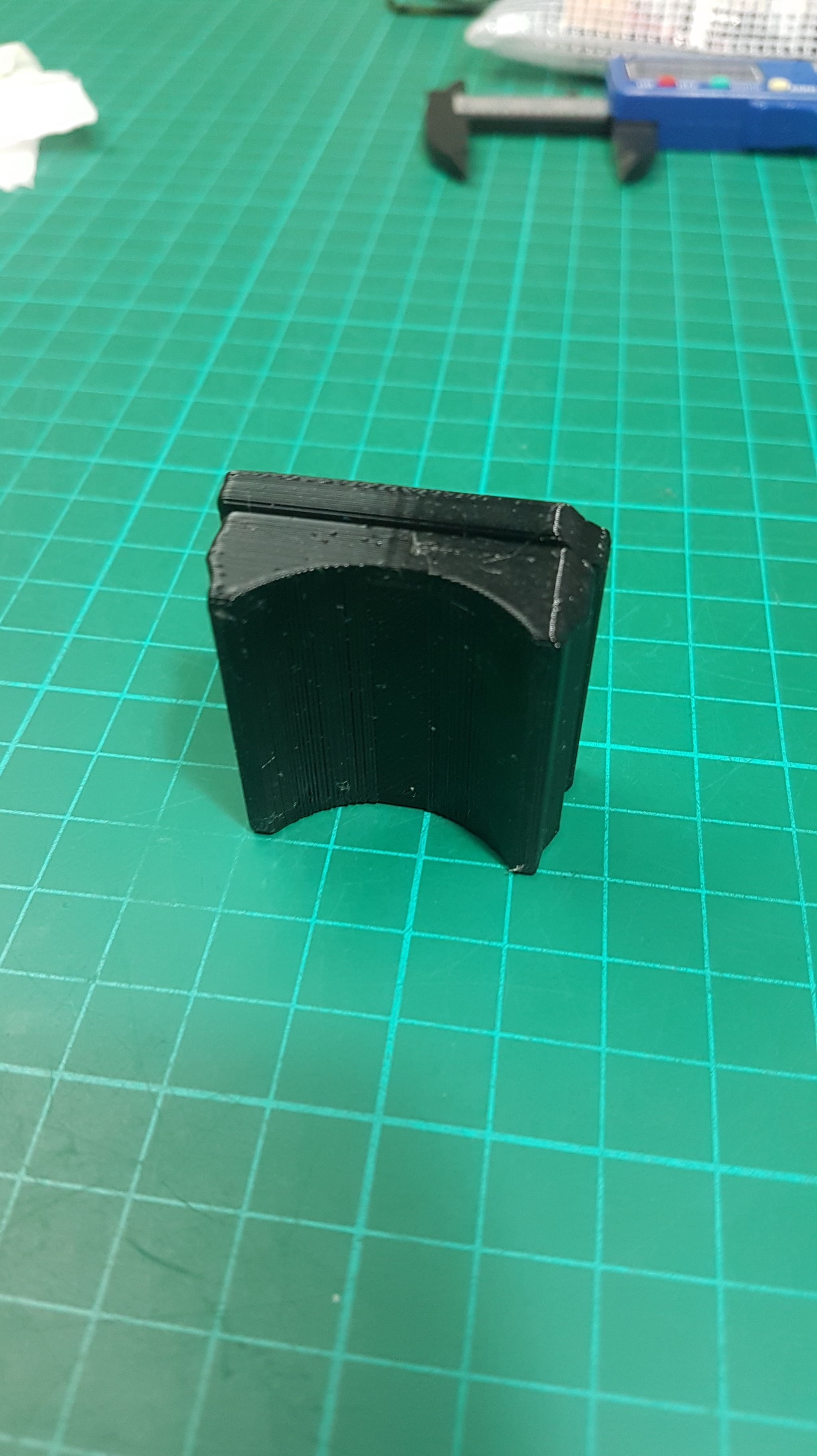

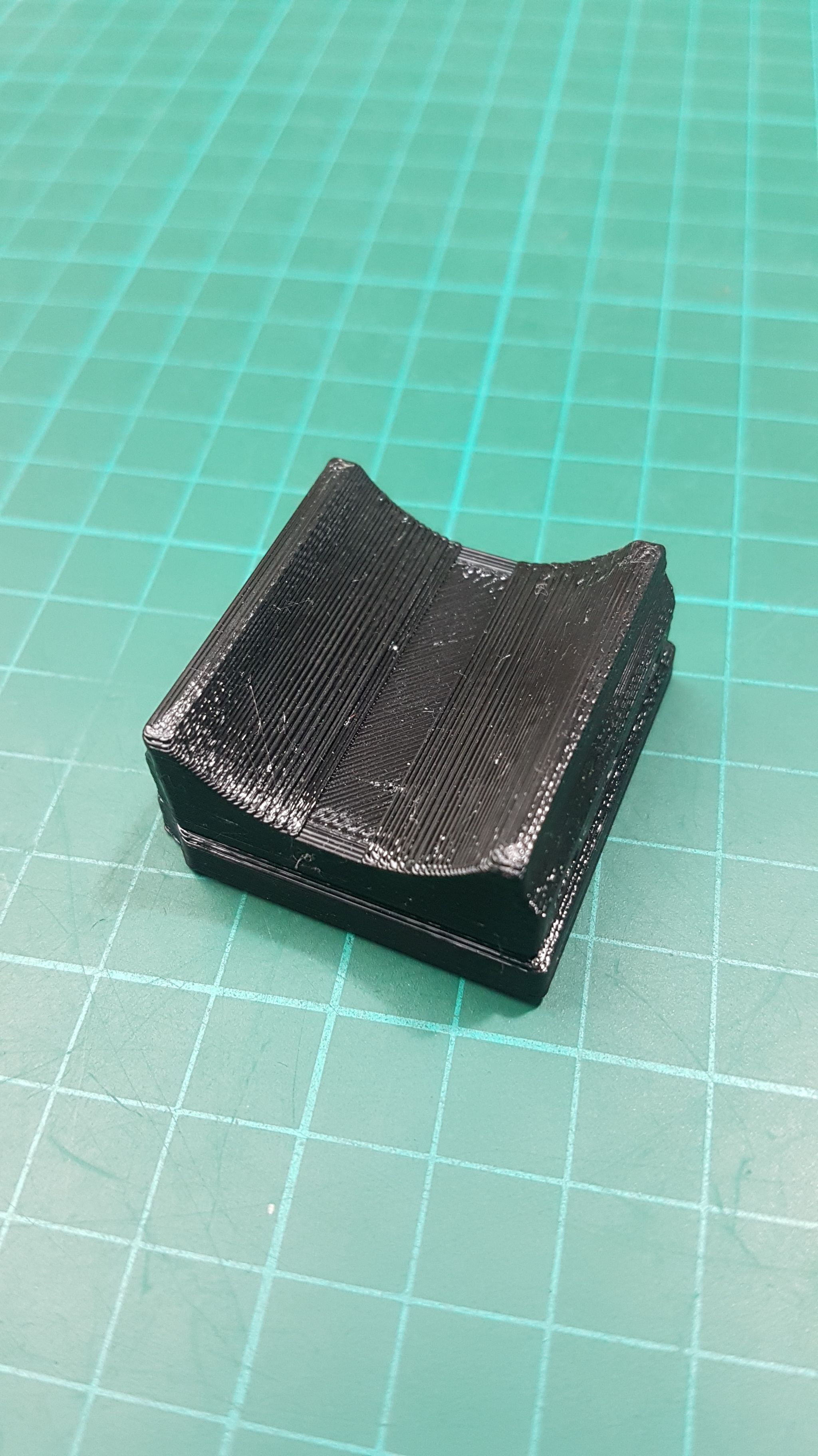

I've created a support for geolink v2 for a goblin raw 580, I also blunted the angle for the laser.

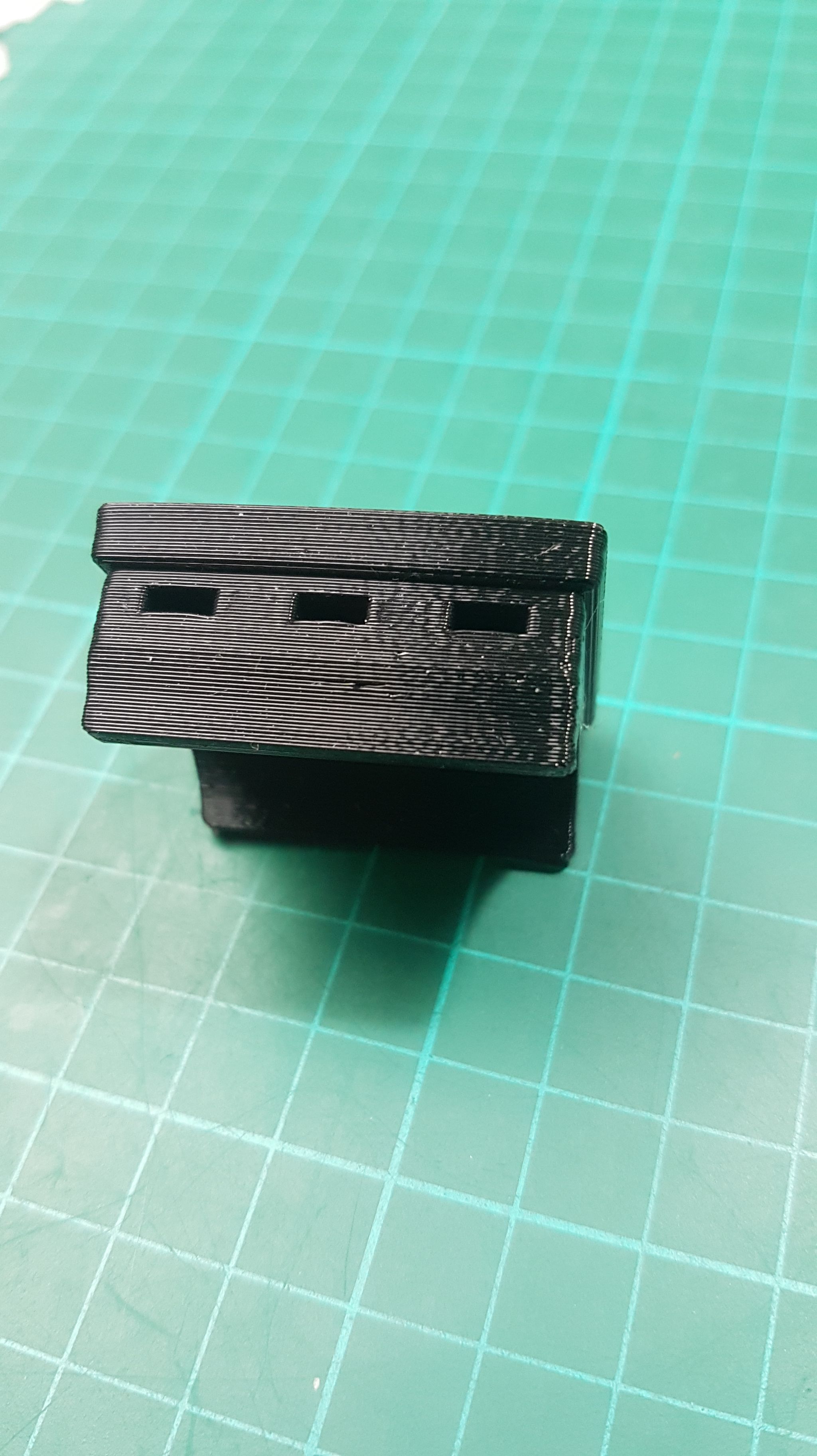

There are 3 holes, 2 to use to maintain the support to the tail boom (30mm is boom, I made it 3mm wider for the bio-adhesive), and the central hole to keep the geolink to the support.
Use tape and electrical ties.

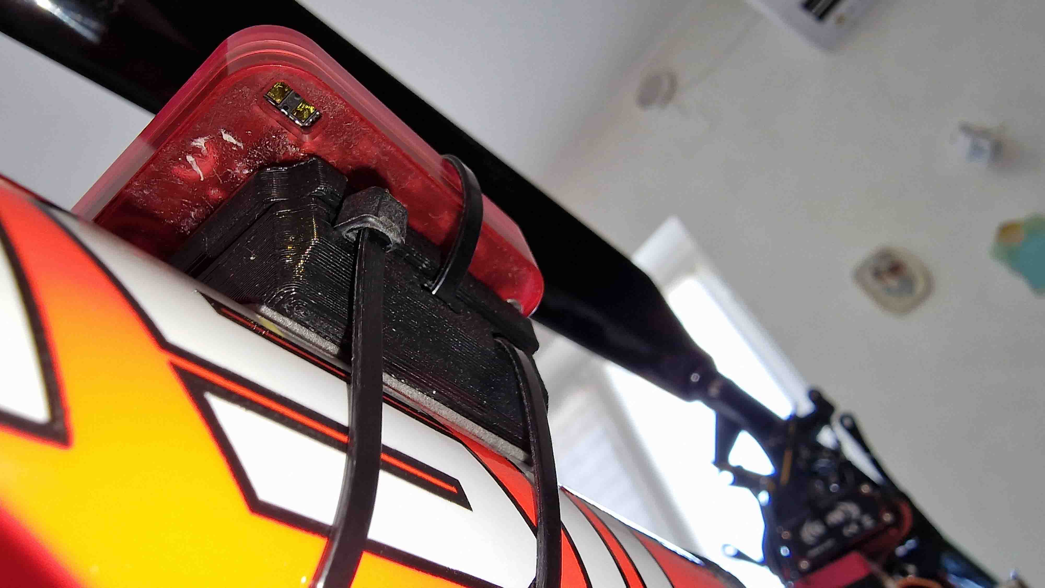

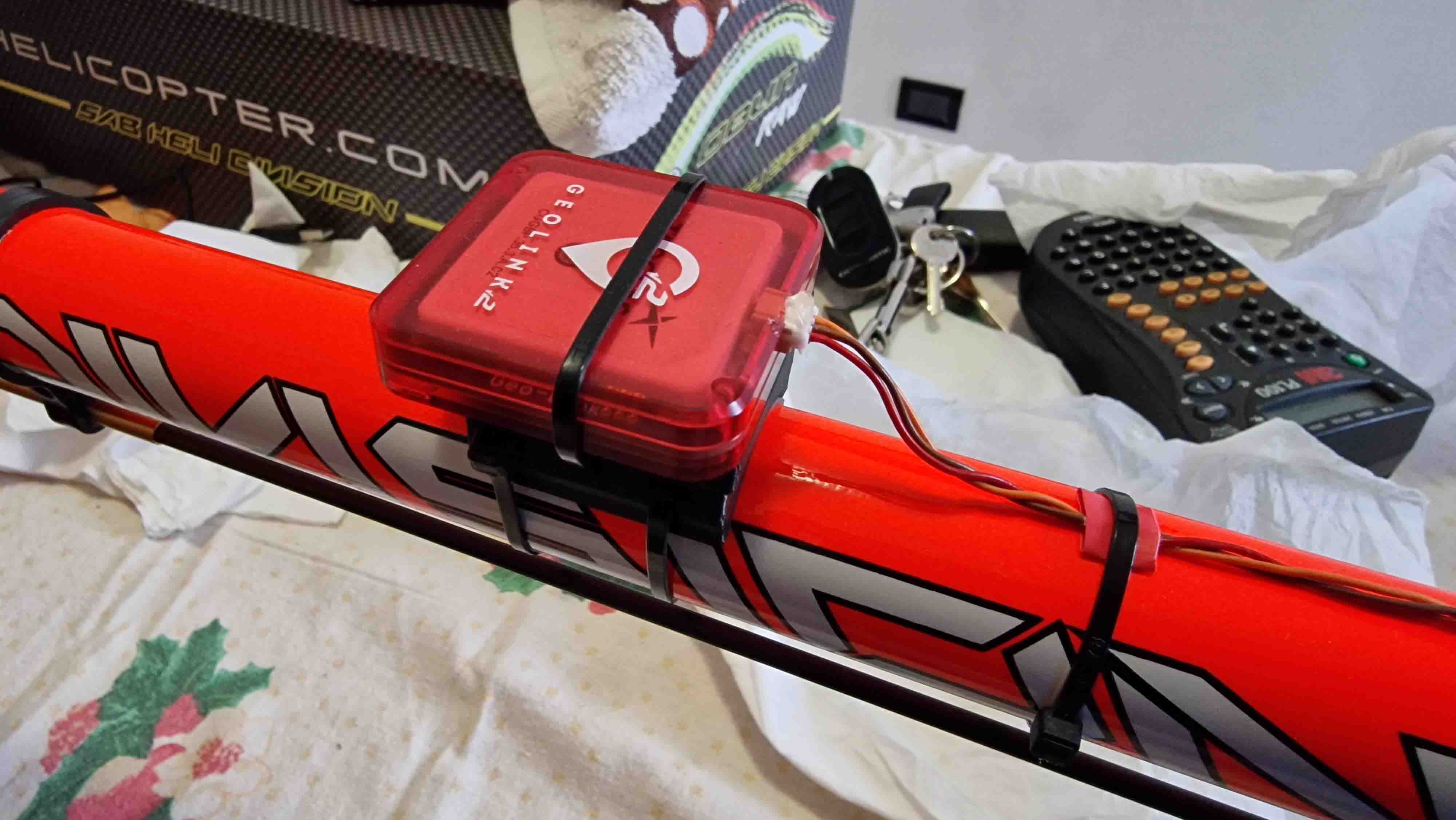

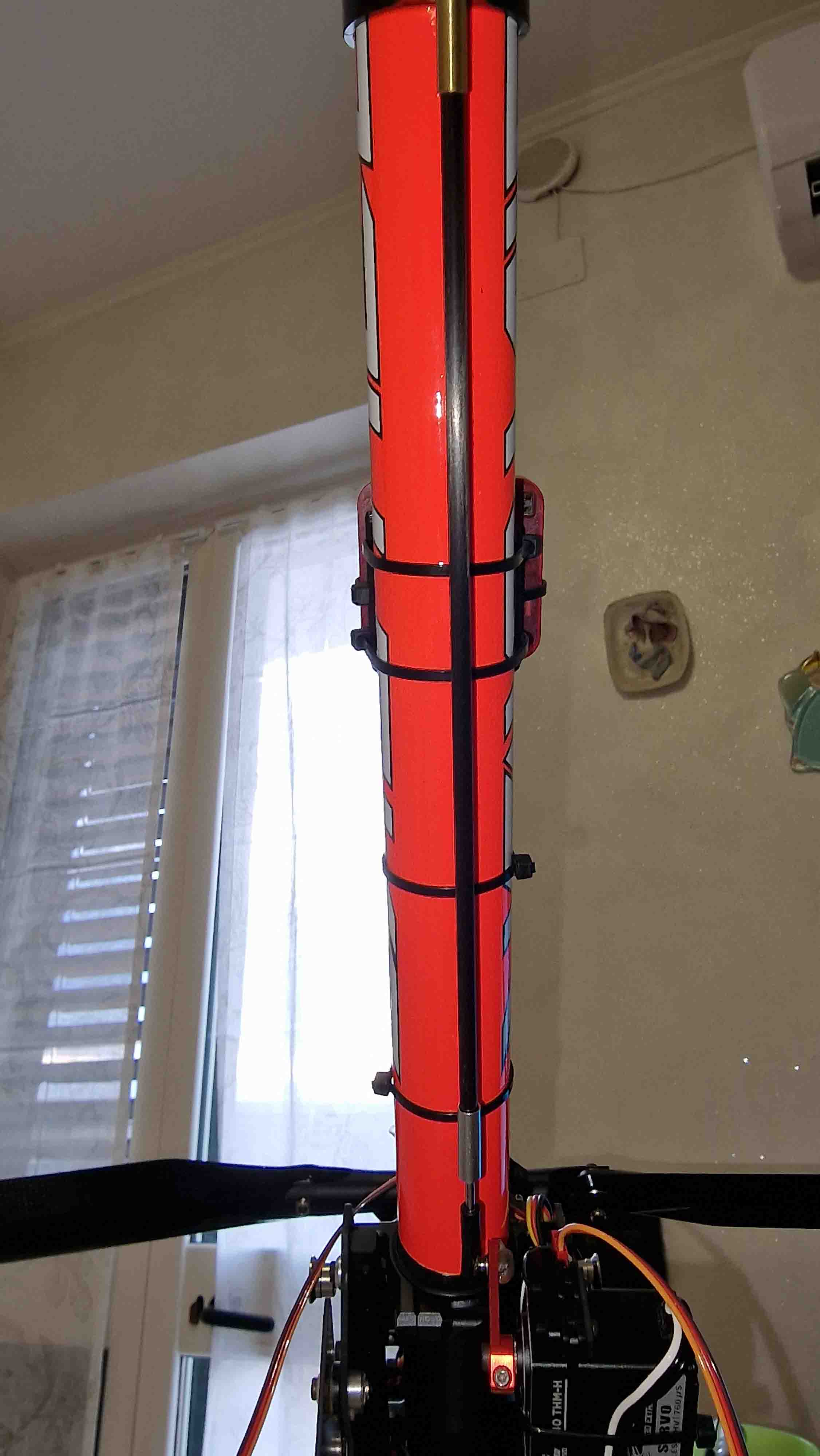

example on how to mount geolinks
PS
on the geolink connector I put some hot glue, I think this is wrong
