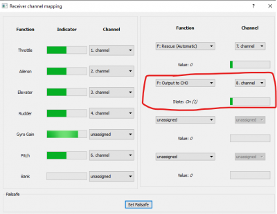

I have an issue where I can't switch on/off the Ch0 Output with Channel 8 of the radio.
I'm using a Spirit GTR with a Jeti DS12.
In the Receiver Output window the state is always 'ON', no matter if I set max negative to -150% or not. It never changes to 'OFF'....(See Screenshot)
Also, if I measure the output voltage on Ch0 it is at 1.25V and 2V respectively, which is also somehow weird.
Did anyone ever had such an issue?
Thanks!

have you tried connecting servo at the Output?
It is not outputting analogue voltage signal, but PWM signal with channel value. So there is no On or Off.

Thanks for clarifying this!
Yes, PWM is at the output.
I had it in my mind, because the Jeti receivers have this function. So, I then misinterpreted the options....
Do you think that this feature could be implemented?
Thank you!
