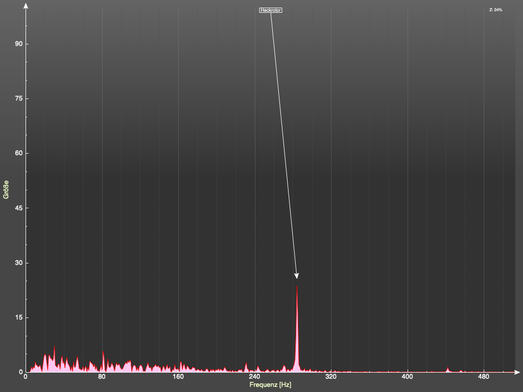

Could you by chance measure vibrations with Spectrum Analysis at Z axis without main blades? Plot from the measurement can help a lot.

here is the requested plot of the Z axis without mainblades:

Posts: 12988
It looks all good. I can check your settings file. Can you share it too?
