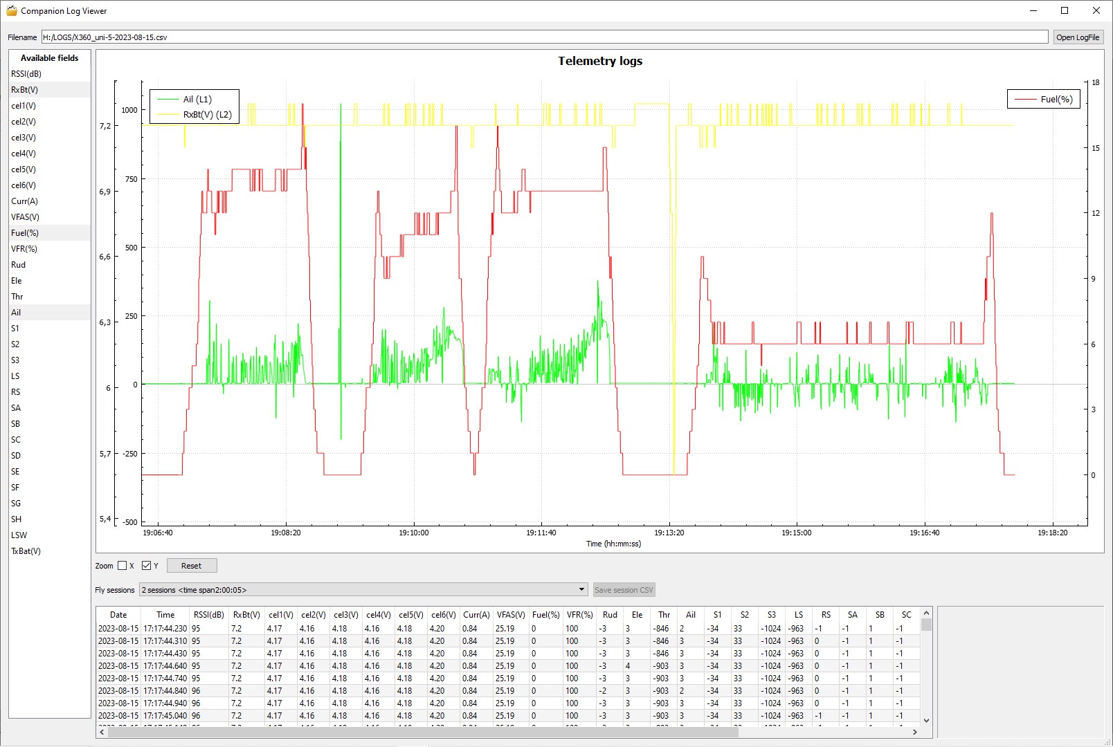

I have a strange problem, every first time I turn on the heli and take off, the heli slowly starts to deviate to the left. the longer this goes on the worse it gets.
Then when I land and take off again it starts again but when I land, disconnect the battery and connect it again and then take off again everything is normal and there are no more abnormalities.
In the attached log file you can see that the first three times the aileron deviates to the left, after disconnecting the battery and taking off again everything is normal.
This log was created on hover only.
