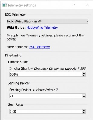

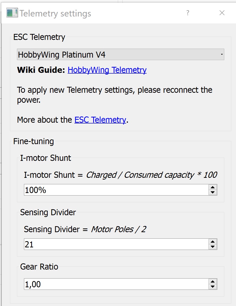

New user of Spirit GTR and Geolink and in process of setting up my Goblin RAW 420.
My question relates to the telemetry settings. I have a Hobbywing V4 installed and wired such that i get RPM back on my Jeti DC24.
in the telemetry section of spirit settings app, what do i enter for Gear Ratio?
My RAW 420 uses a direct drive motor.
The pole count is 42, so i need to enter 21 in sensing divider ( poles /2 ) correct?
Thanks in advance.
Posts: 643
thats not very hard - you have Direct Drive gear ratio is "1" -
Sensing divider is 21 as you said -
Regards !

Thank you, i was hoping that was correct.
