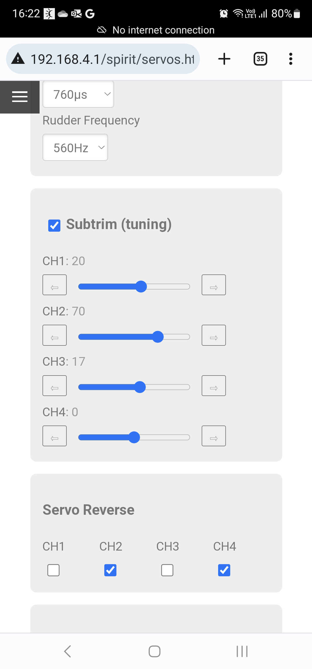

In this heli (see picture), if I move subtrim slider for CH1 to the right, servo goes down. Same with CH2. But for CH3, if sliding to the right, servo moves up.
What is the rule? How does it work?
I can't check it on the PC now (this was wifi link web interface), but I remember that it's always trial and error to figure out, how to move the slider to move the servo in some direction. Could it be consistent, so for example moving to the left always moves servo down?

I also thought so far that it is related to servo reverse. But it doesn't look like.
In situation I described, CH1 and CH2 work same way, and CH3 works opposite. So you could think CH3 is reversed. But this isn't the case. CH2 is reversed, and CH1 and CH3 are not reversed.
So I don't know what logic it uses, but looks like some magic.
And whatever logic it is, could it just work consistently in UI? Spirit certainly knows how to move each servo link up, that's what we set "reverse" for. So it could just be consistent. For example moving slider right always moves servo link up. It would be soooo much easier to adjust.

PC software has directions in relation to a real servo movement when everything is configured correctly.
Wifi-Link software or other integrations have not this possibility due to technical limitations and also the sliders are horizontal. In other words you do not have to care about direction at all. Simply move it in direction where it is needed.

Ok, I see that it is correct on PC.
The problem is, I almost never do it on the PC. Always in the field, with integration scripts or in one of my helis with Wifi.
