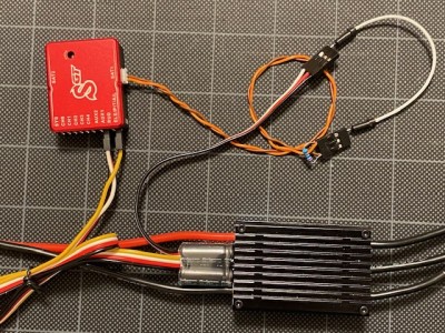

So in the end I got a Flyfun V5 60A, and I can report that telemtry is working with my Spirit GT. However, two small mods were required:

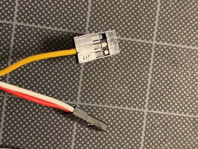

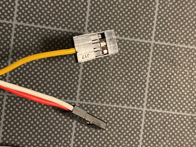

First, the RPM signal comes from the yellow wire that is used for reverse brake signal. That wire's connector is setup as a normal signal wire in the left pin, but Spirit takes the RPM signal on the centre pin of the ELE/PIT/AIL connection, so the wire needs to be moved. Ensure the Brake Type in the ESC is set to something other than reverse. And be careful once you've moved this wire to the centre pin, since the centre pin is usually used for VCC... connecting it to the wrong port on the Spirit GT might damage the ESC?

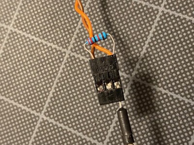

Second, the main telemetry (which includes battery voltage and ESC temperature) comes from the white wire intended to be used for the programming box. And it seems that if that wire is connected when the ESC is powered up, it goes into programming mode and fails to initialize. To fix this, a small pull-down resistor is needed on the signal wire. I found that 22K Ohm was the perfect balance for this -- any higher and the ESC would not initialize; any lower and the telemetry signal would lose too much to ground. This resistor fits nicely across the back of the plug on the Telem UNI connector.
Also, in the Spirit unit, select HobbyWing Platinum V4 as the ESC.

p.s. I didn't bother soldering or otherwise making the resistor more permanently attached. If it falls out during flight, no harm is done since it's only needed to allow the ESC to initialize. And it seems to be pretty snug in there. We'll see how it works in practice...
ESC fully wired.
ESC fully wired.
22K resistor on Telem UNI connector.
Move yellow wire the centre pin.
