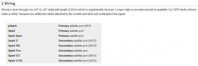

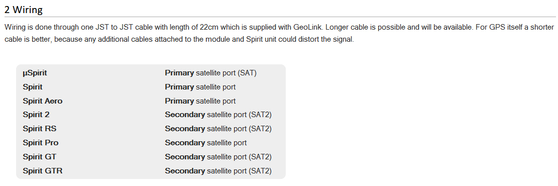

Look in the manual for the geo link here it states the geolink should be connected to sat2 port:
https://manual.spirit-system.com/index. ... k_Mounting
See under point wiring (Spirit GTR):
AndrewJohnHawes
Posts: 150
Joined: Thu 21. Apr 2022 1:34:02
Really good to know, thanks, Mattes61.
I will test the Geolink connection first in Sat1, before changing the ESC to Kontronik Kosmik from the older heli and trying telemetry in the Sat1 socket.
