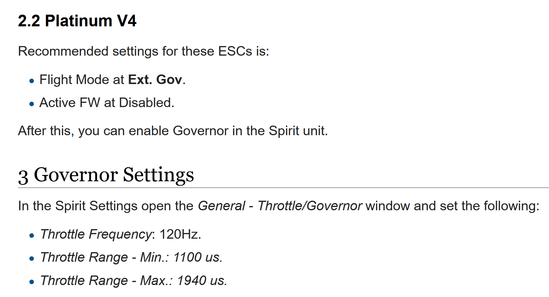

Posts: 637
I would recommend the settings for Platinum V4 Version:
