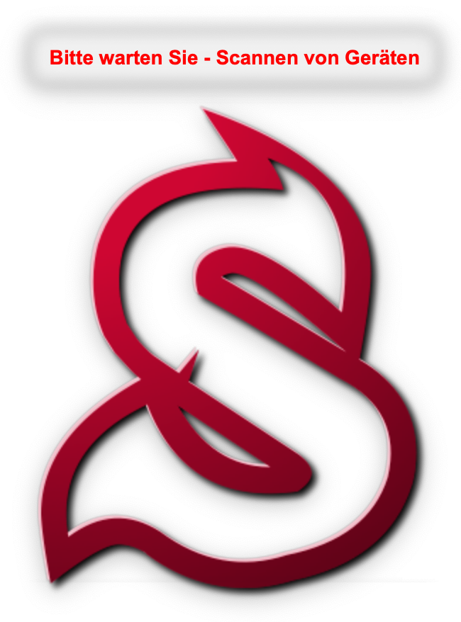

starting the seetings v 3.6.0 on macOS (Ventura 13.6.1) without any device available, it took 29 minutes until I could enter the demo mode.
The software remained in scanning for devices:
With v 3.5.0 it was just some seconds.
With an available device (WiFi), it started as usually.

Posts: 13045
Thank you for the report.
We found the bug and working at fix now. Updated version should be available later today.
We are sorry for the troubles.
Posts: 13045
Problem was fixed. Please download new app revision:
https://www.spirit-system.com/dl/settin ... r2-mac.dmg
It was happening when Wifi-Link was set but not connected with some Macs.
