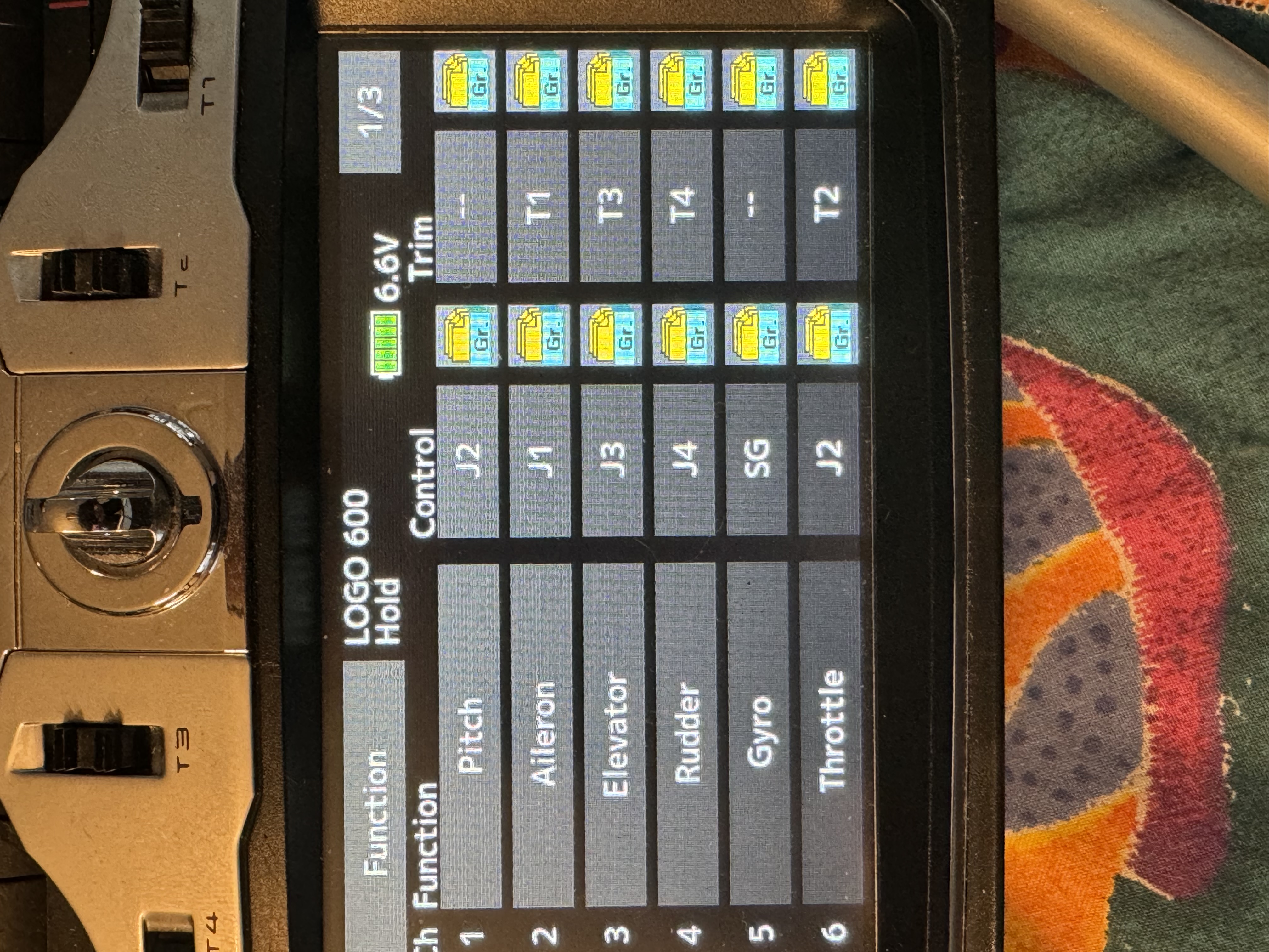

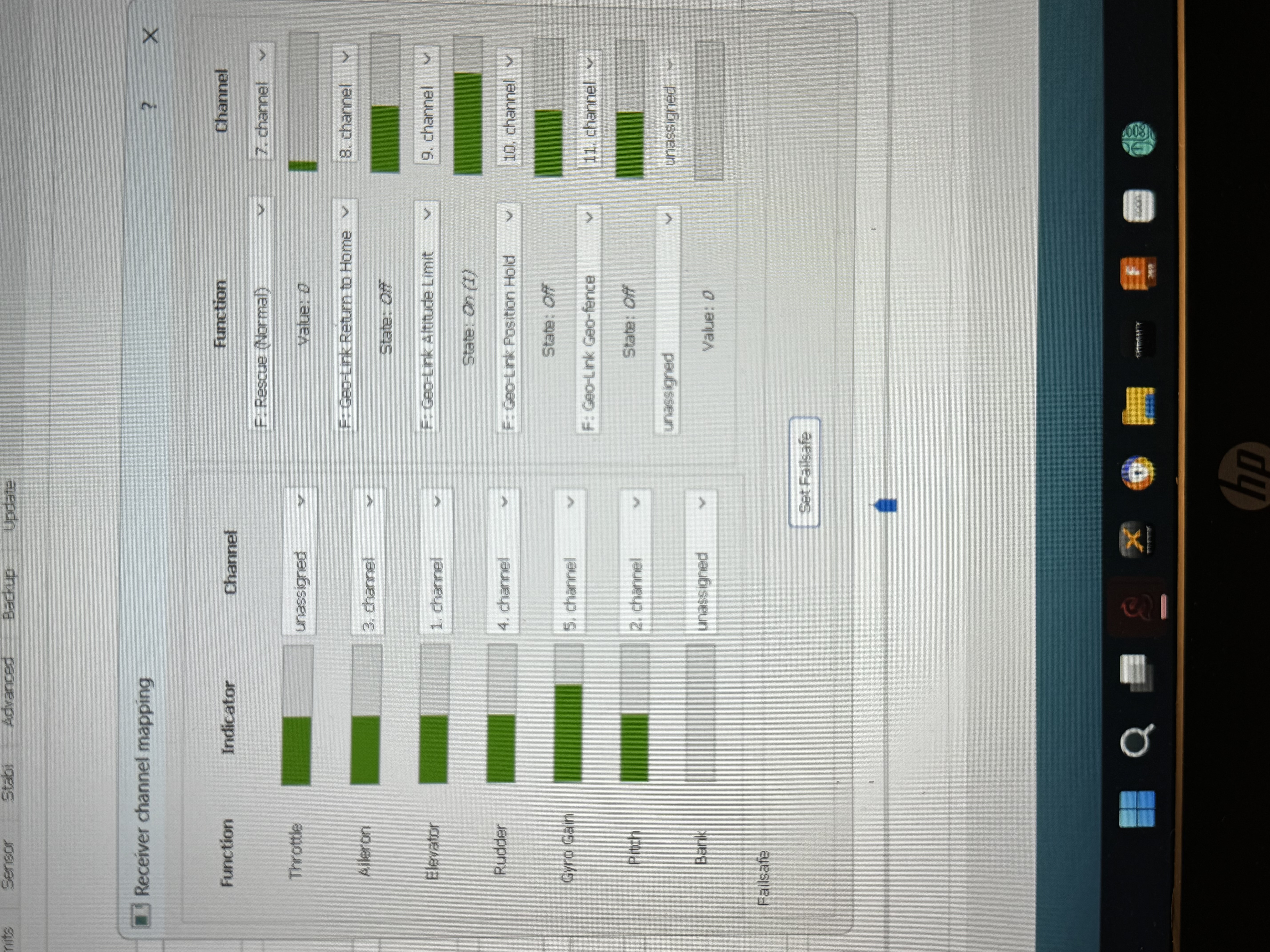

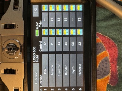

One additional question, does the channel numbering matter for the Spirit?
You can see my channel assignment in the photos.
Regards,
Rolf
Posts: 13045
It is enough to leave base channel mapping (first 6 channels) at defaults at both Spirit and Radio. Then you do not have to change anything and it will just work out of the box without any changes.
So your channel mapping is unusual but if all channels are working well then it does not matter.
Default order is from 1 to 6, where Channel 1 is Throttle. It seems the channel order is not default at both sides now. In any case it should not cause anything wrong.
Thank you for your description. We are testing current version for several months and can't replicate any crashing. So whatever you will find is very helpful.
