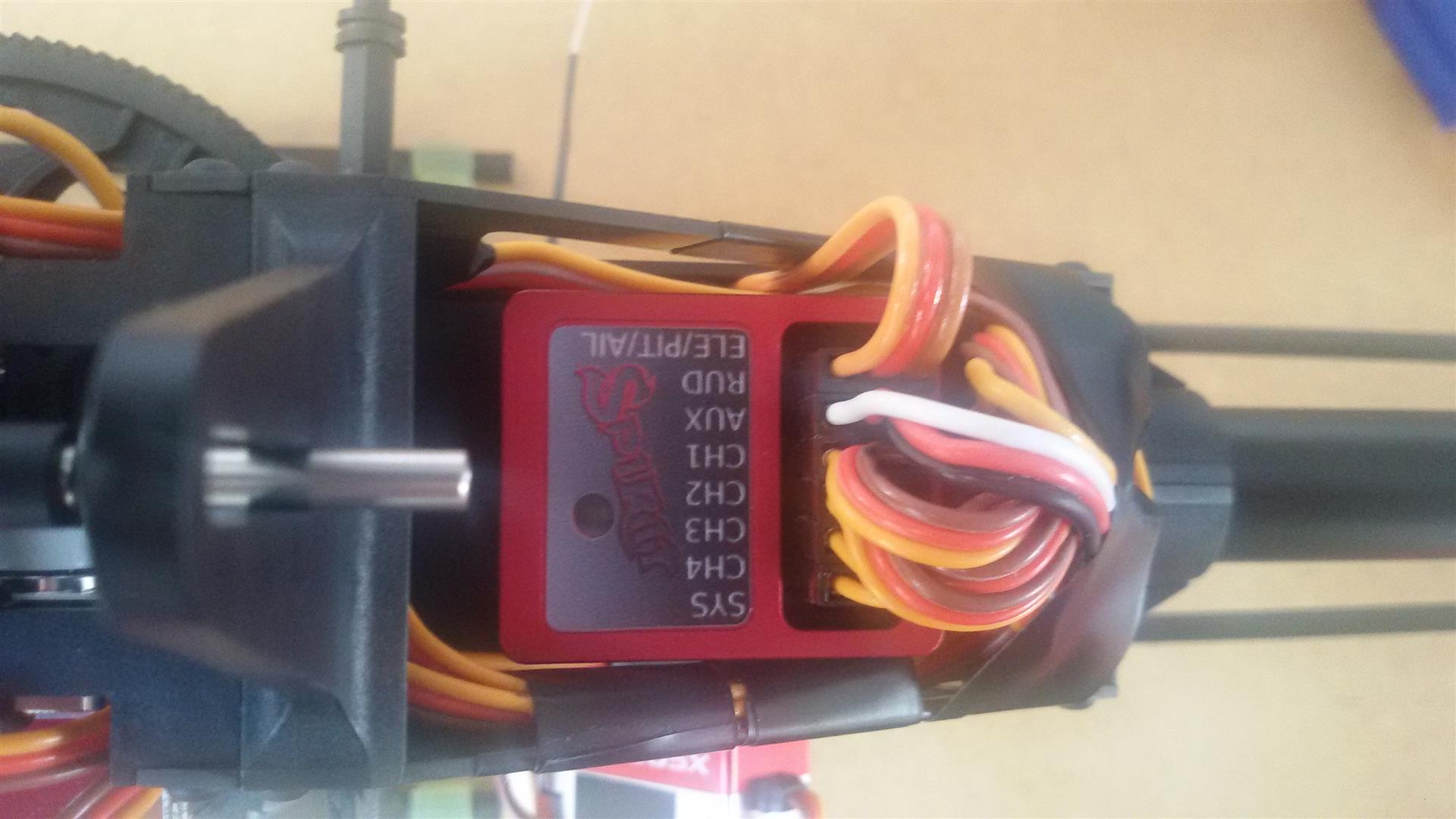

Today I had some time to replace the Mini VBar with the Spirit on my Gaui X3.
My X3 flies perfectly with the Mini VBar, lets see how it goes.
I started with the Setup Wizard and selected the Gaui X3 preset.
It would be nice if you can save settings done at any time.
Handy if you need to quit half way for some reason.
All went well and no big problems.
If you need direction reversal, the software should tell you if you need the TX.
I had to think a few times if TX reversing is allowed or not.
I use Futaba S-Bus and have my ESC/BEC cable connected to the AUX port. (HobbyWing V3 50A)
So I needed to add the throttle signal with the Spirit software.
It was a bit confusing it worked when I selected "Throttle 1. channel".
Using Futaba, throttle is on channel 3, so that is what I selected first.
That gave a funny effect. :roll:
When I arrived at "Pirouette optimization" it wasn't clear where to look for exactly.
Something similar is needed in the VBar, so I used my experience with that and selected reverse for my setup.
Otherwise I left most stuff at default.
I changed "Rudder delay = 2", because I use a KST BLS505X @ 7.4V (0.04sec/60)
I changed "Flight style: 2"
Before I go out for the first time I added my settings file.
I hope ZeXx86 can take a look and tell me if I did something really stupid. :mrgreen:
Thx!
Oh, the color of the Spirit matches great with the Gaui colors. :)
