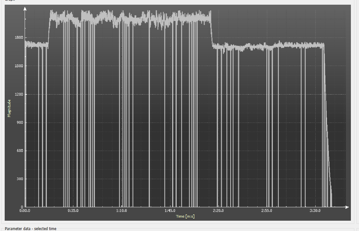

I just played arround with the RPM telemetrie.
Is it normal that i sometimes see the RPM signal as 0 ?
See attached Scrreenshot.
At the moment i use the govenor of the ESC (Hobbywing 200A Opto)
IT´s connected via telemetiry and RPM cable (with the HOBBYWING-Signal-Coupler-Modul)
Not sure the Logs shows the telmetrie DATA or the RPM Signal Data.
Hope somebody has an idea?

Helo,
log is showing RPM cable signal.
Can you disconnect the RPM cable and check again the log?
This problem could happen if signal is very weak or there is interference. It must be routed carefully, not near a source of interference.

OK - it works fine with RPM disconnected and just the telemetrie data.
I suppose it must be the RPM Copler Mudle from the hobbywing esc
