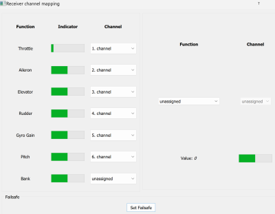

I have to connect spirit gt with frsky x8r with s.bus and connect at my tx16s mk2 max.
To have no problems with the system flybarless how should I do this?
I create Pitchcurve and this curve it is better to associate at page INPUT or at page MIXER ? (can be associated as you wish)
pitch curve must be associated only on channel 6? (channel pitch)
there are multiple methods but I want to use the correct system
Posts: 643
look at Futaba-SBus in Manual:
https://manual.spirit-system.com/index. ... S_RECEIVER
In my opinion you have to take at Mixer the pitch curve and other curves you need -
Input represents only your inputs as sticks and/or switches or other channels, there can be made some expo or reduced throws - Nothing special -
In EdgeTX/OpenTX you have many different ways to do some tasks and there are not really false ways to do it, it is only personel preference -

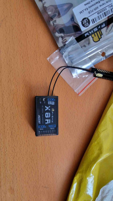

receiver frsky x8r Zexx86 she has arrived.
I connect with S.BUS to spirit gt and in the software spirit i set futaba s.bus
But the binding with receiver I have to create it in mode frsky
Yes, this is all correct.
Use Futaba S.BUS receiver type in the Spirit Settings.
In radio use FrSky D16 modulation.

Listen me, in diagnostic I have the green bar movement Rudder in the correct direction
on the right the green bar when I move the stick to the right
on the left the green bar when I move the stick to the left
but the movement of the servo tail it's incorrect.
If the green bars are moving in the right direction the movement of the servo shouldn't that be correct?
HeliMLM
Posts: 370
franz88 wrote:...
just follow the setup process step by step as per manual / wizzard: first the green bars have to be correct direction > this means TX>Spirit is set up correctly. next step in the setup is the servo reversals > here you would i.e. reverse the tail servo if direction is wrong.

If I move end point on my radio for you I have to run it again the re-calibration esc ? (Min stick and max stick )?
First- all endpoints should be +/- 100% in Diagnostic tab. Not more. Spirit will not ouput more tan what is set as Range.
But it is better to recalibrate to be sure it is OK - with Spirit Governor Off.
Or even better if ESC is resetted there is no need to calibrate with Spirit.
Only set 1100 - 1940us in Spirit and it will match perfectly.

I would like that if my helicopter loses radio signal return home of the geolink is activated.
I would like to use the spirit failsafe although I don't understand how it works.
The failsafe spirit takes into consideration channel 7 if i use channel 7 for activate return to home?
or failsafe spirit does it only consider channels 1 to 6?
However if I activate it after Can I never turn it off again?
I saw that there is a button to activate failsafe in channels but I don't see a way to deactivate it?
Why if I don't like how he behaves I would like to deactivate it Instead if everything behaves the way I want only in that case I'll leave it on.
