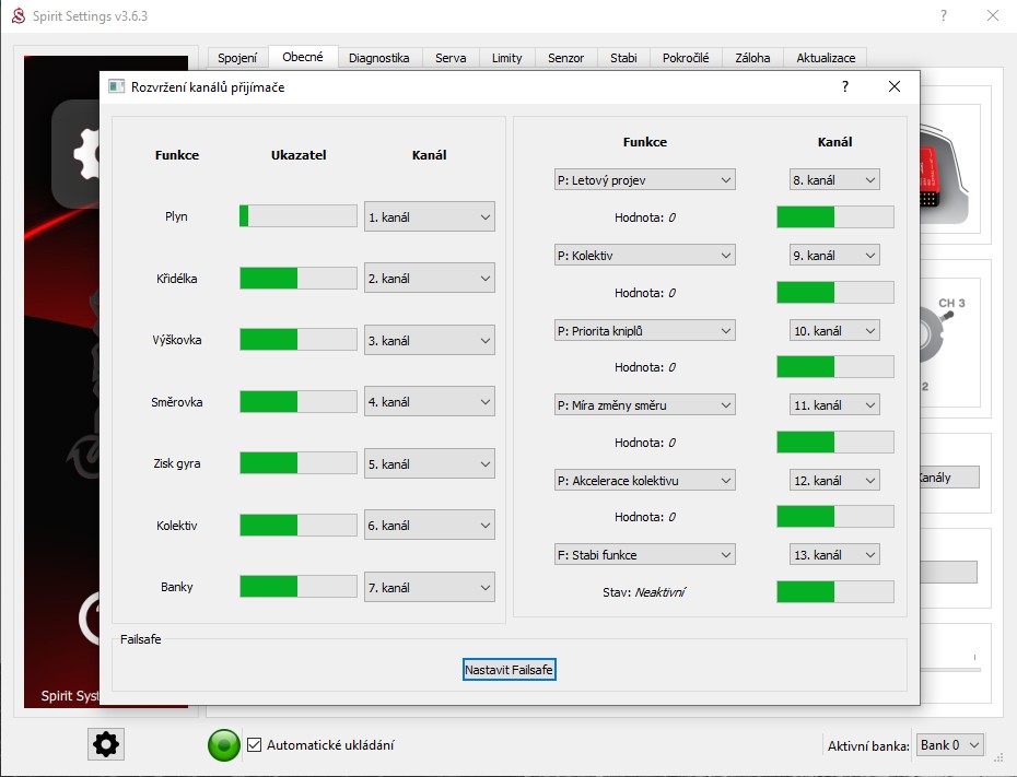

I got my spirit gt today, and spending a lot of time trying to figure out how to get all the flight modes. I have a elrs rec with crsf working, but only see 12 channels available in the channel mapping window. I see that I can select up to channel 16, but the screen only shows 12 functions, I am thinking if I select another, it overwrites what was there, this is confusing.
Also confusing is the idea of selecting different modes of a single function, such as stabilization, by changing the bank. I would like to do that to get more flight modes available, and in a very early post, you said it can be done, but the software seems to protect against it for safety? Banks 1 and 2 have the channels selection greyed out. How to do this?
I would like clear instructions how to get all available operating modes with a 16 channel receiver, or how to get the most possible.

13 channels can be used at this moment. In the future, another 3 should be added for a total of 16.
Channel BANK is usually on ch7, is that right?

OK, yes I am getting 13. Well, that is not near enough to use all the features/modes you provide, as 1/2 of those channels are used for flight sticks and mode switches. I would like to request all 16 channels be added asap, that is what I reasonably expected for my money. That could be done on the same screen with a slider or other method.
You only addressed 1/2 of my inquiry. Again, what remains is: how are flight modes changed across banks, it is unclear if that is available, the config tool does not seem to support that, but it was mentioned -- as I said before -- in previous old posts and elsewhere as an available feature. Has that been changed, or what is the situation to get more flight modes with bank switching?? I do see that could be a little dangerous, and needs be done by the user very carefully, and I am a little uneasy with that, but something needs be done to get all features available! Therefore I am not surprised if this feature is discontinued, or never available on this GT product, but this needs clarification.

Hello, I understand what you are saying, but I'm just not experiencing all that wonderfulness right away. You should understand I am spending a lot of time on this, and I'm a bit frustrated. My questions are not being addressed fully. I have only 13 channels available, and half of those are for sticks and required control. I want to add GeoLink, but I am having trouble liking this company right now. Argumentative responses are not helpful. The Spirit app does not allow bank selection in demo mode, I just noticed. I did play with this some before making my decision, but it looks like I could not have noticed. When I connect up my heli, and select bank1 on the General page, the Channels button greys out, preventing me from selecting new functions/flight modes on the same channel in another bank.
Am I missing something? Any helpful response appreciated.
