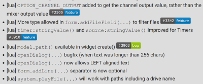

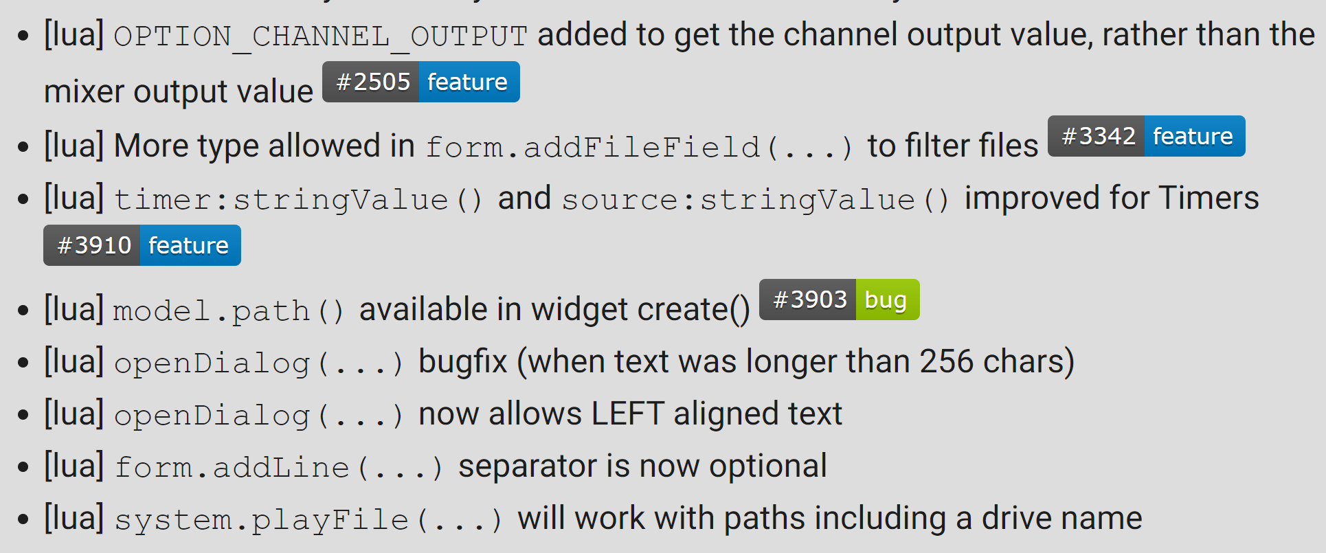

A long time ago in an other thread also asked from other people - The infomation for you is maybe relevant to change the lua script, the integration works perfect with ETHOS 1.5.7 but with ETHOS 1.5.8 and ETHOS 1.5.9 it doesn't work anymore I think FrSky have changed some in lua and therefore the lua doesn't work anymore - parallel I have an inquiry in an other Forum what have been changed from 1.5.7 to 1.5.8 and 1.5.9 - I hope I get some answers from there -
Matthias
I don't know if this helps in advance...
Here an screenshot from changes in ETHOS 1.5.8:
