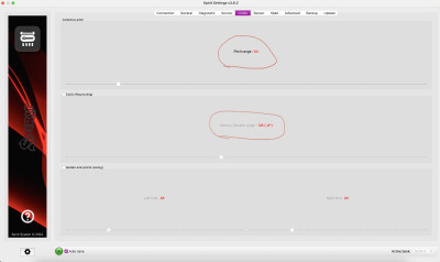

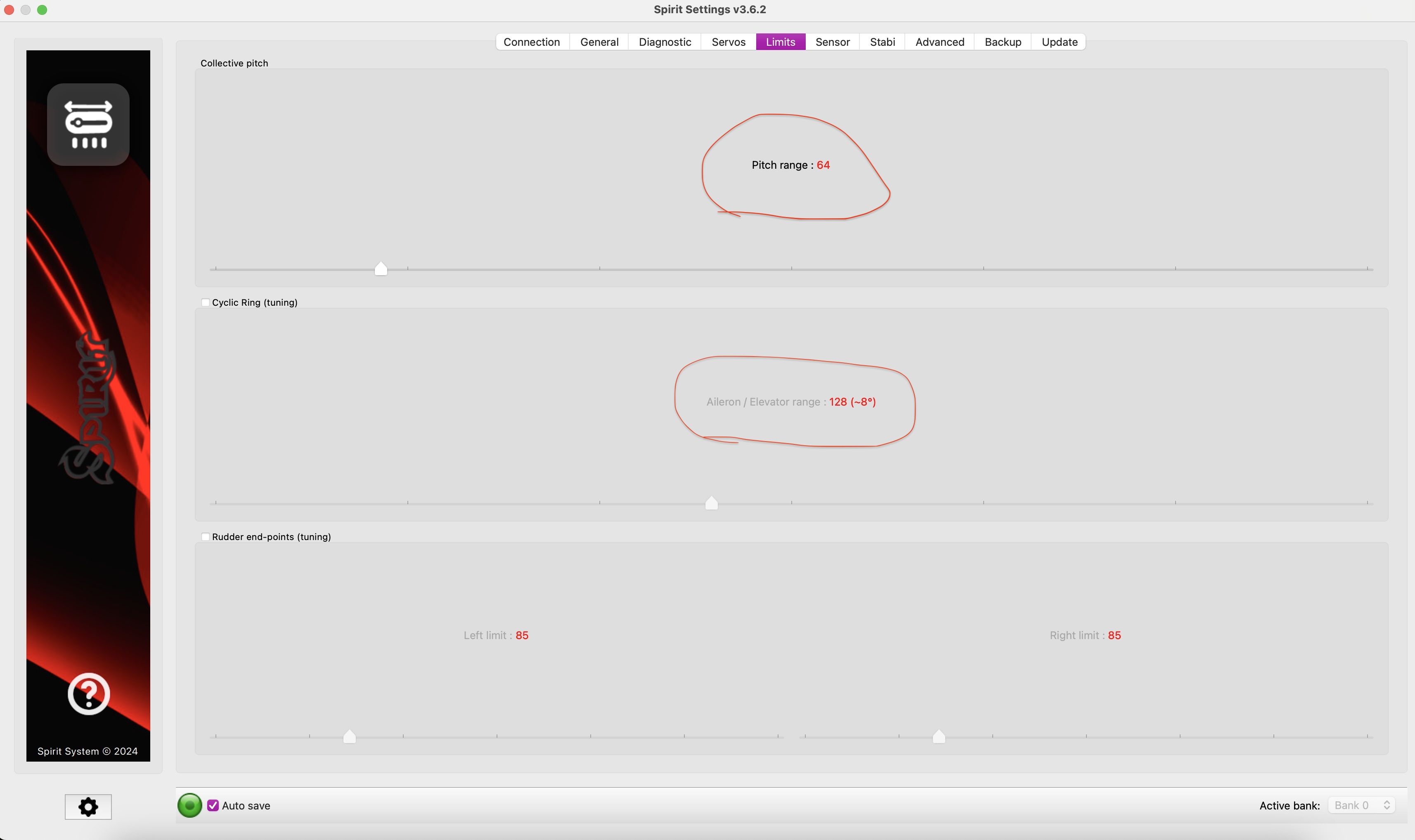

Got a used RS4 model with Nexspor servo's I'm trying to set up with Spirit and ran into an issue I haven't dealt with before - these servos have a very limited operating range (about 80 degrees total throw) and the swash linkages can't move further out on the servo arm due to lack of clearance.
When I set the recommended collective pitch range of 11° there is almost no movement left at the top/bottom. So if I increase cyclic pitch range beyond 6 degrees I don't have the full range of motion at full positive/negative collective. There is no binding, but the servos just don't move further, so if I push the cyclic stick and then go to full positive/negative collective the swashplate flattens out. Surely this is undesirable? Are these servos just trash, is RS4 geometry poorly designed or how am I supposed to deal with this?

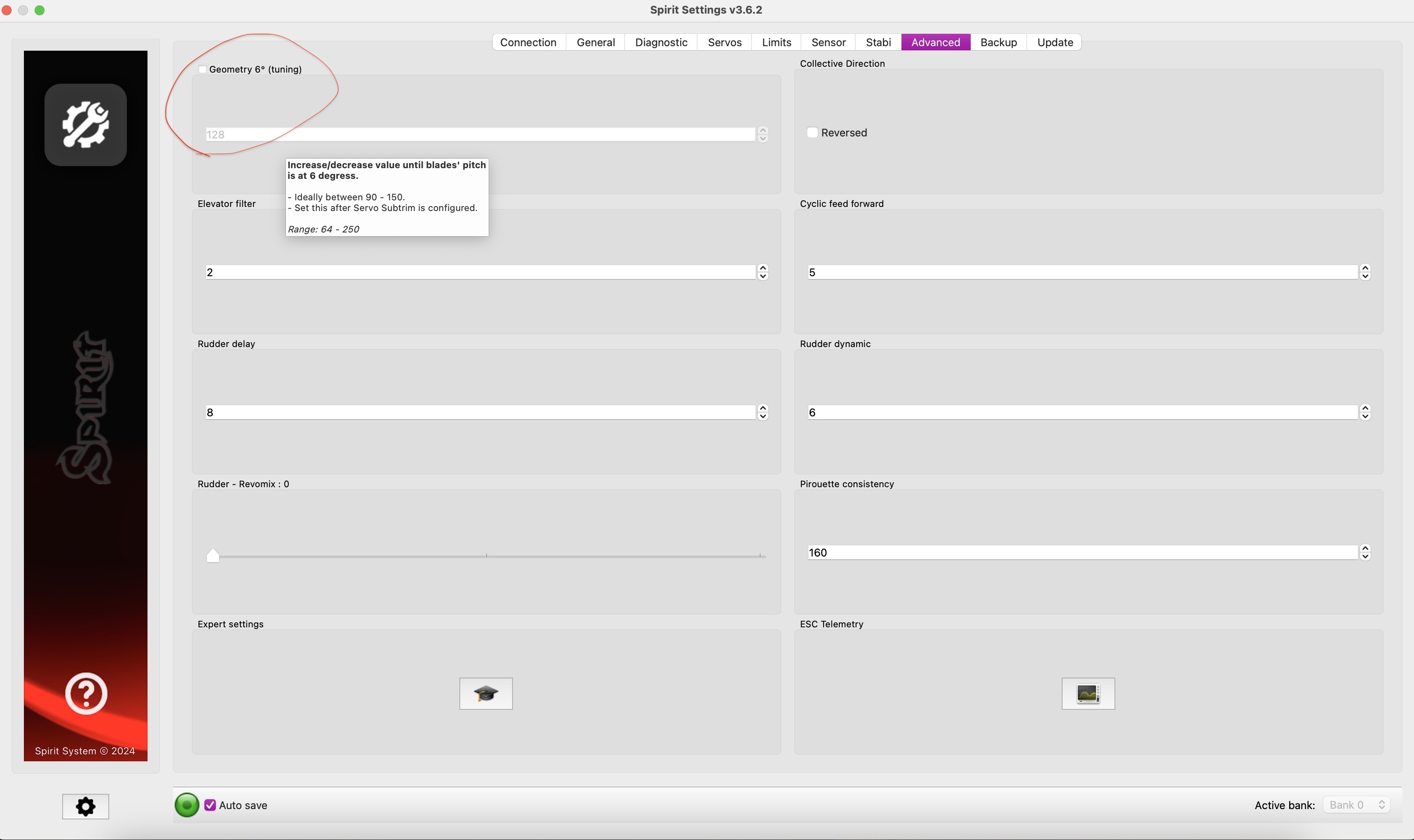

I am not sure I understand 100% what you are observing. I would start by verifying the 6° calibration number ends up in the "90 to 150" range, as this tells you whether or not you chose the correct length cyclic servo arm holes. Then optimize the "Collective pitch" range and "Cyclic Ring (tuning)" range.

But at first you have to set the geometry 6° tuning correctly, then the wanted pitch and the wanted cyclic ring - I hope you have set correctly the subtrim and the you should get at this position zero pitch at the blades -
Also it make no sense to have +- 11° pitch and only 6° cyclic ring - you have to set the cyclic ring also in the range of say of 9 - 11°, but this is dependend on your mechanics - you shall test this that you have no binding in any position max. positive/ zero/ max neg. pitch that you are safe to have no binding -

The 6° tuning is in the normal range and I get the full -100%/+100% on all channels in the diagnostic page.

So at full positive/negative collective (+/-11°) there is almost no room for cyclic movement because it already puts the servos at their limits.
