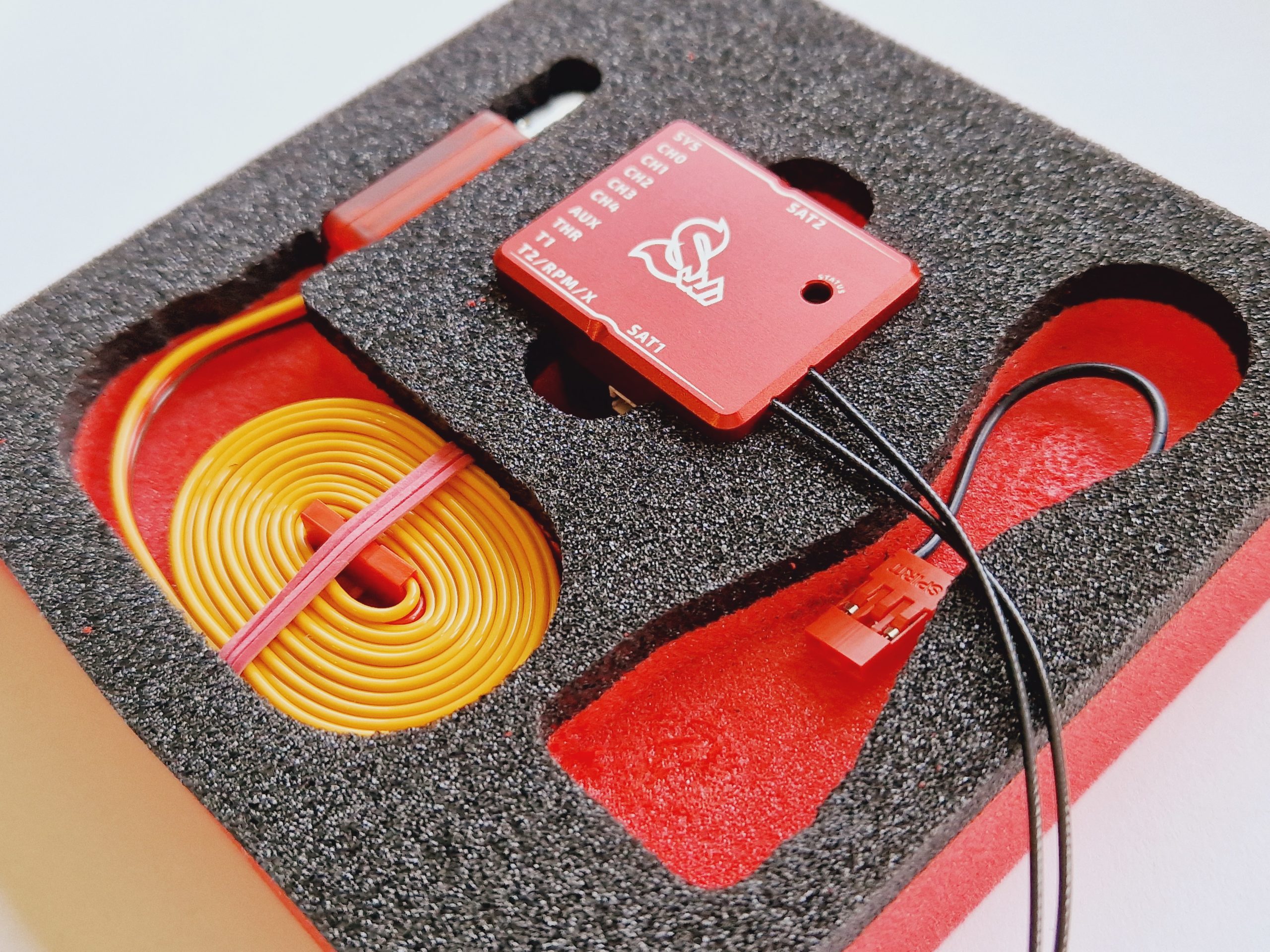

Showing a bind plug in the picture...
attachment=0]20240731_112608-scaled.jpg[/attachment]
