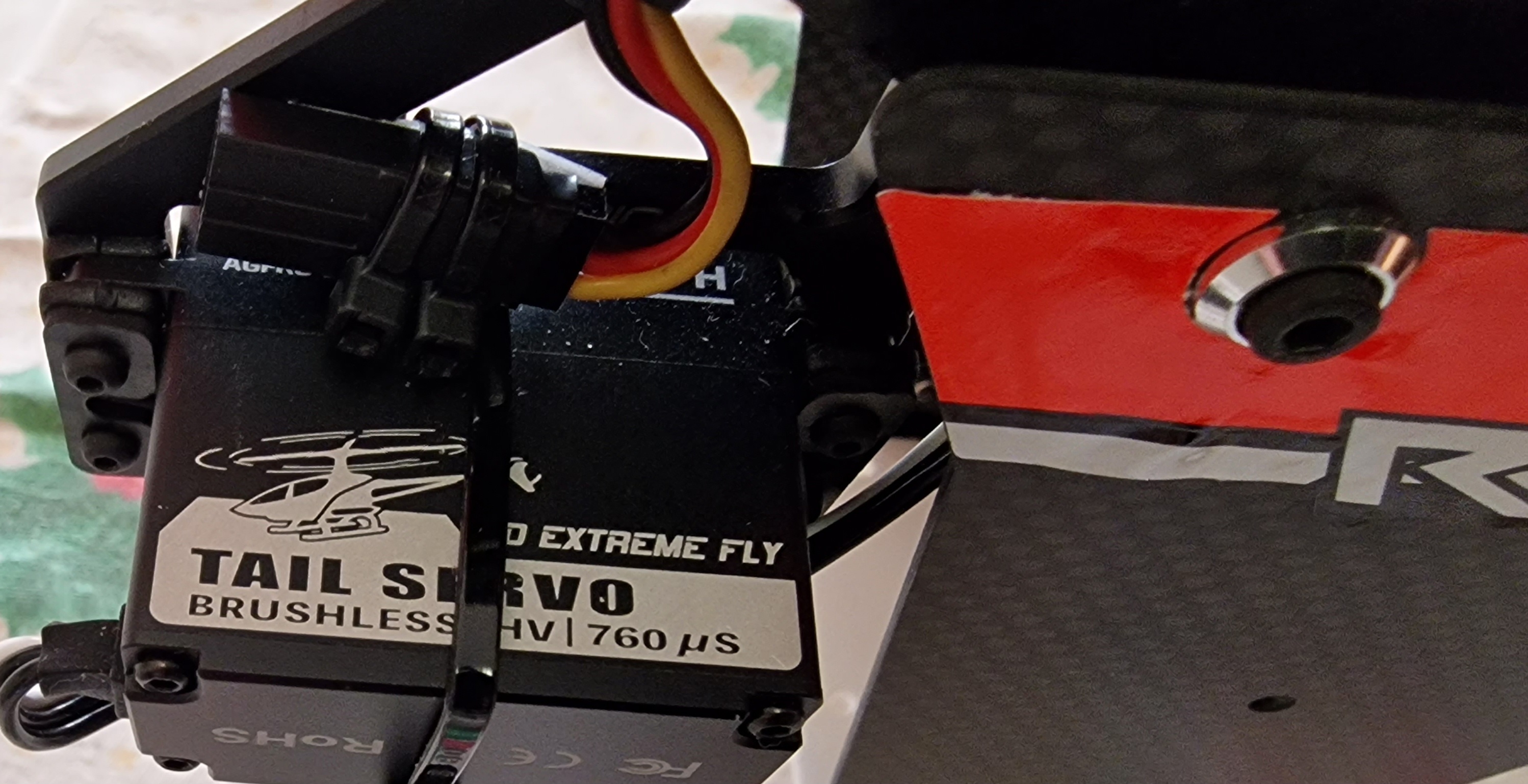

Why not use this?
One extension servo always fix identica to me?
ajadda
Posts: 148
with an extension, I would have one more contact point when operating the WiFi link, which I always have connected. I also want to keep the cables out of sight as much as possible.
If a solution could be found by extending the timeout period for an update, that would be my preferred solution.

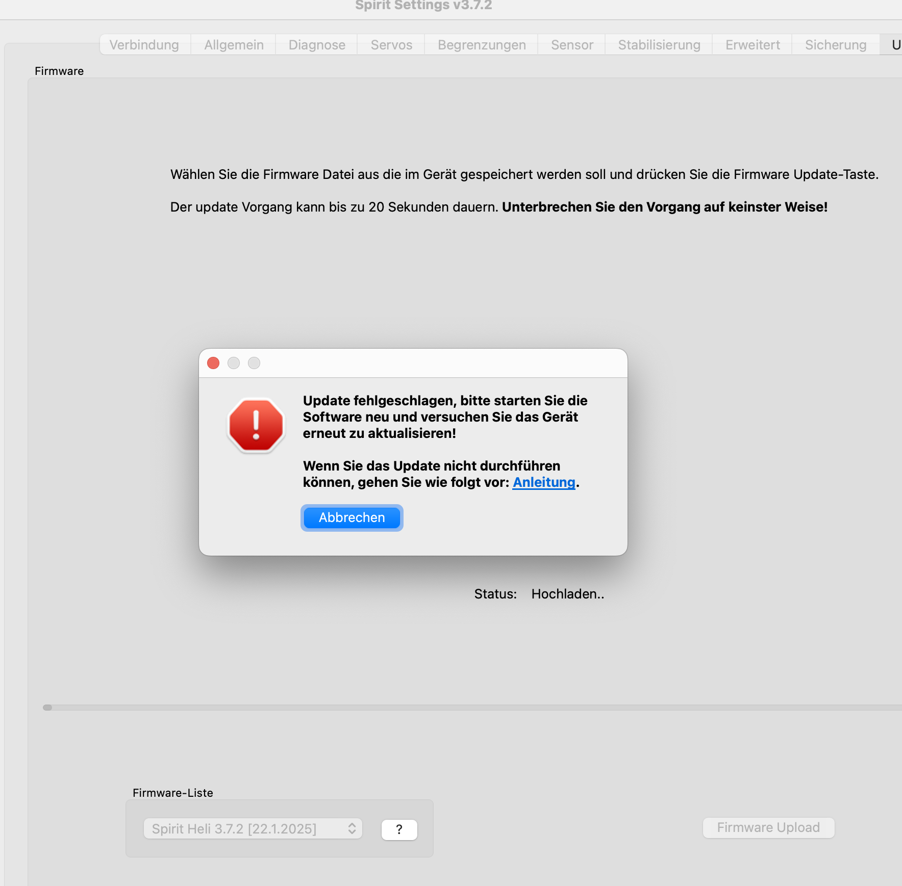

yes, even with version 3.7.2 the problem still exists.
I have just updated all my Spirits with settings 3.7.2. I have tried different Macs in different locations.
I normally connect via 192.168.4.1, as I did today. After unsuccessful updates, I also initiated the recovery via WiFi and was unsuccessful many times until, with a lot of patience, it finally went through completely.
On the second GT I used my home network - no difference.
On the third GT again via 192.168.4.1 for a very long time without success until the recovery was successful. Mostly the recovery failed very early or after a short time.
Surprisingly, the updates via Wifi on the Spirit Pro, red and black Spirit, as well as the µSpirit were also unsuccessful with one exception, but the recovery via WiFi almost always worked the first time.

Since I cannot currently use settings (Version 3.7.4) under macos via WiFi, I have temporarily switched to a virtual Windows on my Mac.
Surprisingly, the update via WiFi works much faster here than directly under macos. Under Windows, even the Spirit GTs can be updated via WiFi in well under 30 seconds and there is no timeout.
I can't update my GTs via settings on macos, the progress bar moves very slowly and they always time out in the end.
Is it possible to get the settings app under macos just as fast? If so, it wouldn't need any extend timeout.
