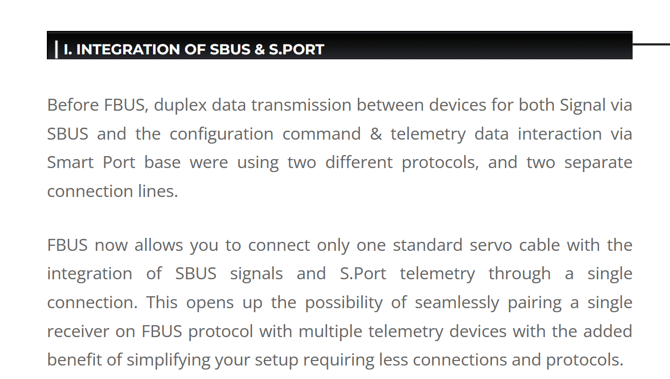

Or use FBus Protocol, hardcopy from FrSky-Page: https://www.frsky-rc.com/fbus/
