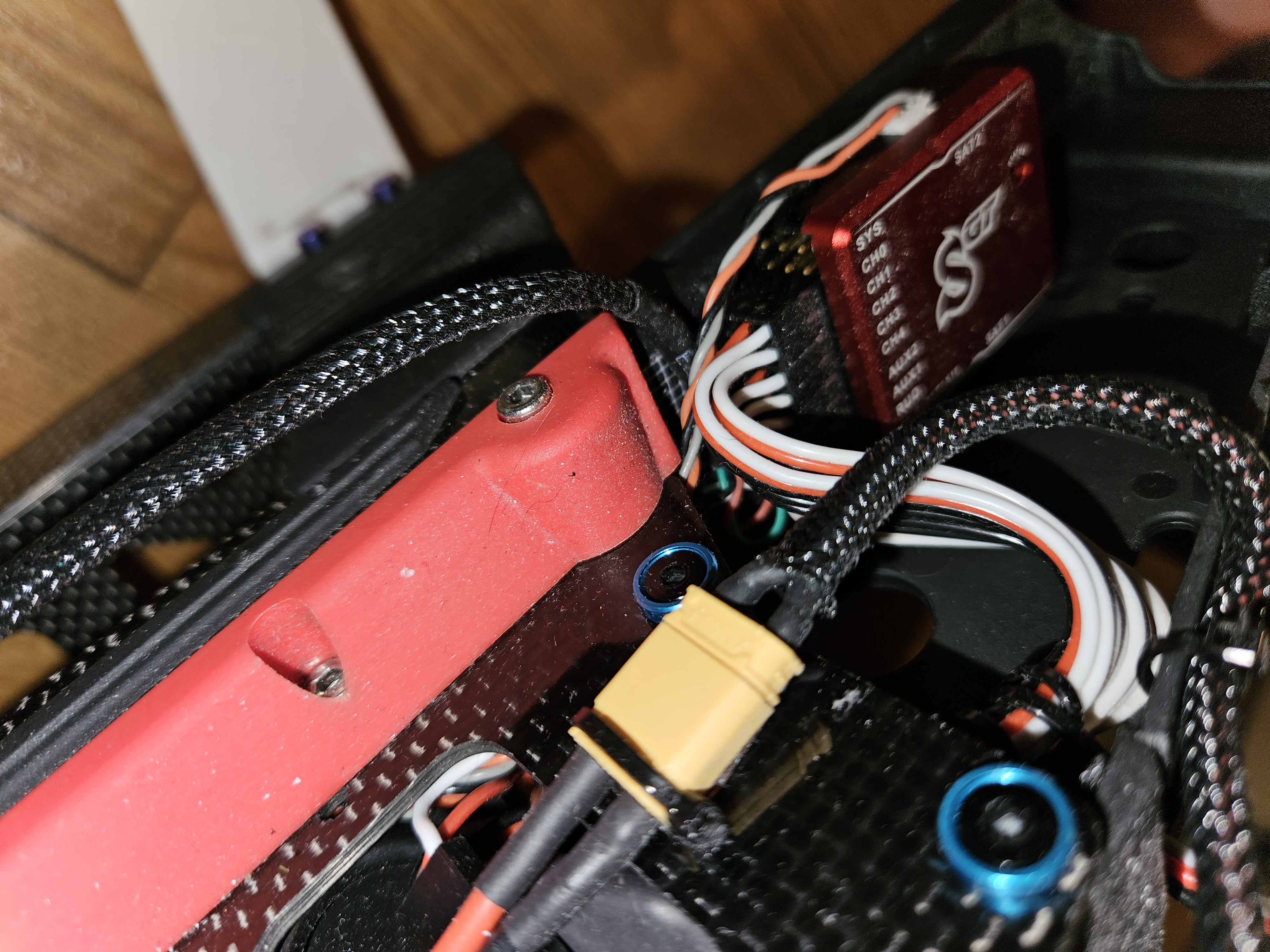

I'll attach a photo but it doesn't show much because the wiring is all tucked between the frame plates. If you'd like I can disassemble and give more detailed wiring info/photos. What are we looking for specifically?
