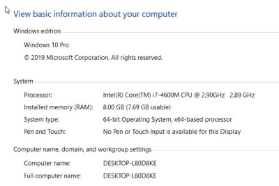

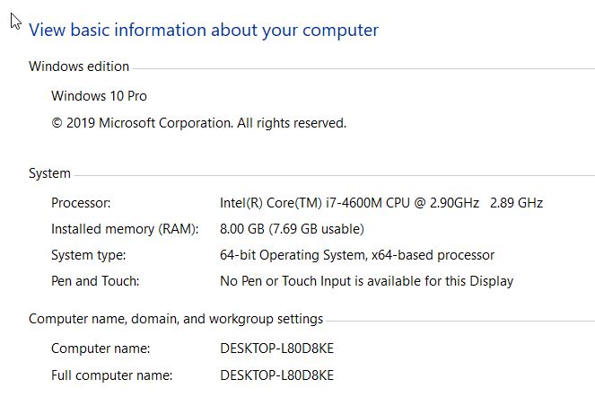

I am having difficulty running the Spirit Main Setup program on my new notebook.
Notebook brand = Lenovo T540p
OS = Windows 10 Pro 64Bit
Spirit SW= V 3.7.1 (the latest)
Spirit HW = Spirit Pro and Spirit GT + Wifi +GeoLink

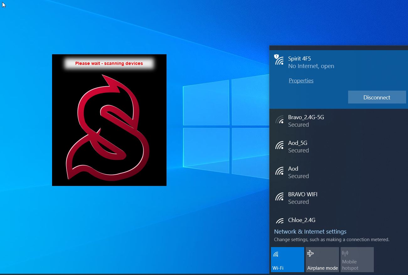

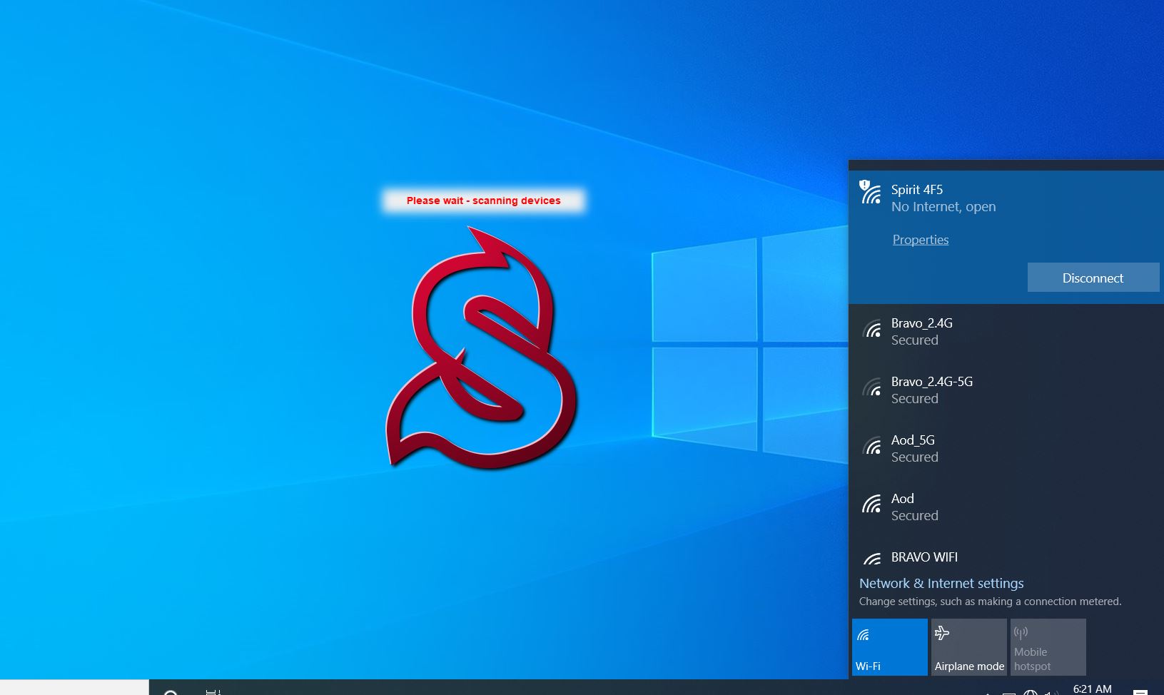

I manage to load the program successfully but it does not run. It keep searching for hardware and hang when I put the mouse on it.

So I format the OS and reload the Windows again and try the NB only with Spirit program. The results are the same. All driver are properly loaded.
I tried the compatible mode, disable program DIP settings and nothing works.
Program does not run with connected via USB, via WiFi or as Demo mode. I tried after turning of Bluetooth, no response. The same windows, Spirit version and spirit hardware works flawlessly on my HP notebooks. There seems to be some setting preventing spirit running in the Lenovo. Please help me to fix this problem.

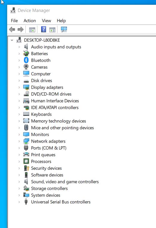

Thank you very much for the replies. See below a photo of my device manager:
The spirit USB was not plugged in when I took the photo. Spirit USB was assigned to COM4. I'll share another with Spirit USB in.

Posts: 12932
Thank you! Can you please open COM & LPT section and see what is there?
Very likely COM port 1 - 3 are the issue.
If you will just reassign COM port of the current devices to a higher than of the Spirit USB interface, it will work.
But disabling the problematic COM ports will resolve it permanently.

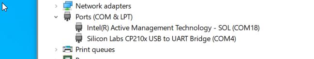

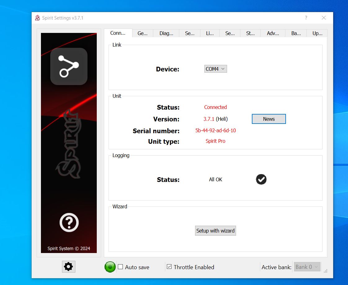

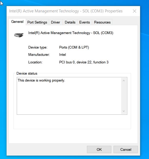

I am glad to inform you that I found the issue. Its the program call Intel Active Management Technology program. It shows COM port 3 in device manager and Spirit use COM port4. However, AMT seems to preventing spirit program running. Quick disabling it resolved the problem
I have read that uninstalling AMT could cause some hidden issues. So, I just change the port of AMT to port 18 and everything become fine.
