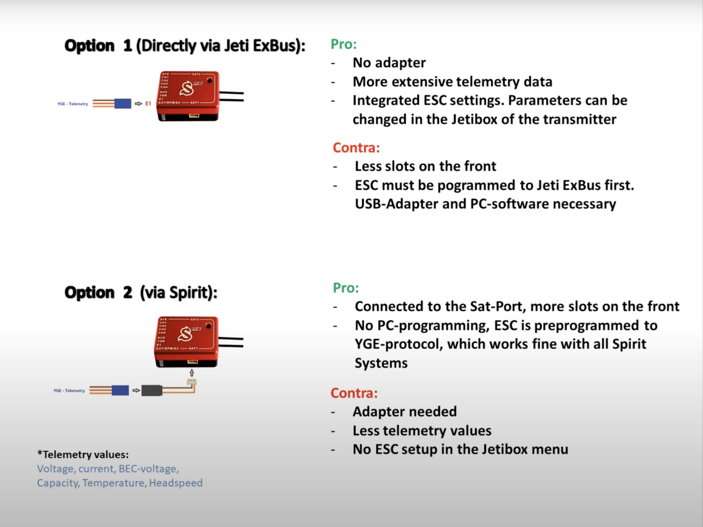

When using a YGE ESC with a Spirit W1 flight controller and WAVE radio, should the YGE ESC telemetry wire be connected to the T1 port or one of the 2 SAT ports?

Wave has no relation to EX BUS since it is JETI protocol, so EX BUS wiring can be excluded.
Please proceed according official Spirit guide:
https://manual.spirit-system.com/index. ... _Telemetry
