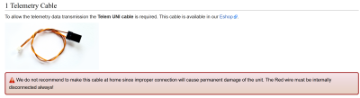

For telemetry, the Telem UNI cable connects the satellite port of the Spirit1 to the programming port of the Hobbywing. In the Settings app, “Hobbywing V4” is set for telemetry and the battery voltage, temperature and RPM are displayed in the telemetry window of the Settings app.

According to the instructions, the FrSky integration cable should be split for the telemetry transmission, with the red (middle) cable being plugged into AIL of the ELE/PIT/AIL port. When I do this, the Hobbywing is no longer armed.

is there possibly an issue with the FrSky Integration cable?
In the manual the cable is shown with a red servo plastic, mine has a black one, must be an older version.
Could there be any change in the electronics that causes problems in my case?
The modification of my FrSky integration cable with the red cable to PIT already means that the ESC is not armed.
With the unmodified integration cable all function except telemetry are given.

Alexander you have to modify the Integration cable like in the manual showed, with this modified cable and FrSky receiver it works for me -
Matthias
ajadda
Posts: 148
Hi Matthias,
yes I know, but as I wrote, if I do so, the ESC is will not arm.
That is why I was asking, if there maybe could be a problem with my integration cable.
Are there probably older and newer versions, as mine has a black servo plastic, the one in the manual has a red one.
