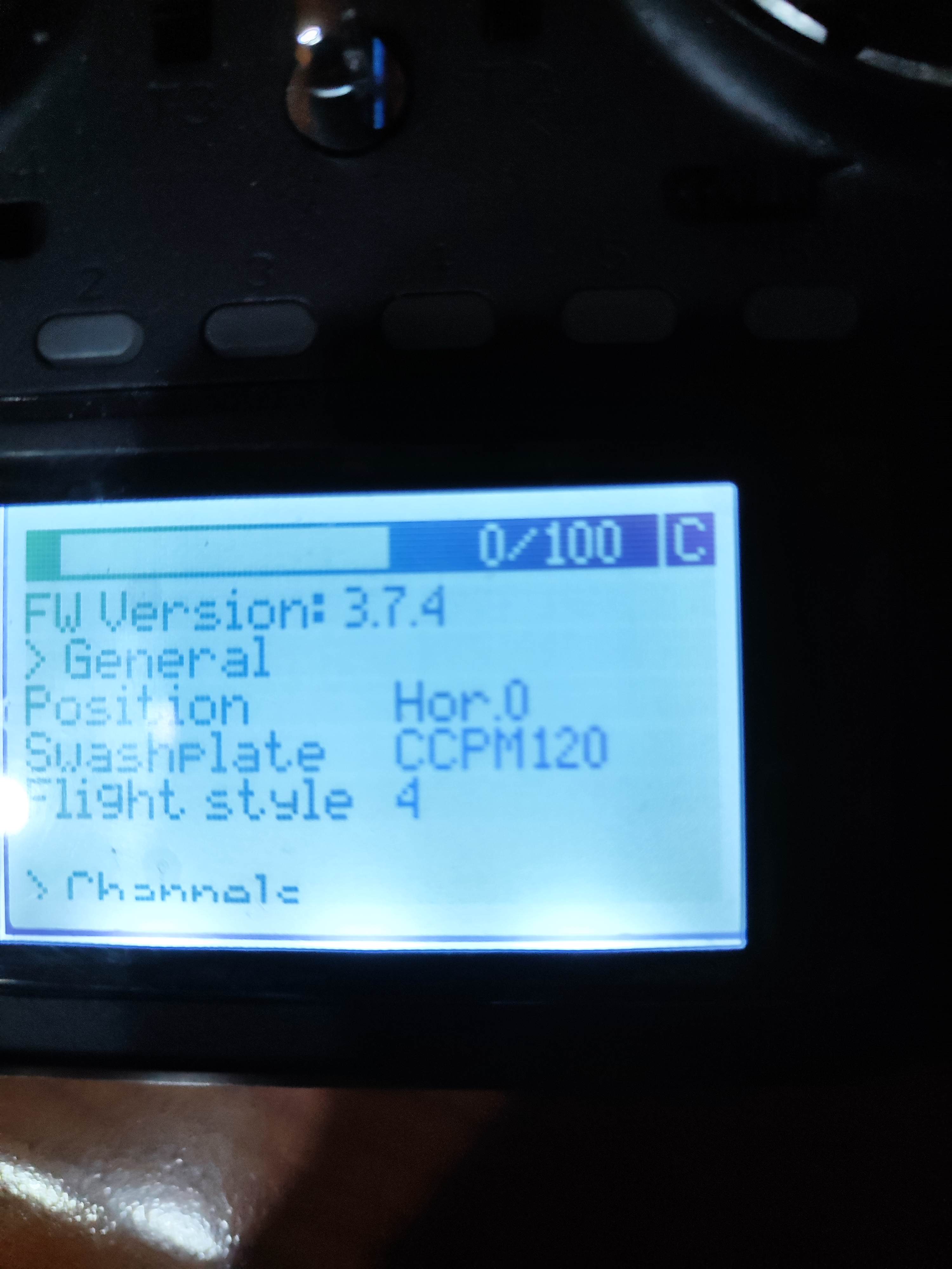

Good morning everyone,
Last night I installed the NOMAD in the radio and successfully connected the receiver to the radio.
I started the Spirit2 with the USB cable to:
1) Update the firmware according to the manual. OK.
2) Select the CRSF/ELRS receiver protocol as per the manual. OK.
3) Swap the channels as indicated in the manual (throttle - elevator). OK
Result:
- The elevator/throttle controls didn't work
- The aileron/tail/pitch controls were fine, although the movement was jerky and non-linear.
I launched LUA TBS, which displayed:
- NOMAD
- SPIRIT
- DBR4
I launched "NOMAD" and after loading, the transmitter parameters were visible.
I launched "DBR4" and after loading, the transmitter parameters were visible.
I launched "Spirit FBL" and during loading (the parameters started to appear, but it stopped at a certain point, displaying an error).
Correction dated 12/07/25
WRONG: I noticed that in the DBR4 setup, the following protocols can be selected: CRSF, SBUS, PPM, PWM.
WRONG: Question: If I change the protocol from CRSF to SBUS, I imagine I'll then have to change the connection on the Spirit2 according to the Spirit2 manual, right?
The problem is during the loading of the FC variables which creates the error (see photo)

nmsantarelli wrote:Good morning everyone,
Result:
- NOMAD
- SPIRIT
- DBR4

Can this error be resolved? If so, how?

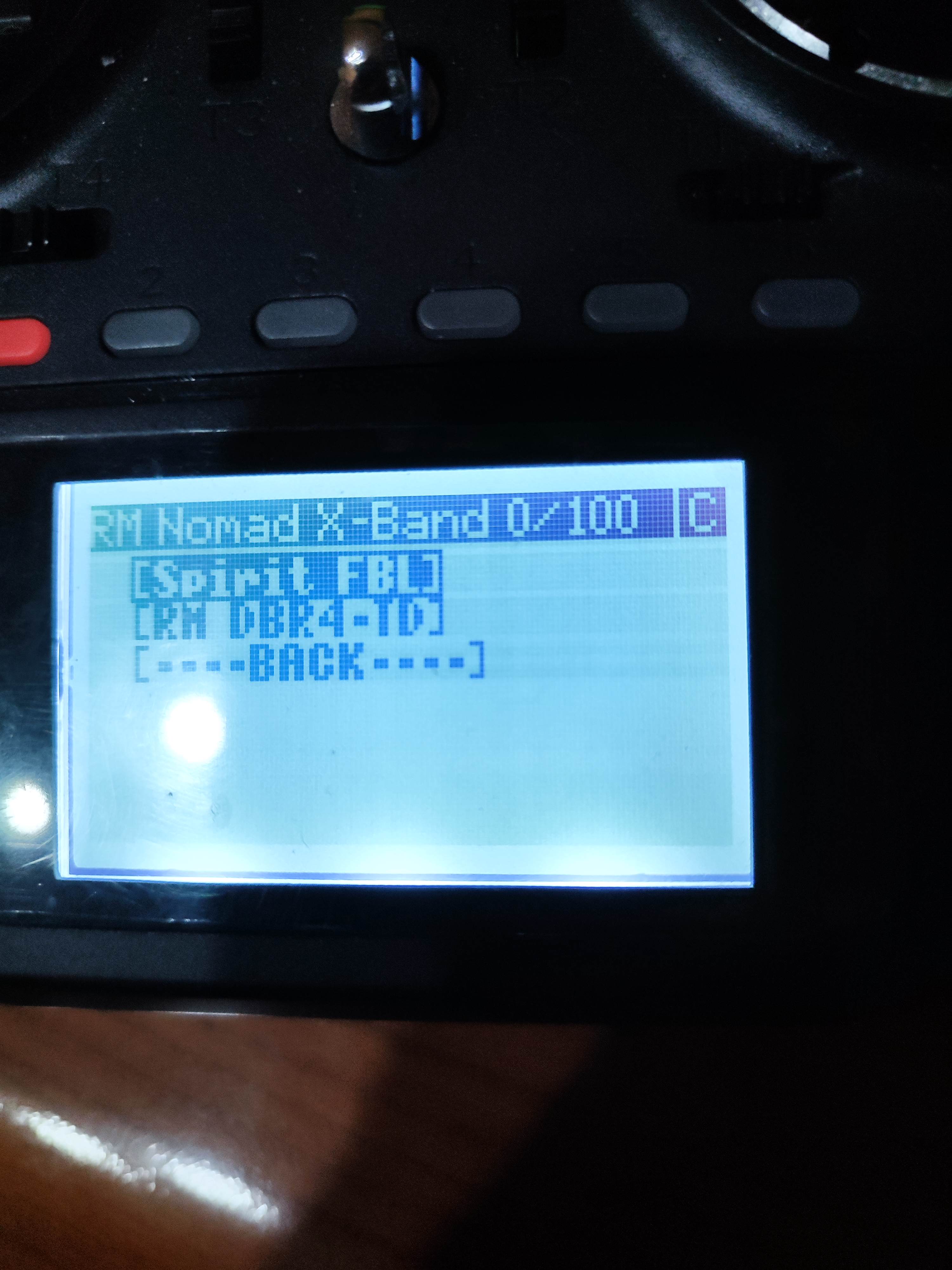

Hello everyone on the forum,
I just wanted to say that the above problem was caused by the elrsV3.lua script (which wasn't working). I solved it with the latest release found at "https://github.com/ExpressLRS/ExpressLRS/issues/1864" where I downloaded version 3.5.6 and everything works.
