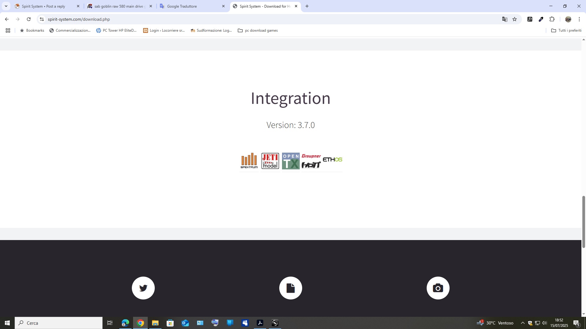

and what did you download from the site?nmsantarelli wrote:My radio (Radiomaster Boxer) is edgeTX and all the setup parameters appear but not the diagnostics.franz88 wrote:you have edge tx?
it s possible integration with edge tx ?
in the site there is integration:
spektrum
jeti model
open tx
graupner hot
ethos
I'm attaching a photo for you
