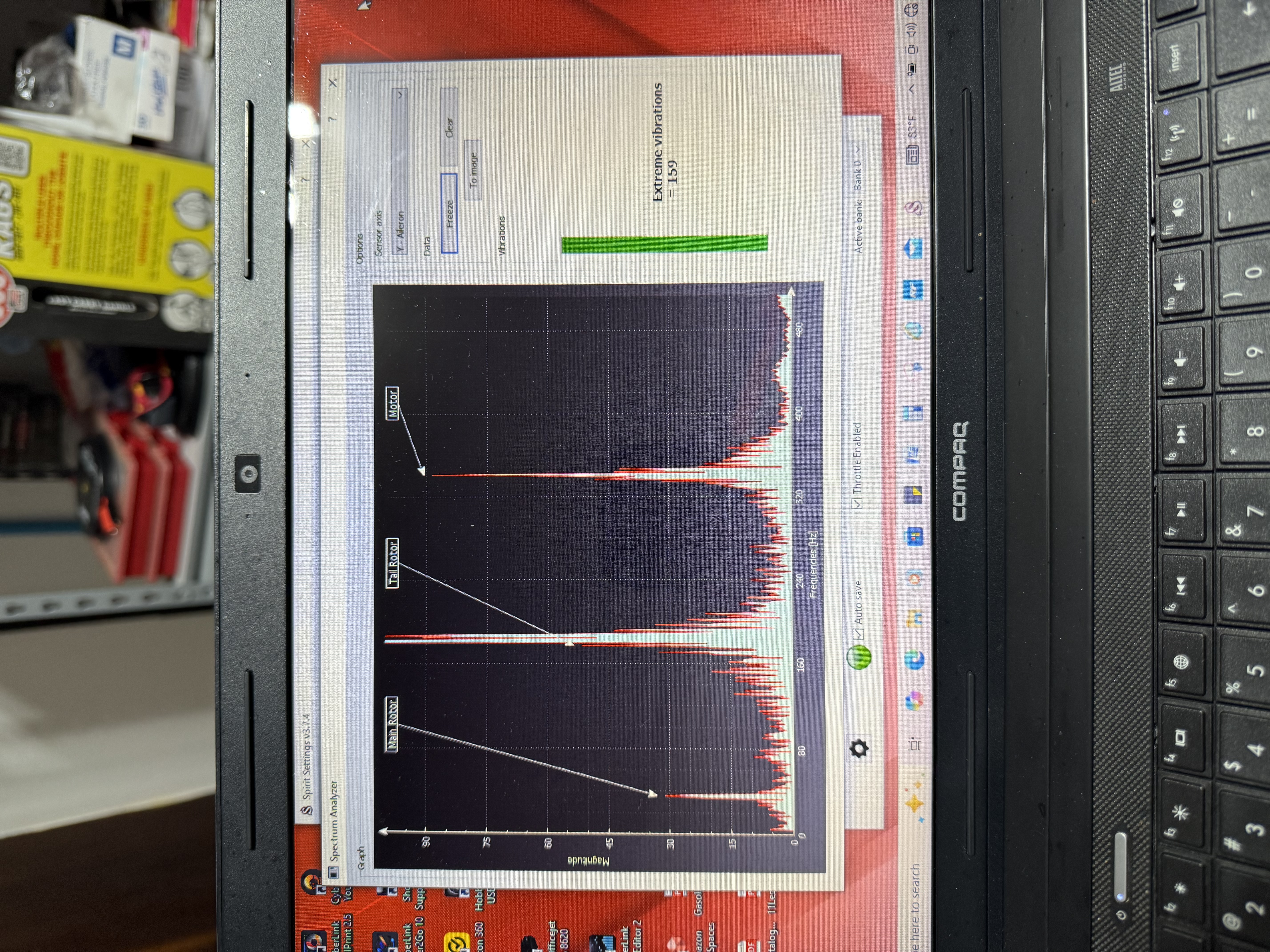

I’m getting extreme vibrations from a new TB70 being bench tested.
The model is working as expected and assembled as per manufacturer instructions.
This model is belt driven.
The motor/main drive pulleys and belt, and the tail pulleys and belt, mechanisms, generate inherent vibrations.
Please advise.

If using Sensor Motion Filter to Low Latency this could increase vibrations in the analysis.
You can repeat with Standard option (after save and reboot). This should lower the readings.
davehour
Posts: 145
The Sensor Motion Filter is set to Standard.
Posts: 13039
Ah, then it seems the vibrations are really present, mainly at the tail rotor. How the unit is mounted?

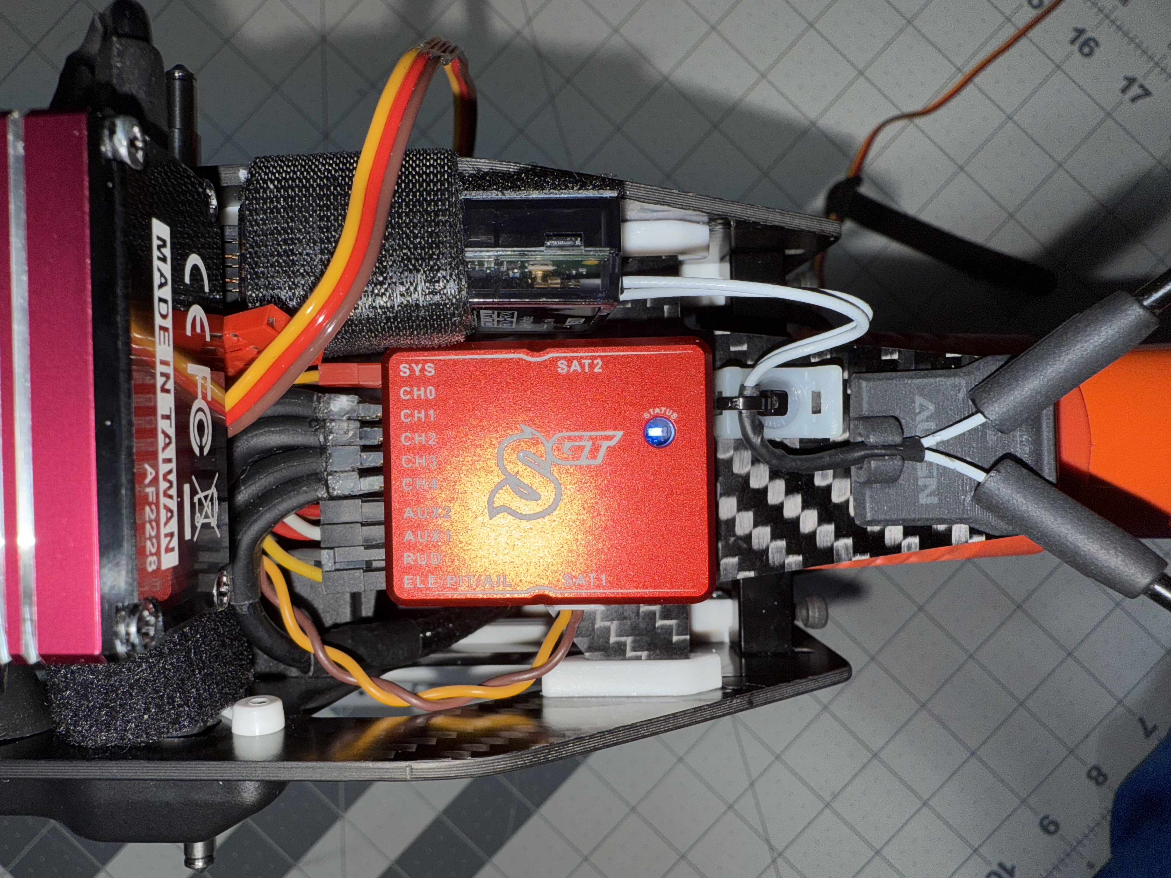

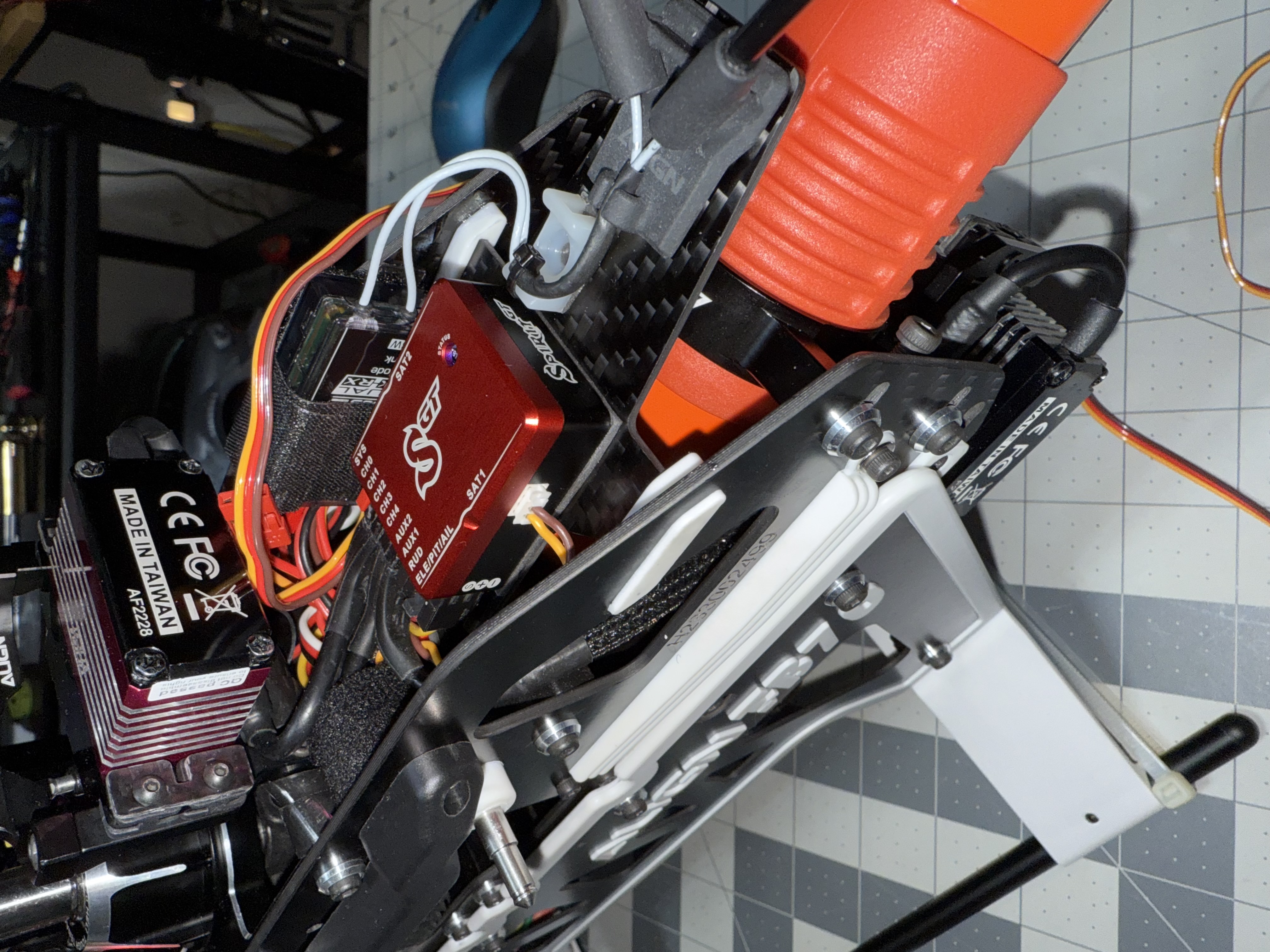

Pictures attached.
The Rx wrap isn’t compressed to the Spirit GT.
In a tail belt drive, one can feel the ratcheting of the mechanism when the main rotor is rotated.

The velcro stuff around the receiver looks like it's touching the unit. This way it will transfer vibrations from the frame and the mounting tape can't do its job. Spirit unit should be free.
davehour
Posts: 145
Both, the Spirit GT and the Rx, move freely without interfering with each other.
It looks like the Velcro is touching the Spirit GT but it isn’t. The top layer of the Velcro just wrap the top of the Rx and ends there.
Nevertheless, I’ll remove it and retest.
