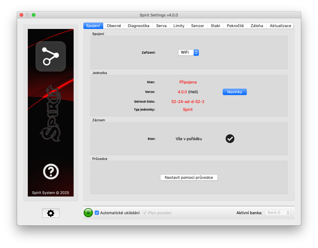

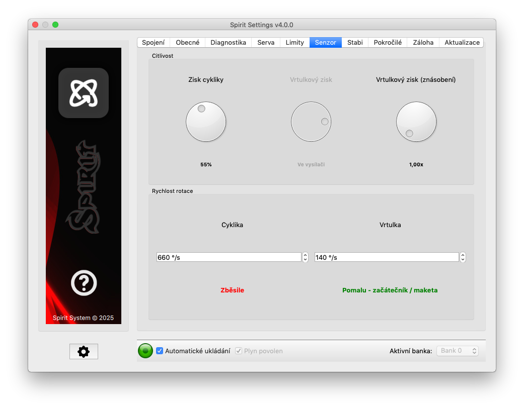

See my attachments - running WiFi-Link on Mac.

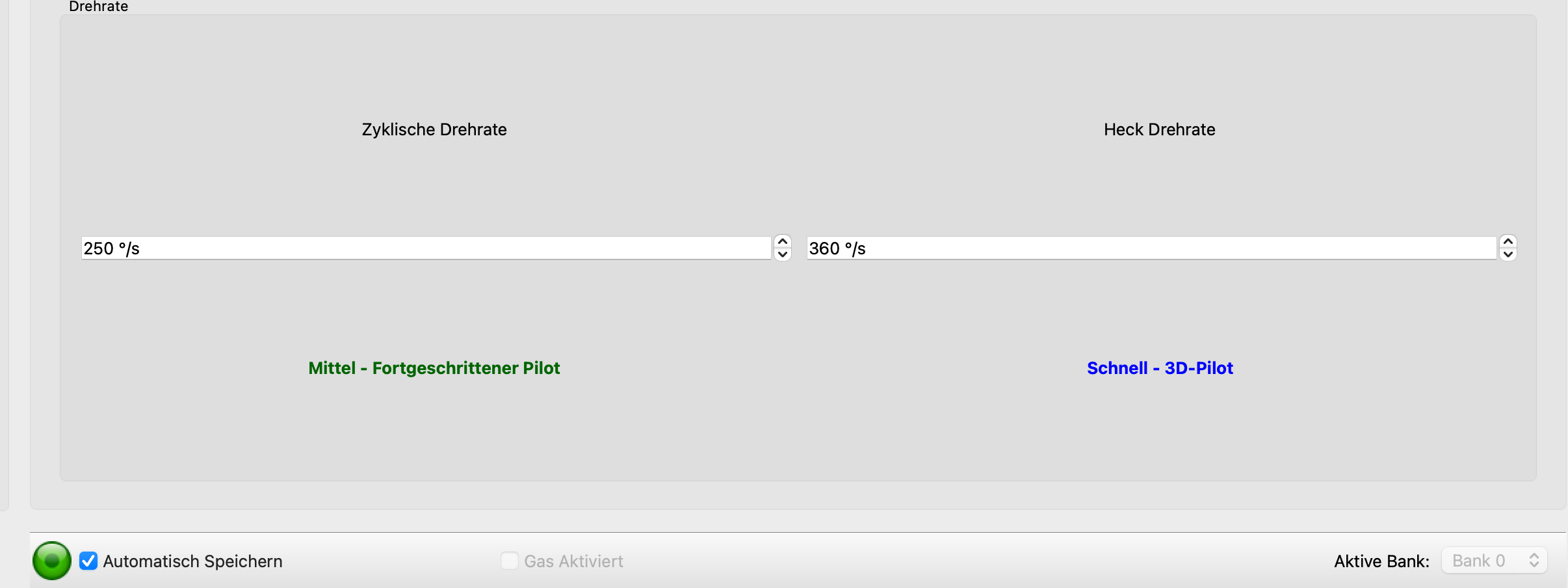

yes it is the r3 version, here is a screenshot (Demo Mode):
