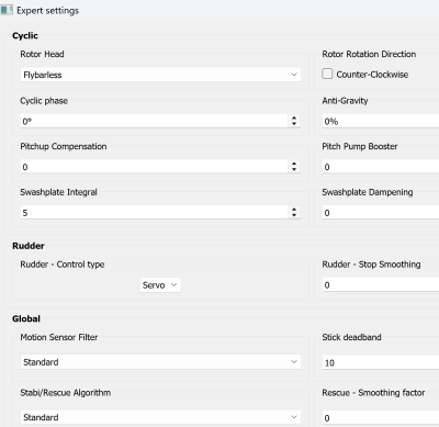

maybe it is a theme of the deadband ? The deadband in the standard setting is at 10 -
You can change it to 2 and verify if that has an impact -
I don't know if the stickdeadband is only for the two sticks or if that applies also on sliders, potis etc. ...

The stick deadband was set to 2.
I have updated to Ethos 1.6.3 and the rx to 3.0.1, unfortunately the issue remains.
For now ill just remove/ not use ch12 in my setup, then all is fine and smooth until i find a way to isolate the issue.
