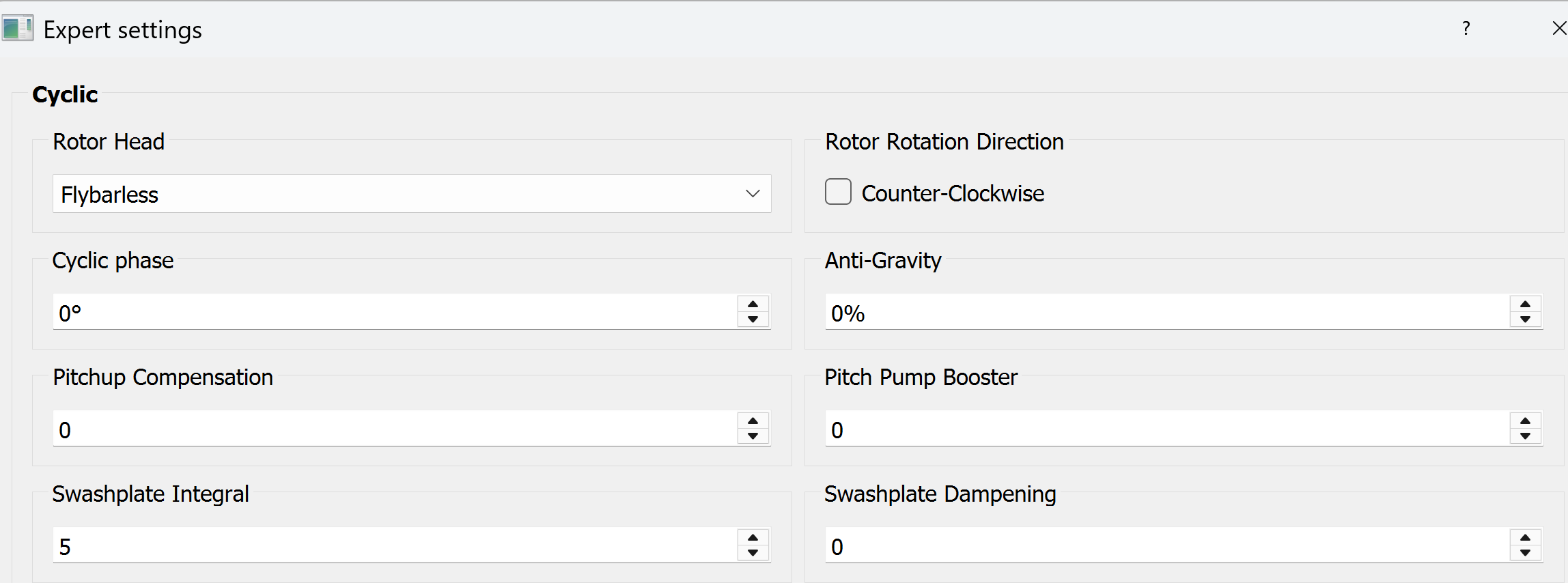

I would assume to reduce the headgain or to set the new position headdamping a little bit up -
Or swashplate Integral is to high this must be tested...
I think the heli is not dolpheneing if so then elevator filter...
